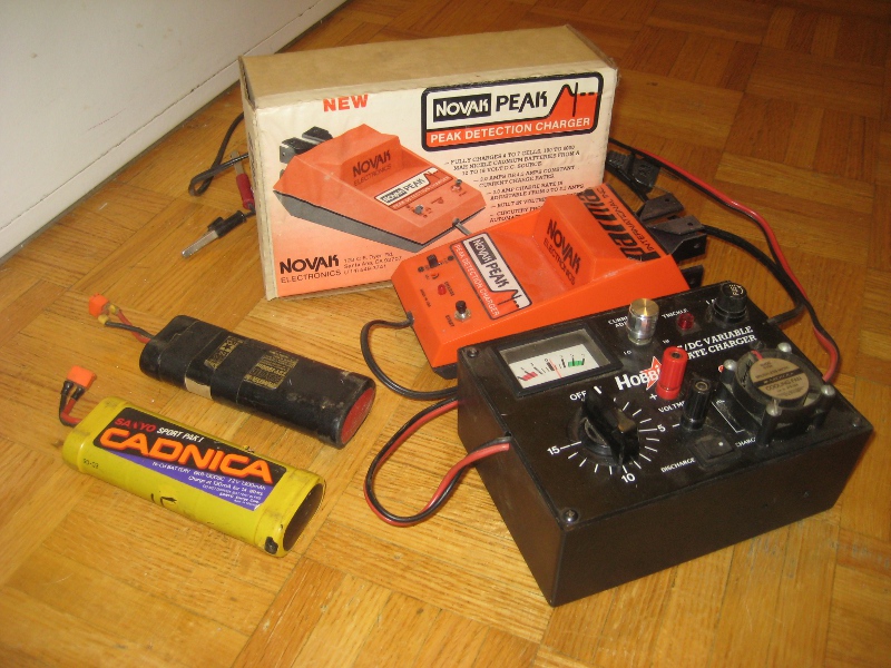

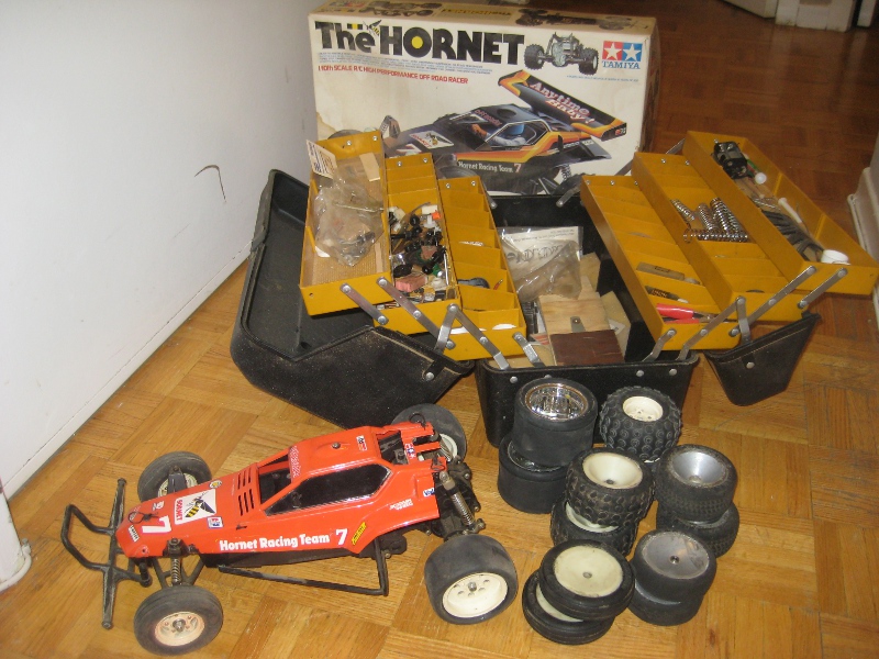

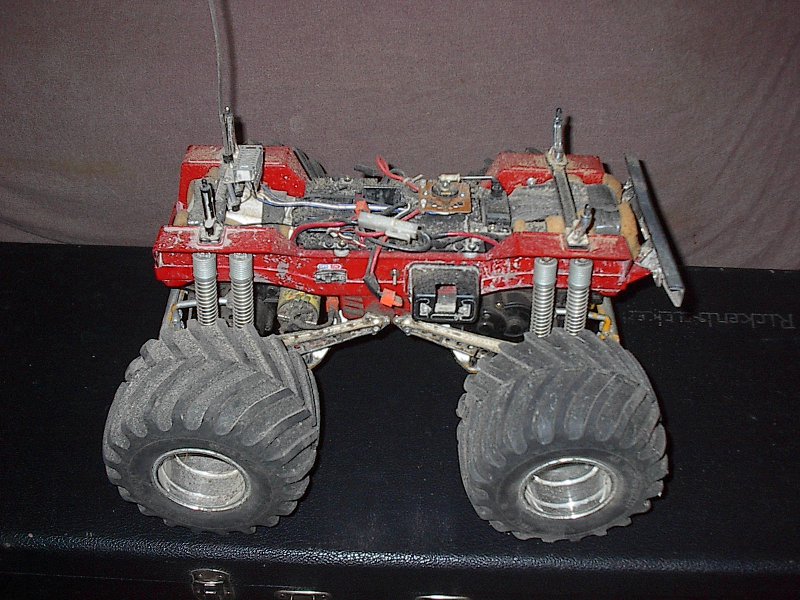

A guy was cleaning out his garage, and had posted some pics of old RC cars he owned on Kijiji. There were some odds-and-ends, like old chargers and batteries , the traditional tackle box full of parts, a way-less-then-RTR Hornet , a Bullhead/Clod... and this... a car that he couldn't remember the model of:

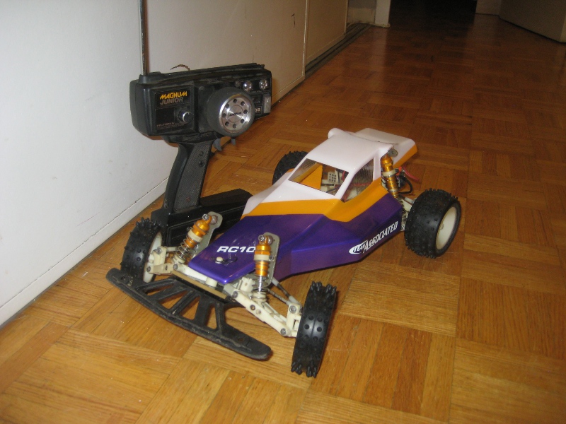

The local hobby shop had an Associated Viper body in stock, so with a couple cans of paint I made this:
(the previous body I think came from the Hornet, based on where the mount holes were drilled). I didn't realize the body didn't come with a wing, but it looks like I can buy one from this forum. I wasn't willing to pay for vintage decals, so I bought a set for the TC4 to steal the Associated logos and trim out the "RC10" bits :)
I don't know what the proper way is to trim out around the rear shocks... but whatever it is... I didn't do it. I had to nibble away at it about a dozen times to get it to fit right :?
Also... the tacklebox-full-of-parts had a bumper in it.. that only fit the RC10... but the way the mount holes were countersunk it looked like you mounted it upside down? (front end kicks up, bumper kicks down = flat bumper?). Not sure if that's what I'm supposed to do, but it works...

Nice clean up 8)
Bumper looks like an Andy's or RPM Oval bumper, check out the body post holes for a "Modified" non open-wheel body.
Your new rear tires are somewhat hard to find vintage Losi X Pattern's.
Have fun.

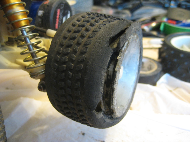

Thanks RC10resto: I think you're right about the tires. The rear sidewalls say "Team Losi Made in USA Cushion Carcass 2.00 x 1.60", and the fronts just say: "RP-927". Speaking of tires....
The new radio gear hasn't come in yet, but the old one works... so I stuck in the newer electrics I had and took to the parking lot. I didn't want to burn off the spiked tires since I knew I would stay on pavement, so I stuck on the old worn street tires (Imex <something>(road?) Dawgs). They felt a little bit brittle when I squeezed them but I thought they would be fine.
I was wrong.
Both rears started to crack, the the left side split right along the sidewall, almost all the way around. They were mounted on some beat-up rims that were also painted silver, so I threw all 4 in the trash (the fronts were almost bald anyways). On went the last set of worn tires: they say "Racing Super Gripper" on the side: stockers?

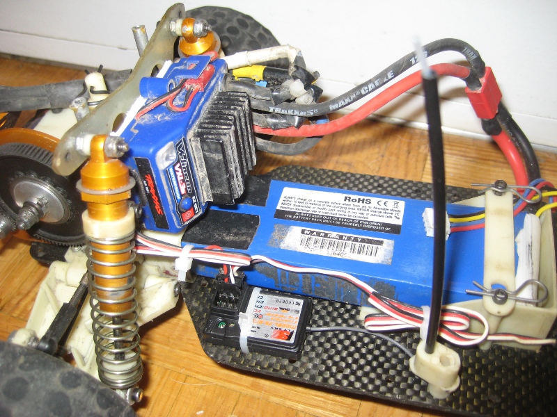

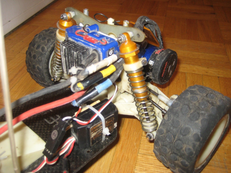

And for the electrics, I have a new receiver coming for it for a FlySky FS-GT3B (going to use it for the Clod too, so the 3rd channel can handle 4WS). I took out the old ESC and brushed motor, and stuck in the guts from my Stampede VXL: a used Velineon system:
I know that setup maybe isn't ideal for the car, but something strange happened that made me think I may have to look at the gearbox... or maybe it's just the 20 year old tires. I only ran it once with the original ESC and motor, and other than perhaps being a bit slower than I was expecting (and the steering wasn't great) it tracked straight. With the Velineon I could only get up to about 50% throttle before the car would veer quite dramatically to one side: the same side every time.
It looked and sounded like one rear tire was breaking loose: but why would that happen when travelling straight: isn't the diff primarily balancing things out on corners? And if it was the diff... wouldn't I lose traction on alternating sides? When I back the motor away to disengage the pinion the gears and wheels spin freely... maybe it's just the old tires (they feel pretty firm/waxy) and one tire is worse than the other?

Oh, if it's tires, based on this and this I've ordered a set of Proline Dirt Hawgs from the LHS and JC Racing rims from Ebay. I saw all the posts about how to retrofit modern B2/B3/B4 parts... but just wanted something simple, since I won't be racing.
But... if I break some parts... I may be forced down the B* path, if OEM replacements are too costly. I guess we'll see...

The GT3B actually just came, and I mounted it up. It's so small!
About 1/4 the size of the old Futaba receiver, and there's only about 8" of antenna?!? Seems to work though: range is farther than I can see to drive it. Now I'm just waiting on the new tires and rims, wing, and gear cover, and I should be done. I hope the new tires work much better, because right now these old ones just spin and spin on pavement, even going very easy on the throttle :(
