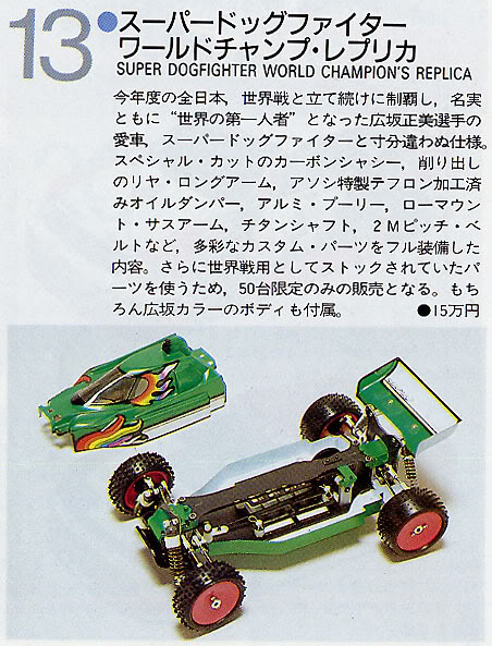

For your replica, you need the TH30 rims, same 870 offset, but 2.2 or 30 series. After the works 91 they have a deeper offset for the works 93, WCS 93, 94 dogfighter and 95 WCS. After the works 93 (tail end) they added the eight reinforcing ribs. Same offset though-

Hey Reggie, are you talking about my '89 Masami Yok Worlds car? I already have the rims for that one - not sure what offset but they are pink, 2.2 inch, and look to have the same offset as in the RCCA pics. I'm actually looking for info on rims for two other Yok's I'm working on. These 2.2" rims for my Masami car have less offset than the stock rims from an 870.... are you saying that the TH30 rims have this same deep offset yet they are 2.2"?? Are these ever available or are they like the elusive pink rims?Charlie don't surf wrote:For your replica, you need the TH30 rims, same 870 offset, but 2.2 or 30 series.
I'm assuming that Masami used the shallow offset on his '89 YZ10 because he was using rear arms in the front and longer custom rear arms so I figured he used the shallow offset rims to keep his car within legal race width. The replica pic of the Masami car also seems to have the very shallow offset rims. Maybe these TH30 rims are the ones I want for my other Yoks - 2.2" but wide offset??

The car you have are the TH30 rims, 870 offset- 2.2" used in 89' with the TR-31 rear tires ( also used in 2wd winning car ) The WCS in your image uses the Works 91 deep offset rim 2 hole variation ( i think there was a later 4 hole variation )
