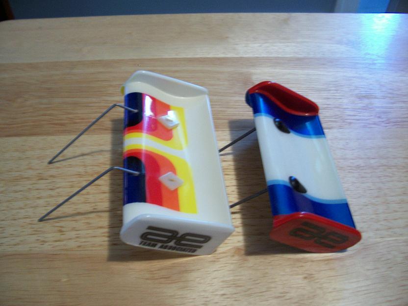

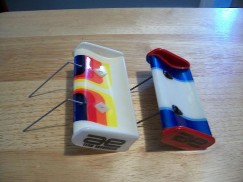

The 6187 wing is a six inch wing. But here are two four inch ones I have mounted . I just washed them with soap and water . I painted them on the bottom side using faskolor and a airbrush . Dried each coat with a heat gun. For the tight spots I just poured the paint in and dumped it out and did the heat gun thing to dry. Sounds crude but it worked. One wing has the wire passing threw before the dip and one shows wire bent before the dip.

Thanks guys. I have hacked up the 6187 I did for my son's RC10 pretty badly (didn't measure the spacing on the wing buttons properly - oh well, he didn't care) but for my shelfer I wanted to make sure I got it right.
