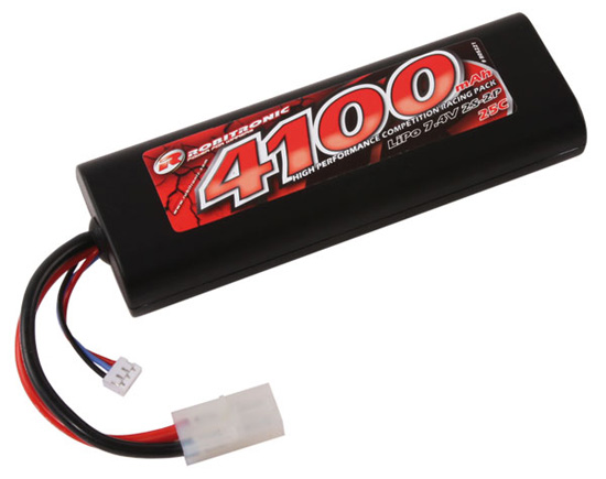

thats where stick pack lipo's come in
http://www.robitronic.com/files/produktbilder/Robitronic/Akkus/R05221/Mit%20Kabel/r05221_550.jpg
couple of those, and you wont have to carve up your chassis on any old cars :)

Great...after I go ahead and buy a few of these at a great price. LOL
http://www.hobbyking.com/hobbyking/store/uh_viewItem.asp?idProduct=17240
Unless anyone else has other ideas, I guess I'll have to fabricate my own battery holders out of aluminum or plastic with squared-off edges...
EDIT: Speaking of which, I could find no pricing info on that linked Robitronic battery anywhere, and various searches of Robitronic on eBay turned up nothing.
I did turn up this equivalent Protek battery, but it's more than double the cost at almost $50 :shock:
http://www.skmotion.net/PROTEK-LIPO-74V-4000MAH-STICK-PACK-BATTERY-2S-25C-SPORT-RACE-TRAXXAS-CONNECTOR_p_3483.html
