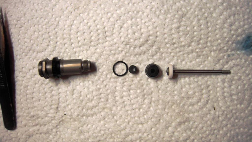

Reggie, these are the V2 shocks I got from you. I like visualizing crap, so here is a photo just so I can get this right. The large O-ring goes over the threads for the shock cap, the smaller one goes over the bottom thread for the bottom cap, and the black plastic bushing goes in the bottom. I got the shaft and piston now, do I put any green slime or anything on that bushing? Why don't these things come with instructions

Re: Associated V2 shocks.
Hey, free parts don't come with instructions
The large o-ring goes over the cap threads, then the spacer and 2 O-rings bottom loaded and screw the bottom cap on ( finger tight only ) yes, green slime the rings
But you just gave me them, so I guess they do come for free
And, just to clarify, since the number of o rings didn't add up...when you say 2 o-rings in the bottom, you mean to red o-rings. Just saying because the only o-rings included were the 4 black ones for the top and bottom caps
Now any other simpleton like myself can figure it out.
