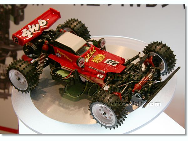

Here is the Hot Shot I am considering. Its $130 US shipped to me, seems like a good deal, what do you guys think?

Re: Got a line on a used original Hot Shot
Nope I wouldn't be paying that.
That's one messed up shot to me. Looks like someone decided to mount the motor to the rear instead of mid mount. Steering is??? Does it run?? A large spur gear. How does that work with the internal Spur??
It's different that's for sure.
Any pics with the shell off.???
It's a Tam Tech-Gear Hotshot with a few hopups.RC104ever wrote:Here is the Hot Shot I am considering. Its $130 US shipped to me, seems like a good deal, what do you guys think?
http://www.tamiyausa.com/product/item.php?product-id=56711
These are only 1/16th scale not 1/10th. They are nothing like the 1/10th scale one in chassis setup and have shared parts with the other Tam Tech-Gear cars.
They can be quite fun to run around inside the house.
Words can be decievingMad Racer wrote:Nope I wouldn't be paying that.
But the headline was correct - It´s an original hotshot
Gone fishing
Pretty sure that's a tam tech Hot Shot: one sold here a while ago for less: http://www.google.co.uk/imgres?q=tamtech+hotshot&um=1&hl=en&client=firefox-a&hs=fQx&sa=N&rls=org.mozilla:en-GB:official&tbm=isch&tbnid=nzBuP5wgb9wD8M:&imgrefurl=http://www.rctech.net/forum/r-c-items-sale-trade/330597-tamiya-tamtech-gear-hotshot.html&docid=GDkWcgORyEfEnM&imgurl=http://img.photobucket.com/albums/v187/savage03/Tamtech%252520Hotshot/a2c933a4.jpg&w=976&h=697&ei=4Hp0T6f6B4rW0QXg2NEW&zoom=1&iact=hc&vpx=608&vpy=168&dur=519&hovh=184&hovw=254&tx=130&ty=102&sig=113681036184861566129&page=1&tbnh=152&tbnw=196&start=0&ndsp=20&ved=1t:429,r:2,s:0&biw=1280&bih=847DennisM wrote:Words can be decievingMad Racer wrote:Nope I wouldn't be paying that.
Any pics with the shell off.???![]()
You can get the re-re kit for about $200 & it will have all the 'fixes' that you'd want to do to an original. I don't think it comes with bearings, but they are standard Tamiya 5x11 and 5x8 (bext to buy them in larger lots-- I have done a couple 50pc orders as we have Hornet, Lunchbox, Frog, Hotshot, etc, but you can get in different/lesser quantities). Better from new re-re for a runner: center shaft/cups, one-piece dogbones, hatched chassis.
I have a couple runners and drawers full of parts, as I got my original kit for Christmas 1985. I spent tons of money getting one running a few years back, and then they re-released it... so my paypal account hemorraging was slowed.
As others have said, that is a TamTech and a pretty well used one at that. I wouldn't even consider 1/2 that price personally. Stay on the lookout!
Gee Sorry.
I thought it was a butchered up Hot Shot.
Thank you Brad for setting me straight. You are a wealth of information on Tamiya's as always.
Great to see you here.
Once again sorry I really thought it was a "normal Hot Shot" LOL.
Still wouldn't pay that price.
So is the only difference between this and an original the size? Wasn't the original a 1/10th scale?
Hotshot is 1/10 scale and only shares a similar chassis with the Supershot and Hotshot II. I believe future buggys reused the drivetrain and similar (but not exact) arms, etc like the Boomerang, Super Sabre and BigWig. They then completely changed up their 4wd with the Thundershot, Thunder Dragon, etc.
The TamTech line is 1/16 scale and based on the GB03 chassis and I don't think they share a single part in common.
