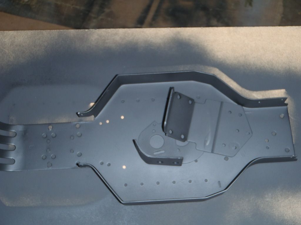

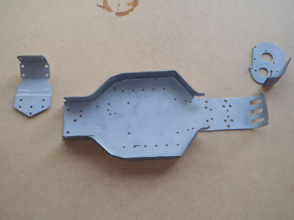

This is the chassi after sandblasting it (its awesom to have built a sandblaster)
This the the chassi after paint (I used Rust-Oleum engine paint Simi Gloss black)

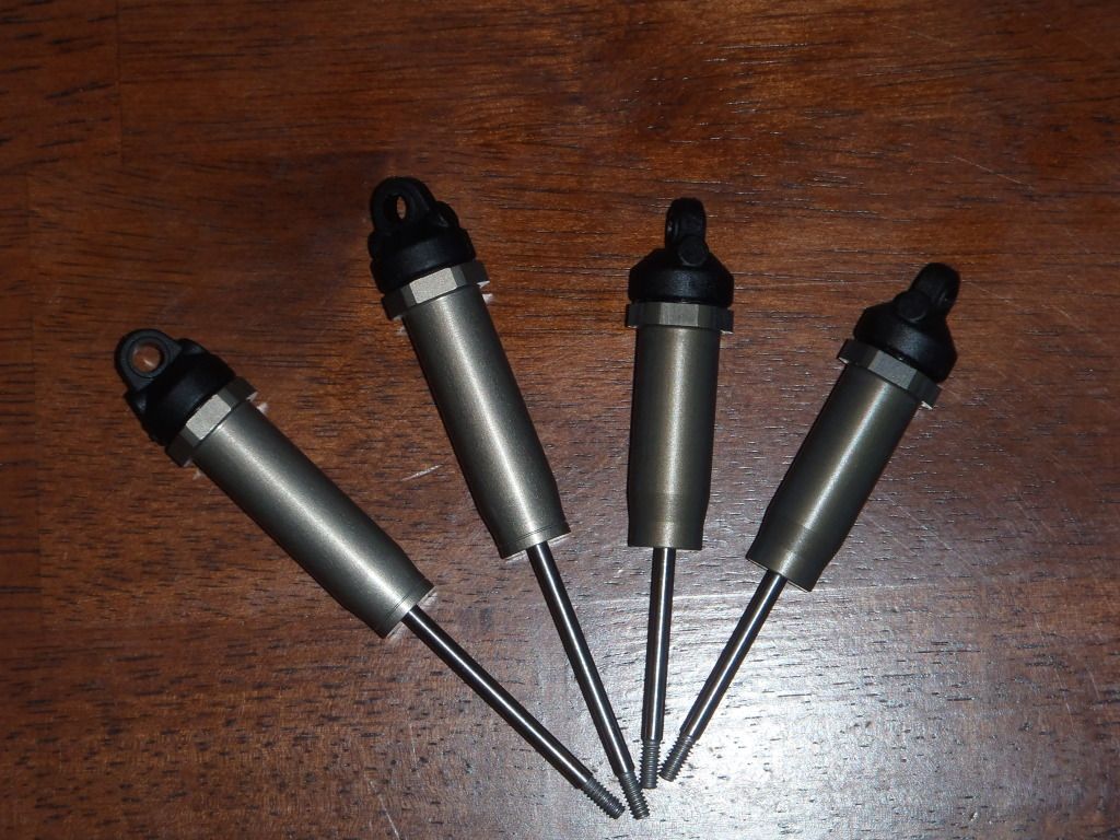

Here are the shocks brand new from Team A and they ar the Pro shocks AKA racing Shocks, I wonder why they dont come in gold anymore. I have a set of the Gold ones but after years of use and abuse they are looking shabby

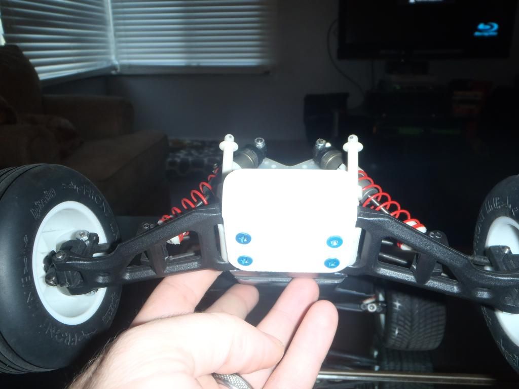

I have tons more to do on this thing here are a list of things that are sitting right next to it waiting to be put on.
-RPM mini Front bumper
-RPM Front and Rear arms(black)
-RPM Ball Cups
-Team A Blue Hardware
-Team A new Knuckels Ect

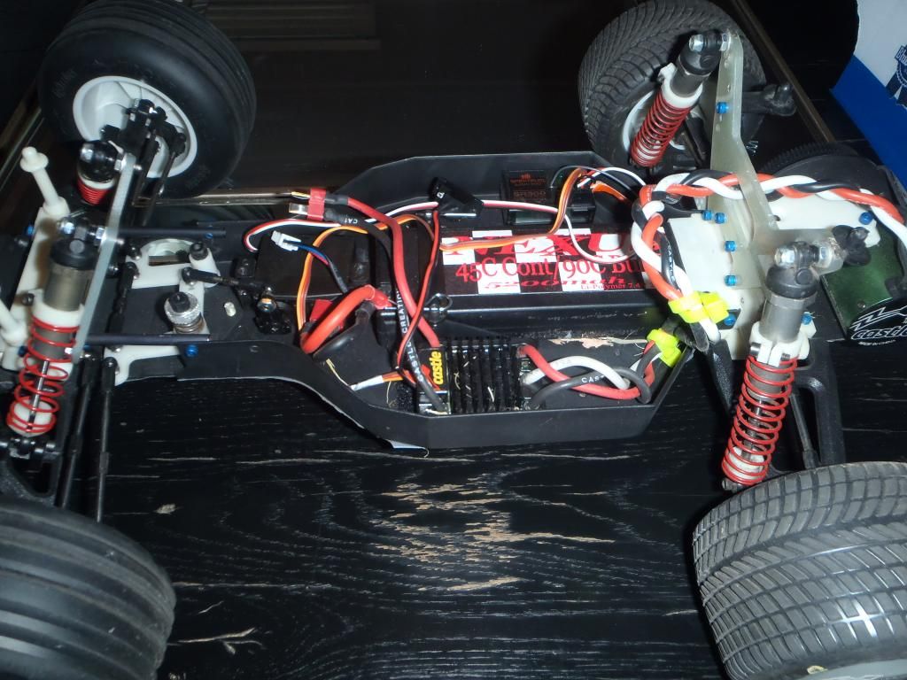

OK so after a whole year of laying around I officially am finishing this project up. I will be posting pictures I know I know this is an old thread and another rebuild thread at that. But its exciting to be able to run this thing again.
So here are the parts that I updated and kept.

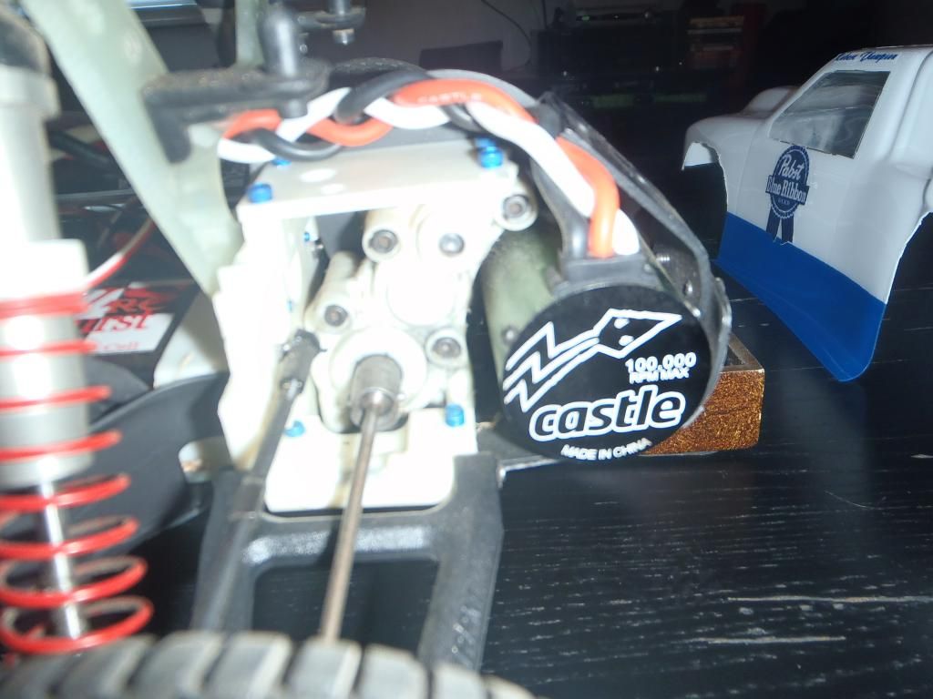

Motor:
Castle Creation 5700kv sidewinder and speed controller.
Receiver and Transmitter:
spectrum 2.4 nothing special there.
Batt:
Nexus 2c 5200mah
Chassis:
RPM black arms front and rear
T-2 Titanium Lunsford arms.
RPM Front white Bumper
RPM Ball Cups
Rebuilt shocks
new wheels and tires.
Pro-line and j concept.
I am going to run it tonight waiting on the battery to charge.
Pictures will be up I promise I put away the original parts if I ever wanna make this thing a shelf queen but I just wanna run this thing for a while and have fun.

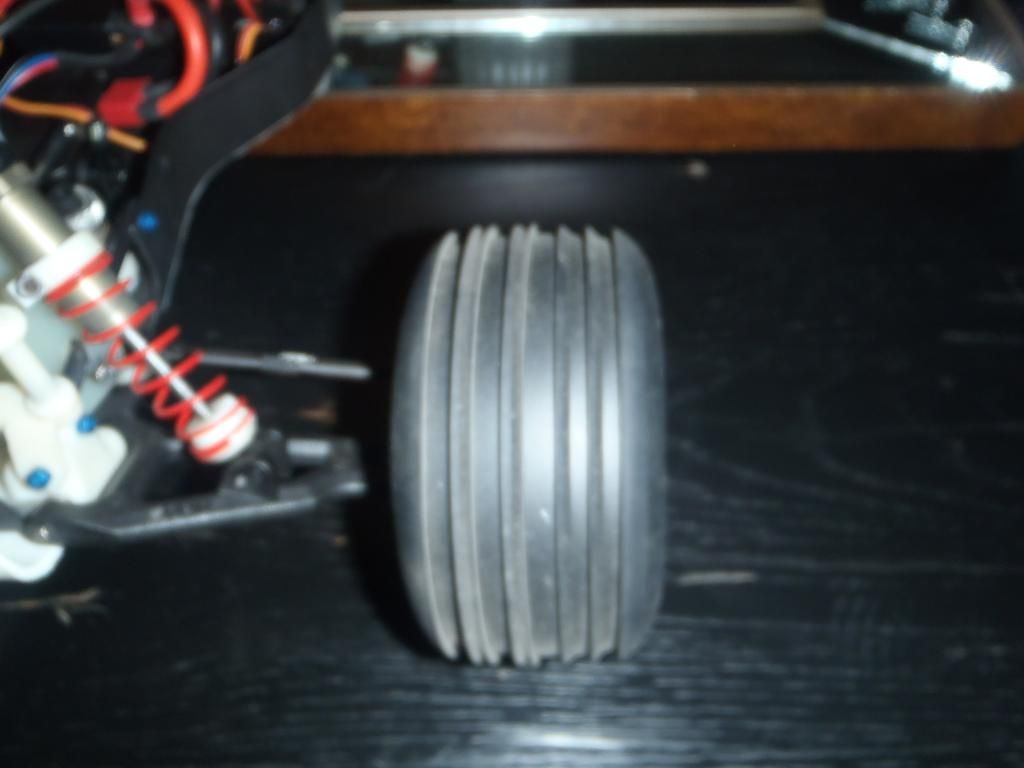

I got done driving this thing. Holy cow it is way over kill but not unmanageable. So far today I have ruined 4 rear tires and rims so Im looking for different tire options that will hold up. any suggestions would be awesome I still have the 1/4 axels . I here that there is a HPI conversion kit would this be beneficial.
teman
Posts: 894
Joined: Sun May 01, 2011 5:57 pm
Location: Upstate NY
Been thanked: 6 times
Re: New old guy here RC10T2 rebuild
Post by teman »
I'd suggest switching to CVD's & 3/16 axels so you have better rim and tire options. Tire wise if running on the street get street tires like road rages or an on-road/off-road like say the Gladiators. The gladiators are a bit tall, but I like them on front and rear (I'm running them on my T3)
-Kevin
tommygun89hb
Posts: 20
Joined: Fri Jun 15, 2012 6:33 pm
Post by tommygun89hb »
Ok so I got T-3 rear axels and they work good I am running Pro-line road hawks in the rear and HPI Front lines in the front. I got a T2 body today also so im looking for simple paint schemes examples and suggestions that are really easy to paint I am not the best painter so post some pictures.

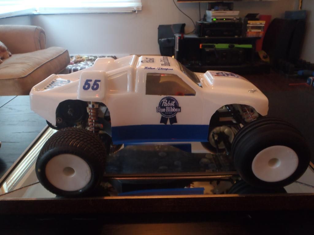

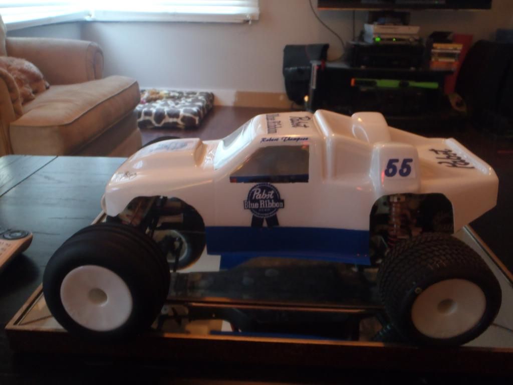

I think i'm going to do a pabst blue ribbon paint job anyone ever do that on here
tommygun89hb
Posts: 20

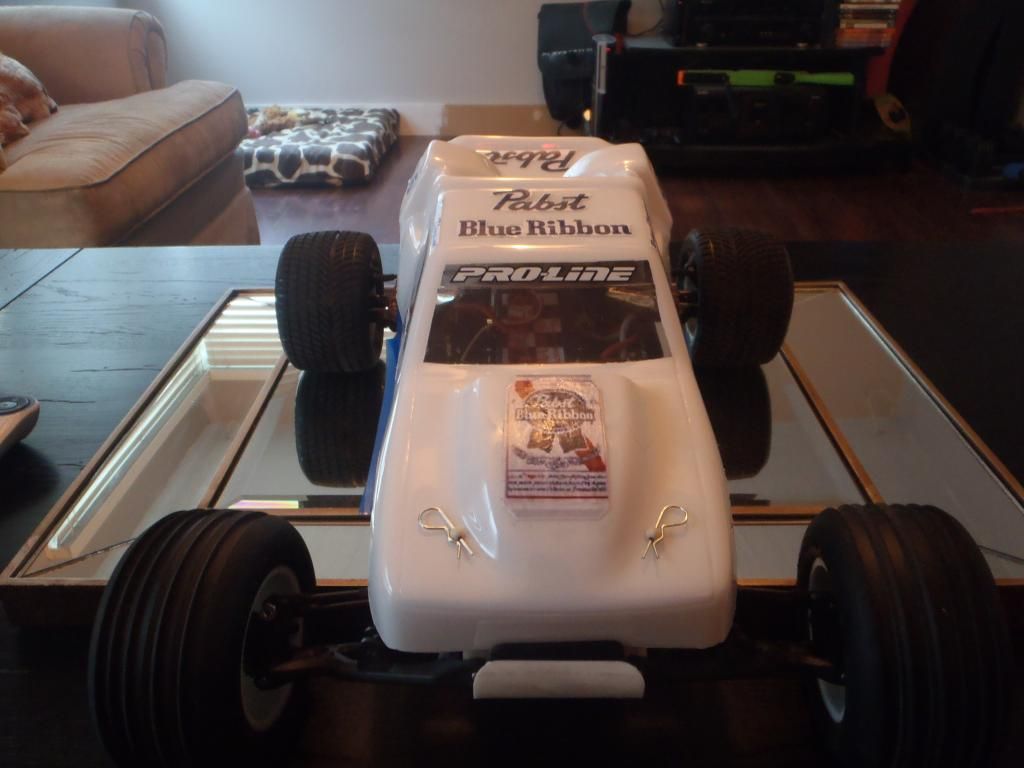

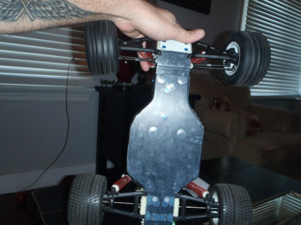

ok as promised here are the long awaited not so long awaited finished pictures. If there are any question I will be happy to answer or if you want to see better pics of anything you see.
tommygun89hb
Posts: 20

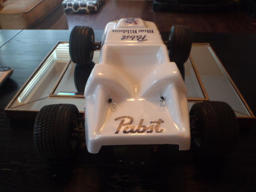

here are some more pictures
