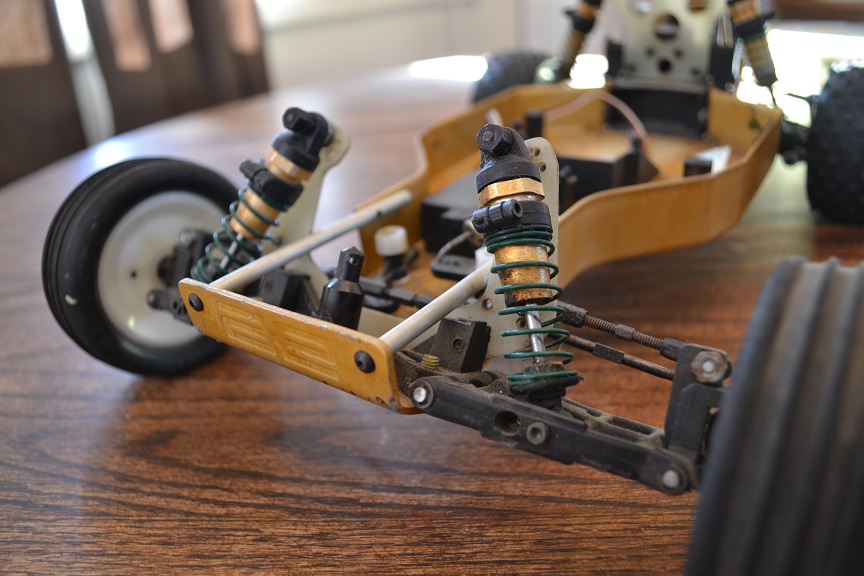

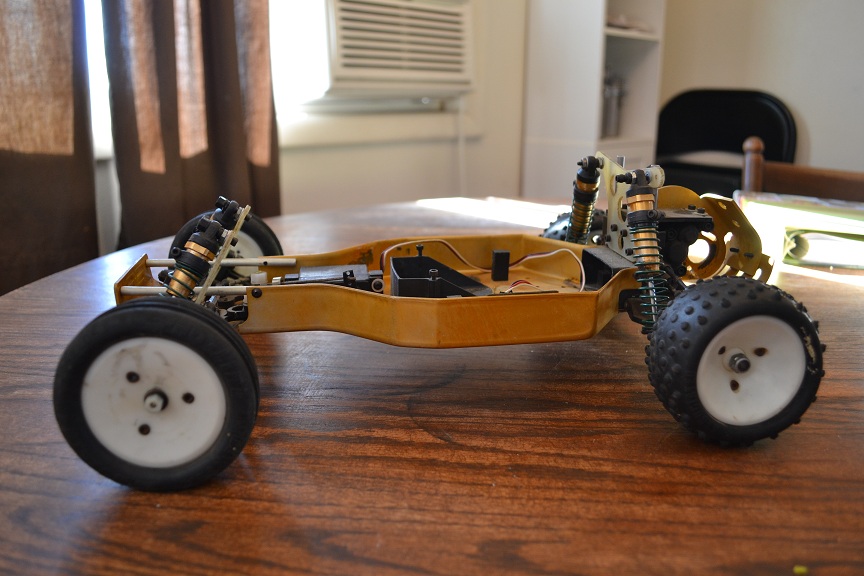

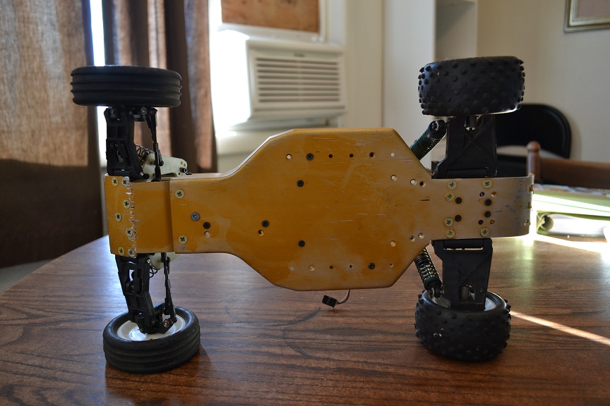

So I finally had time after work last night to tear into her, and overall she's pretty solid. A little bit of rust, and one slightly bent rear turnbuckle was all that I could really find that needs work. The stealth tranny looks pretty solid, I just need to get some bearings and put it all back together. The chassis itself is a little bit discolored (lighter in some areas), does anyone know what causes this? Anything I can do to make it look a little better?

have it reanodized. only way to fix that.

Yeah, that's what I thought. If this was shelfer I would, but since she's just gonna be a runner I'll live with it.

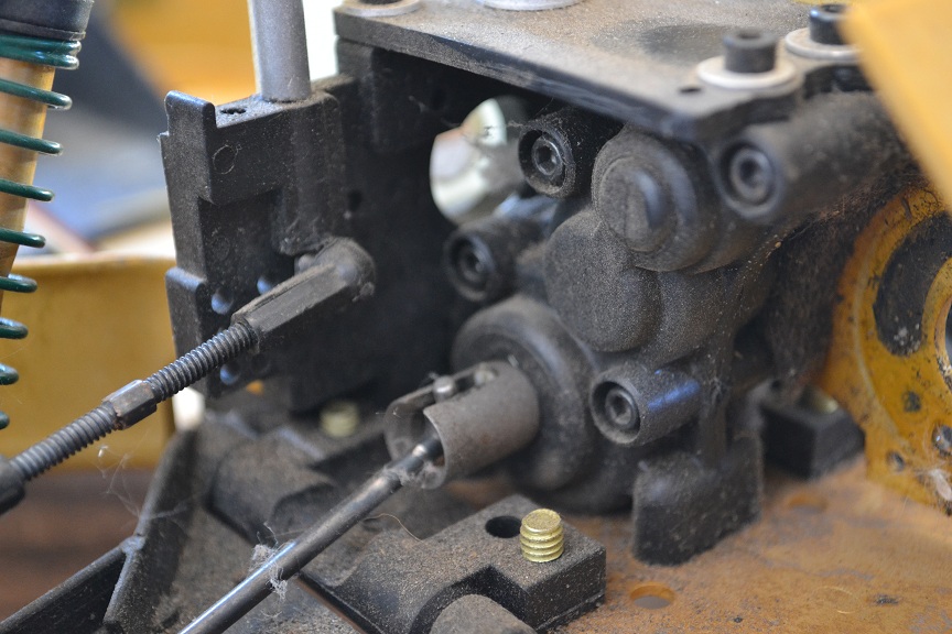

Well, I 'm almost done tearing this thing down. It looks like this buggy has been ran in the sand as things were really gritty. Luckily the transmission looks pretty good. Shocks had no oil in them. The right side rear hub did have bearings in it but they were completely shot. Made an order to Avid for a complete set of bearings. Still need to pick up an antenna mount and a battery hold down bar.

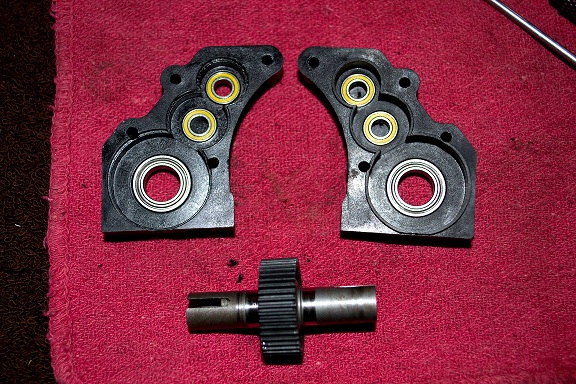

After about five months I finally got some time to get back to my RC10. We moved and I just haven't had the time, but the other night I rounded up my parts and began the rebuild. Got the front end (minus shocks) done and then moved onto the Stealth tranny. Tore it apart, cleaned it up, rebuilt the diff, and the most important part, added brand new ball bearings from Avid.

Get a B4 top shaft and slipper parts for it...You won't regret it...It will eliminate that roll pin and be alot easier to rebuild...
