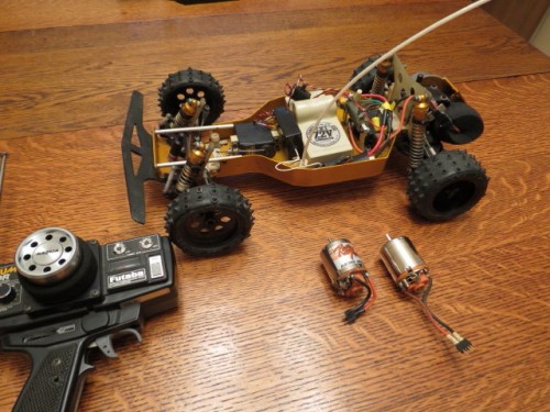

I know you guys get variations of this question often. (I've read many many threads). But often the post gets into way more $ and complication than I'm looking for.
I've pulled my original stock RC10 out, interested again cause the neighborhood kids are running electric traxxas around and my kids are starting to get interested in rc.
Would like to let my kids try out my old RC10.
Currently completely stock. No ESC, running orig motor, and NiCd 1200mAh 7.2V hump batteries protech super charger 702 and Futaba radio.
Batteries are toast, and I though before I buy more I need help.
Would like to accomplish the following with minimal cost...
1) Would like car to be able to go in reverse (think this would require an ESC, but dont know what kind)
2) Going ESC might allow me to set batteries in long way and not across (as set up now)...giving me more battery options instead of just hump. Is this something I could get new for the Futaba...or it it ebay for this?
3) Can I use this old charger with NiMh or do I need a new one?
4) Finally if I get a couple of NiMh batteries, a charger and an ESC that gives me reverse, are my kids still gonna get smoked by the RTR traxxas stuff the neighborhood kids are running?
Like the nostalgia of it (my Dad and I built it long ago)....but in reality probably looking at more $ than just buying something RTR for the kids.
If I'm educated on it though, I though I might be able to buy stuff for the RC10 which would be compatible with a RTR Team Associated or Traxxas vehicle for the kids I see around for a couple of hundred.
Thanks in advance.

Re: vintage stock RC10
Hey guys,
Thanks for the quick response.
So if I don't want to get smoked by a Christmas RTR for my kids, what are the essentials I have to do to my old RC10?
ESC, batteries, charger...if so what do you recommend, and what can my stock engine / trans handle.
Are ESC's radio specific? Do I have to buy a vintage one?
BTW...Would like to have reverse. Neighborhood kids thought it funny when running my toasted niCad left me against the curb (stuck).
Thanks.
Thanks for the advice.
If I want to leave the trans and stock motor alone, could someone tell me what ESC (with reverse) will work (if I go with NiMh).
I know I will have to cut a futaba G? plug and attach it to any new ESC I get.
Second way would be leave trans and stock motor alone find ESC with Lipo capabilities and go with Lipo batteries.
But would this toast my original RC10 stock team associated motor?
If someone could point me in the right direction on the web, I'd appreciate it.
Again, just want to run this RC10 again...with the idea that down the road I might like to keep batteries / charger in common with an RTR for my kids.
If you are running the original STOCK motor, then an ESC like this should meet your requirements..
http://www3.towerhobbies.com/cgi-bin/wti0001p?&I=LXCHSZ&P=ML
I would suggest buying a new charger as well as NiMh batteries, something designed to charge NiMh batteries..
Im sure yoy can use the search function on Towers site to see what is available..
