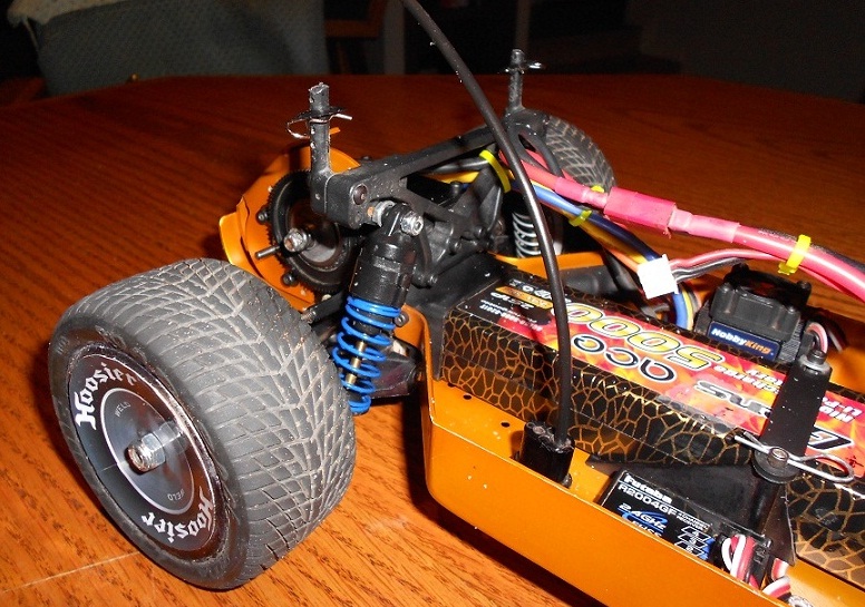

I'm running a DS rear tower on my oval car, with TC4 shocks. I had to go with the DS bulkhead because the arms were interfering with the inner ball link anchor holes. Also, using the TC shocks made it sit too low, so I went with .80" shafts in the rear.
I'm not sure how it'll work for an open class, as I'm limited to 13.5 and a muscle car body.

LTO, it should be quite fun as there is everything from a B2 to the newest CW cars. From what I've gathered though, a lot of rough driving is going on so hopefully I can bring back some old driving skills... as the oval was the only game in town when I was a kid running RC. :mrgreen:
Thanks for the pic Russ! I was thinking it would be close and thought about using this: http://rccarbonworks.com/store/index.php?route=product/product&product_id=95

That short tower should be fine. Your bulkhead looks more like the DS type. I started with the one from the 6 gear, and it would hit the ribs on the rear arms (wider mounting holes for the ball links)...but I'm also running the "short" wheelbase mounting holes on the inner arm mounts.
