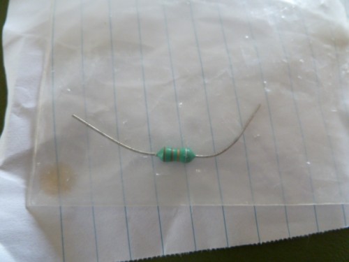

What is the 'choke'? It looks like a resistor on the scan...
jwscab
Posts: 6584
Location: Chalfont, PA
Been thanked: 507 times
Re: Why don't my KO servos work?
Post by jwscab »
it's an inductor. probably like a 1 microHenry (uH)

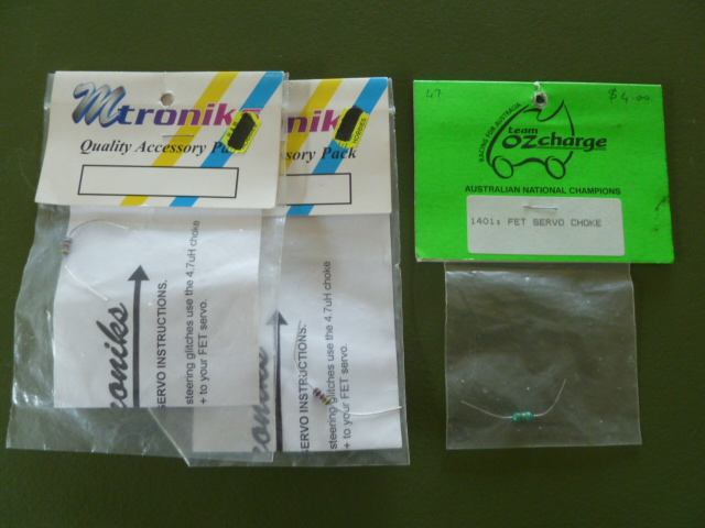

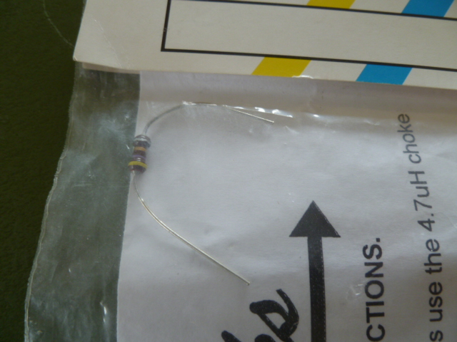

Posts: 3696
Has thanked: 1749 times
Been thanked: 1149 times
Here's a couple of FET servo chokes in their packs, by both Mtronics and Team OzCharge. The Mtronics ones are 4.7uH (micro Henry), but the OZcharge one is unmarked, so will have to get the books out and confirm by the coloured bands.
Hope this helps....
jwscab
Posts: 6584
Post by jwscab »
if I am seeing the colors right it's brown brown orange is 1.1uH (silver band is tolerance)
