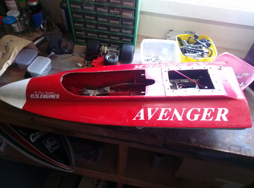

Re: re-finishing old fiberglass boat hulls?
hows the miss unlimited? thats also on my list, and probably one of the next i'll get
in australia in the 80's / early 90's all the racing was Multiboat...submersed drive, so most of my boats are. it wasnt until i started reading RCBM when i found out about riggers, hydro's, oval mono's etc
im learning a lot restoring this, which is good because I have 3 more hulls after this one....so far...still another 4 hulls to track down. no way I can find perfect, unused stuff alas, so it all has to be torn down and rebuilt
here's what I started with, and where im at now. all hardware removed, holes filled, sanded etc...just need some filler undercoat now to get the final surface imperfections out (in reverse order)

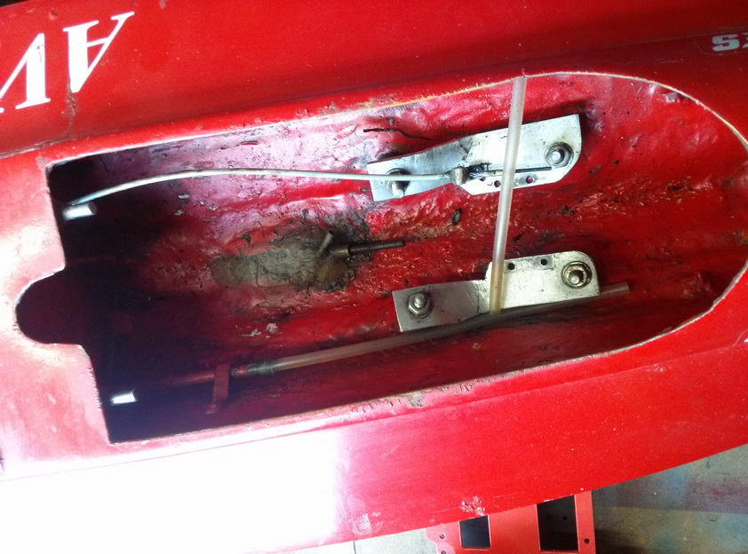

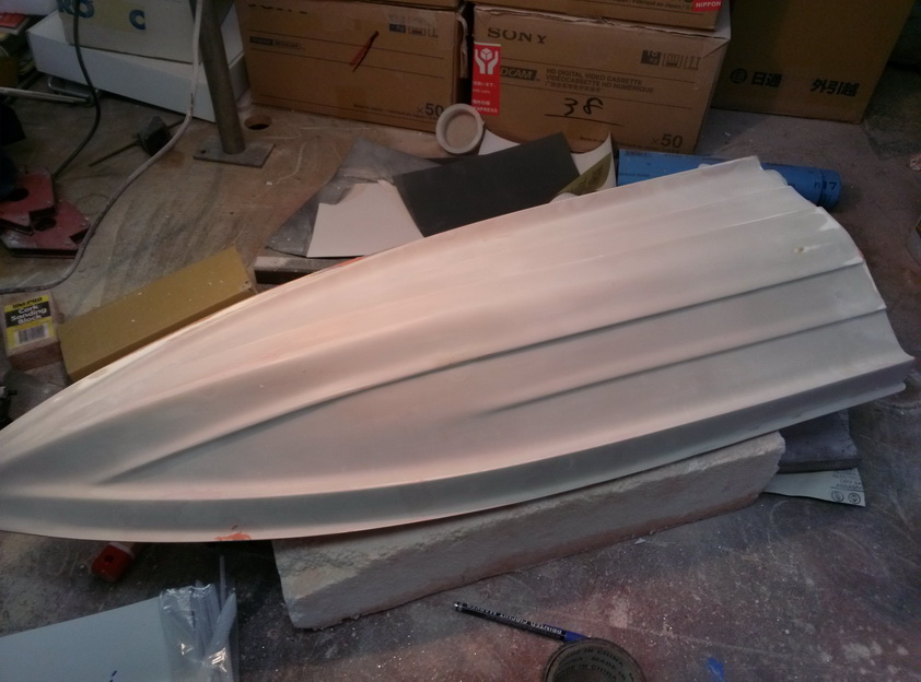

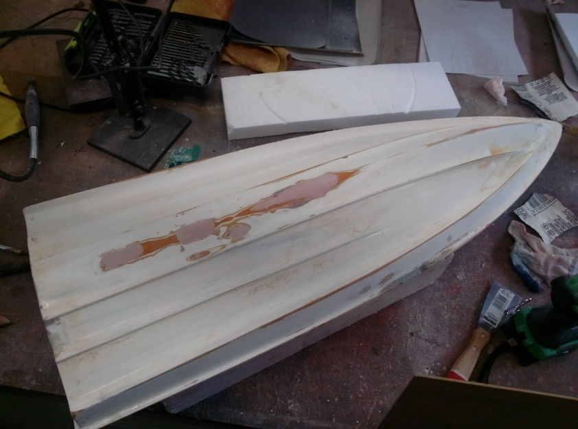

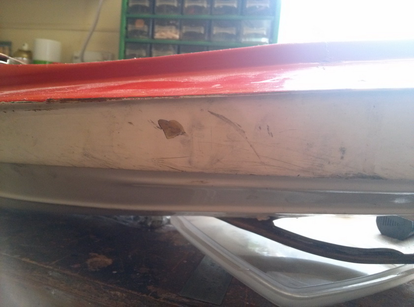

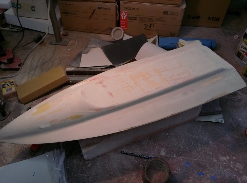

well its almost done re-finishing wise, im just painting now, taking a while but getting there. a lot of trial and error as well. found some good products, and some not so good
a few of my silly mistakes - used acetone on the hull to clean hull up a bit...just ended up melting the paint that was there so I couldnt paint over it at all. had to sand it all back, which took a while
used enamal over acrylic without giving it enough time to cure...orange peel effect...had to sand back again.
eventually got it all back to smooth again, sticking with only acrylics this time, found a great highbuild primer as well that wetsands to smooth as glass with no worries. I dont have an airbrush, so this is all automotive rattle can stuff
unfortunantly the inside of the hull is a bit ugly, the previous owner was extremly liberal with his epoxy putty etc, so ive ground down what I can with the dremel and chipped away, but there is no chance of getting it clean.
solution - paint the guts black
learnt a lot doing this, so the next 3 hulls should be a walk in the park (they are in much better condition too)
