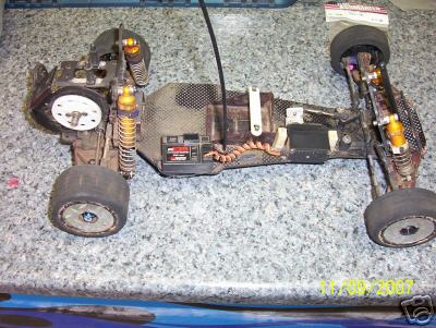

as if i needed another project, i definately did not. but, i did "need" a worlds graphite chassis. i'm hoping it's in good shape, too. because if it isn't, bad things are gonna happen. :twisted: :twisted:
sorry brian.
http://cgi.ebay.com/ws/eBayISAPI.dll?ViewItem&rd=1&item=330186999105&ssPageName=STRK:MEWN:IT&ih=014

well, it showed up today, and pretty much looks like i expected it to. a couple extra holes, damaged kick-up, etc. it definately spent it's whole life oval racing. the chassis is worn down behind the right front arm mount just like my graphite team car. it's got an mip steering bellcrank, and also mip cvd's. i'm gonna start tearing it down tonight. who knows, maybe i'll find a 64p gear set in the trans. doubt it, but a boy can dream.................. :lol:

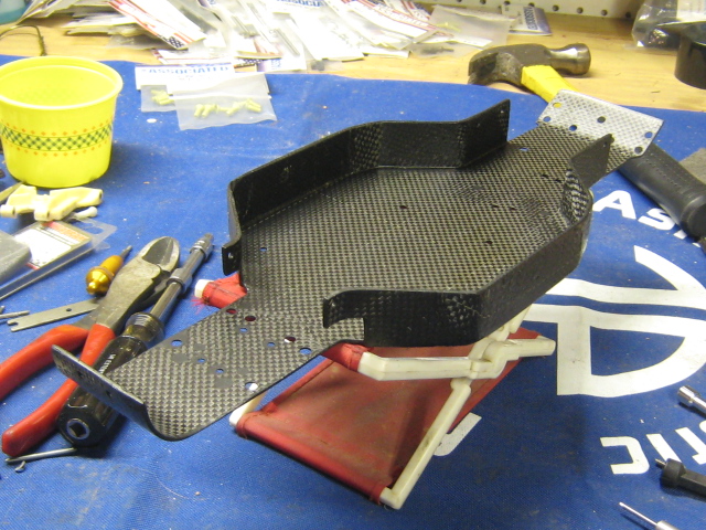

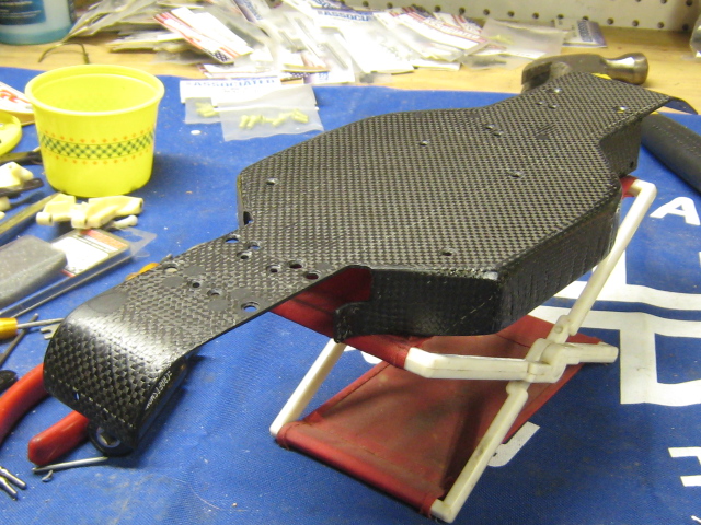

you can pretty much use any kind of ca glue to fix the chassis if it's seperating. if you have extra holes you want to fill, a 2 part epoxy works good. i use 3M automix products, myself.
here's a couple pics of a fusion speed tub i repair for a forum member. the tub was seperating at the rear kick-up, and the front. a few of the arm mount holes were ripped out, and there was a few extra holes. after i did the repairs, i used a clear sealer on it. you can still see the repairs, but there's not much your gonna do about it.
