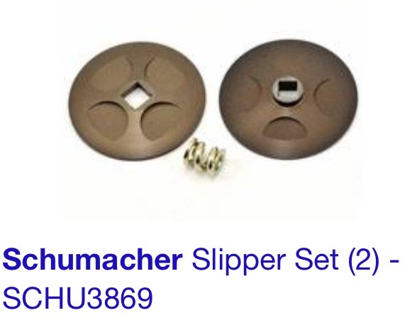

This is the Bosscat I was lucky enough to grab from a forum member. I've seen many people looking for Cat and Bosscat slippers (apparently a lot of Bosscat Sports out there!) and since this one needed a shaft (bent shaft, slipper backplate tore up and drilled out) I decided to draw up an adapter shaft to run a SV2 slipper. This keeps the Schuey guys happy (not cross breeding) and parts are readily available.
This slipper has an odd drive that should have my machinist cussing like a sailor, but the goal is to produce a few of these. The bearing adapter is very similar to the stock one on the left side, however this one needs to be cut in half to install it. Schumacher uses a tiny 4mm shaft so loading the pulleys will have to happen from the left side, then the bearing adapter will slide over it, and the bearing will hold it together. Unlike stock, when this shaft and bearing adapter are installed they will not rely on the slipper backplate, meaning any shimming should be much easier.
I also have drawn up an associated shaft for a standard dual or b5 style but I don't think the Shuey guys are as interested.
Pic shows stock SV2 shaft, just for reference

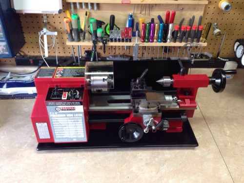

It's cheap, but for re-learning it should be fine. I don't need huge capacity, just decent precision and the size and upgradability was right.

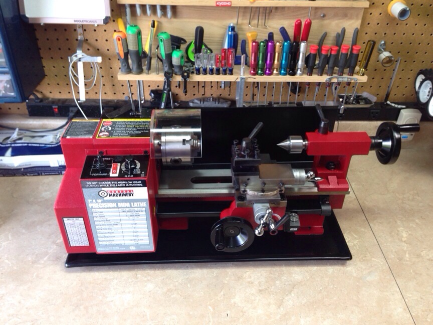

No pics if the rebuild. It was just a simple cleanup in the ultrasonic cleaner with soap and water. DennisM sent rear brackets for me to copy and I still need shocks and of course the slipper shaft. I'll get better pics soon 8)
I had to buy a couple more things for the lathe too :mrgreen:
