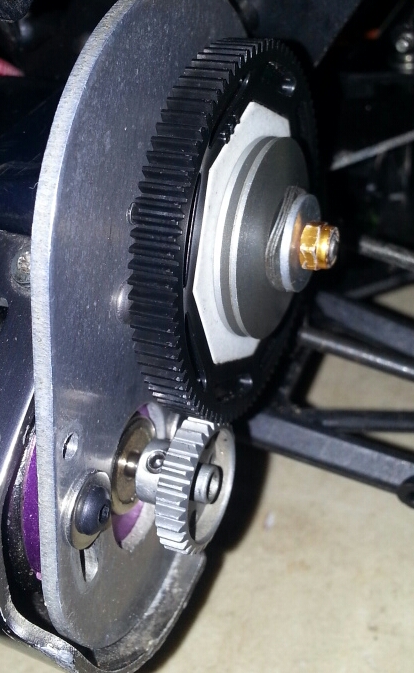

I was able to replace the standard spur with a Durango one and slipper pads by putting a bearing in the centre of the spur. to get the slipper to lock down properly I had to put a 4mm washer up against the outer slipper plate to make up for the narrower spur gear

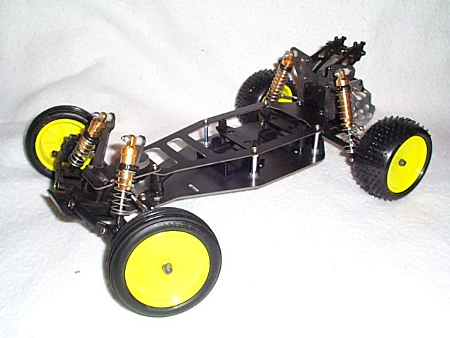

I have some experience with the triumph...building and racing. The problem with the steering is the 20 degree kick and the stock front tires. I increased it to 30 degrees and used a 25 degree castor block. I also used wider front tires...that had a different rib configuration.
The front shock tower also had a lot of flex...so I made my own 3mm fiberglass tower. I also doubled up the rear shock tower. The rear arms had too much flex....so, I ran RPM rear arms for the jrxt.
Overall, the car ran fine, but it just had too much flex in the suspension. It worked better on larger tracks vs. tight tracks because of the longer wheelbase. Here's one that I built and sold a few years ago. I also used triumph components on my scratchbuild.

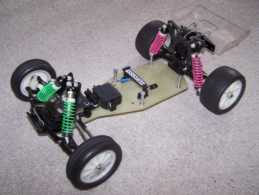

Here's a pic of my "RC10" racer...that was a frankenstein build. I'm still modifying this...and I sent the top plate to a fellow member for his project (but I traced one for my car)

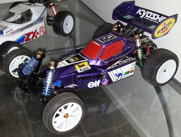

This is a bad picture on my Triumph Works and Kyosho named it "Experimental" and it was delivered in a plastic bag without manual.

Did they shorten the front arms? Looks like a stock bulkhead with plates to make it wider. Front shock tower has that zxr look to it. Did they do something different to the rear arms?

I wonder if the car HCP22 posted is the triumph proto they gave the team drivers which was meant to solve some of the front end dramas and then kyosho put out the pro-x

Looks like the rear uprights use a small (carbon?) plate to move the camber link attachment point. Were they also drilled to put the hinge pin in another position? Hard to see.highwayracer wrote:Did they shorten the front arms? Looks like a stock bulkhead with plates to make it wider. Front shock tower has that zxr look to it. Did they do something different to the rear arms?
Is the rear shock mount two parts? Kinda look like it.
Top deck is also different. Are those shocks Kyosho?

All is as Kyosho delivered it to me except for the battery brace that is homemade by me. And yes its prototype Triumph and the shock's are Kyosho's. I will take some decent photos later on; I don’t have the car at home.

Thanks lars. My plan was to run tamiya trf201/dn01 rims but those look like a great option too
I've added a couple of pics. The slipper setup there I used a second slipper plate to space it out enough. I've now switched that for a 4mm washer
