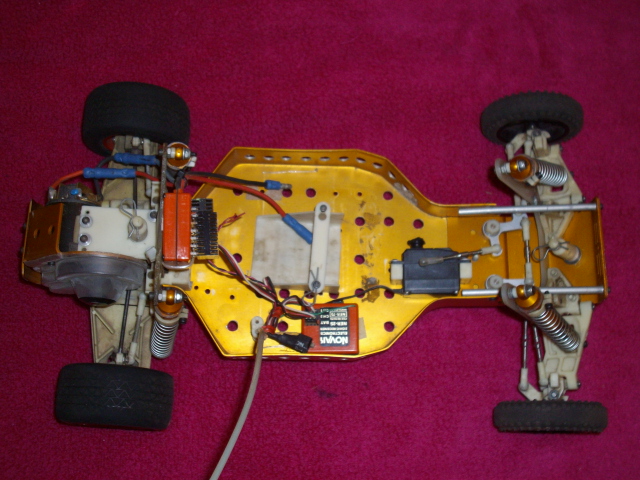

Can any one help us ID the equipment we have and if it is a good start for a driver for my Grandkids. Below are the pictures. Thanks in advance Graybeard48

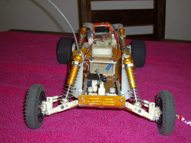

Looks like you got a Cadillac era RC10 that's been upgraded to a Championship Edition and got a Jammin Jay tall front shock tower.
It's a good candidate for a kids basher but it looks like the tub is bent and needs straightening. Front shocks could use some internal limiting with fuel tubing or spacers and depending on the age of your grand kids you might consider replacing the Novak speed controller with something that has reverse.

Great start . I have started with just a tub, transmission and wheels !
I would upgrade the radio gear, and buy some rere parts .

Thanks for the help. Sorry for not getting back sooner. My other son & I have a Datsun 510 we AutoX and we were busy re doing the setup
for this past weekends event. Anyway I have a few questions 1) will the ESC work with the new Lipo batteries? 2) will the charger work with the new Batteries? 3) will the motor work with the new batteries? 4) or should I stick with NiCd's and if so what size 2500ah,3500ah or
5000ah? and finally 5) should I disassemble the stealth gear box and service, lube or just run as is (it spins freely)? Also as to the tub being
bent it was the angle of the picture it lays flat and measures square on diagonals. Thanks again Graybeard48

You can run the Novak and brushed motors with lipo batteries. I have found the Novak 14 gauge wire tends to desolder from the motor when running lipo batteries. I suggest soldering 1" of heavier gauge wire to the end of the motor leads. I would also suggest Deans or other quality plugs for the battery. When you finally decide to run lipo, you will wonder why you waited. You will need a new charger for lipo. Regarding the trans, if it ain't broke... :D

As mentioned earlier, you do have some aftermarket parts on there, with that TALL front shock tower and 1.32 stroke (rear-sized) shocks being the most apparent. They are totally overkill but they will certainly work for a basher. Problem is one good hit or hard rollover and that tower will probably get broken off.
Yes, the chassis is not straight but you'd be amazed what a few minutes in a vise and some light muscle can do to a bent RC10 tub. It won't be perfect but you can get it pretty close. The extra holes are pointless but they don't look excessive so it's probably fine otherwise.
Looks like you have some Technacraft titanium tie rods in the front which is good stuff. Also looks like you may have aluminum steering bellcranks which is also good. Make sure you run a server saver if it doesn't have one already.
The toe-in in the rear looks wrong, or non-existent. Check to make sure that the rear hub carriers have not been swapped left to right. The rear arm mounts will give 1.5 degrees of toe-in and the hub carriers should give another 1.5 for a total of 3 degrees per side. If the carriers are swapped you'll end up with 0 toe-in which will make for squirrelly handling.
