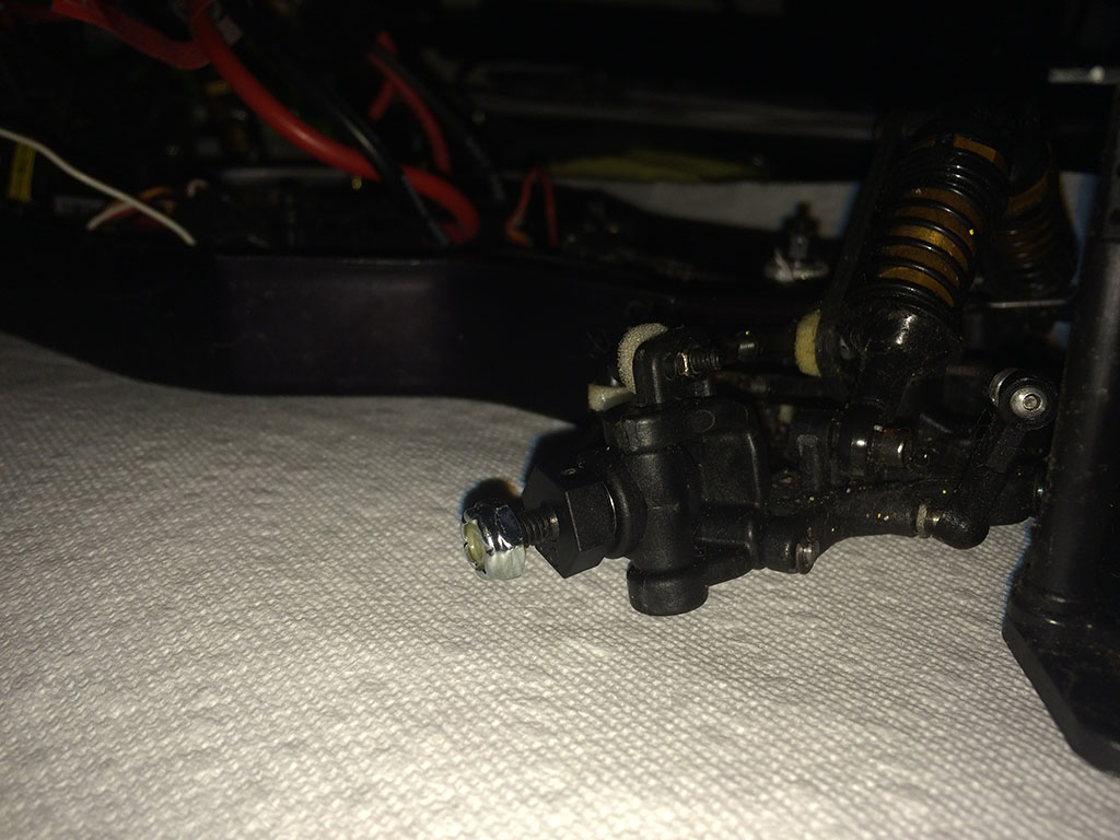

One more question about this - and please keep in mind, I'm just starting this research, haven't even taken my old wheels off yet...
What IS the issue with the original steering blocks & suspension pieces? Is it clearance? Axle diameter or length?

So I can only comment on what I think I know. The original front setup has bearings in the wheels. It seems that all of the new wheels are "hex" wheels. This means the bearings need to move from the wheels to the car. That is what the new parts are doing, by using modern parts for the caster and steering block. You need to change the caster block because the hex steering blocks won't fit in the old caster blocks. With the changes it sets up the front to take the hex wheels. (and you add hexes to the back as well).

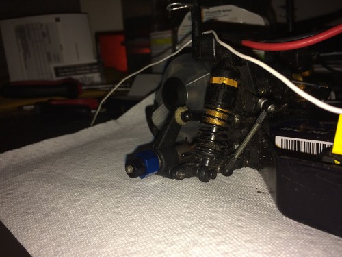

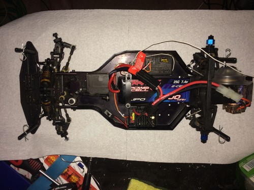

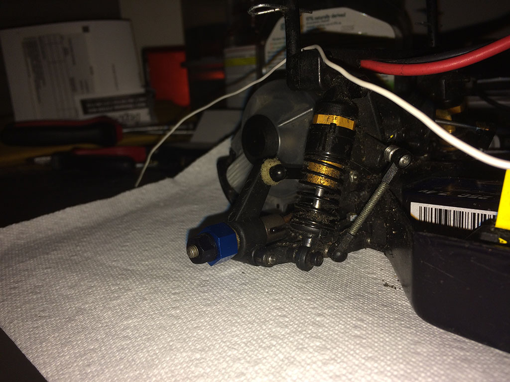

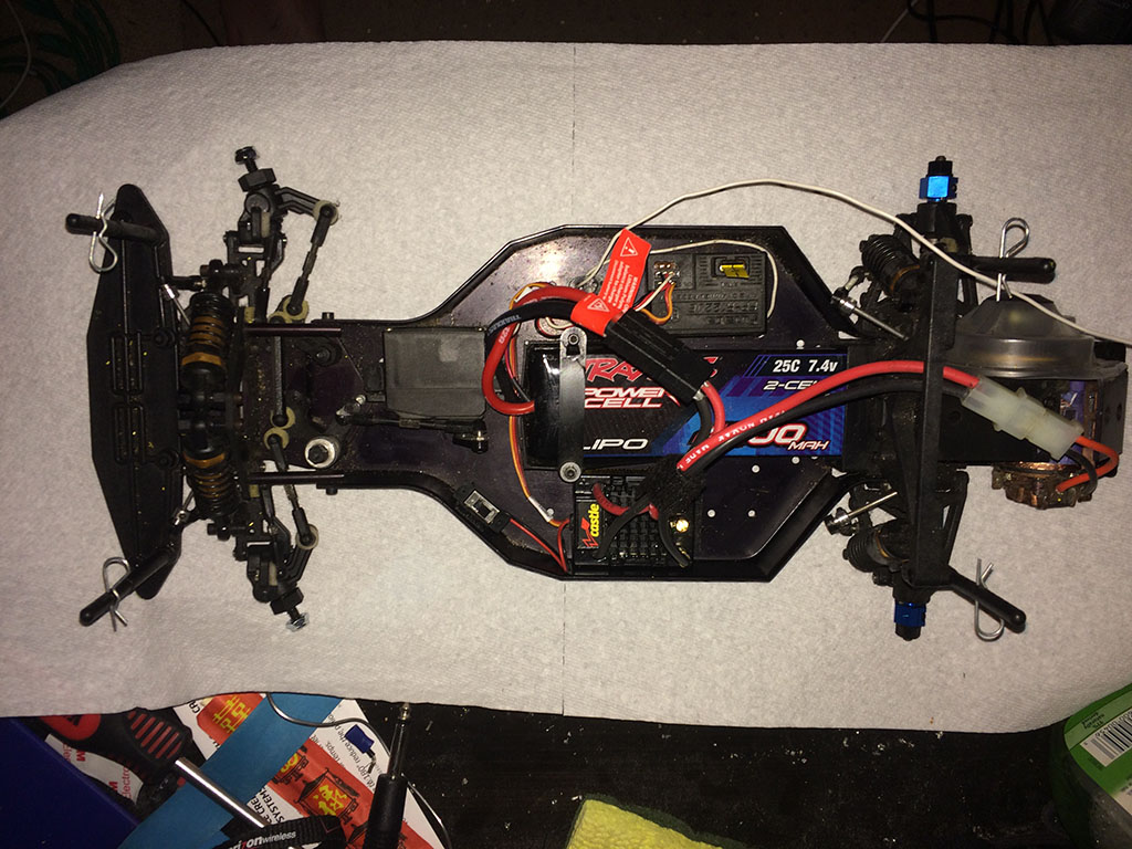

Well, I looked at my rear A-arms and, sure enough, when I moved the spacer to the rear of the A-arms I end up with a 260mm wheelbase instead of the previous ~263. With the spacer in front, it was just enough of a difference to make me second-guess what it was supposed to be. I have always felt like the body didn't fit quite right and I wonder if this was the root of the problem?
I also installed the new hex equipment today. The wheels *should* arrive tomorrow, so we'll see what it looks like when it's all finished. I think it's going to be a little narrow with the original body, but should be fine once I replace.
I also cleaned it up a little more & added some teflon bike chain lube to the primary gears & universal joints. It sounds smoother! Can't wait to see if it actually made a difference!
