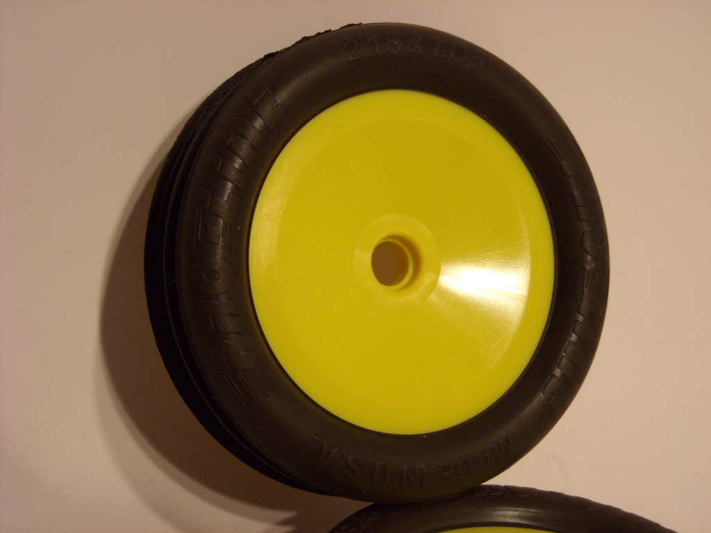

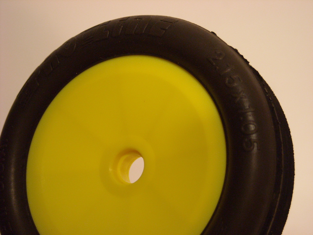

- Posts: 263
- Joined: Wed Nov 06, 2013 8:01 am
- Location: Schwenksville, PA
Re: Correct B2 Front Wheel/Tire
This is what Niki told me when I asked him about B2 wheels:
You can use ASC9480 or ASC9481 front wheels on NIX91 and B2 if you find those somewhere. Wheel axle ASC6220 should be used on NIX91 and B2.
Easiest way is to buy RC10 rere-Worlds wheels + axle ASC7459 and cut front wheel inner section off. Example http://www.rc10talk.com/viewtopic.php?f=99&t=36419&start=30#p405616
I'm not 100% sure but I think these Duratrax wheels (dtxc9840, dtxc9842, dtxc9848, dtxc9861) match old B2. Can be used on NIX91 also then with standard front wheel axle ASC6220.
Rear wheels: For example ASC6805 (RC10 rere-Worlds) or old B2/B3 rear wheels.
