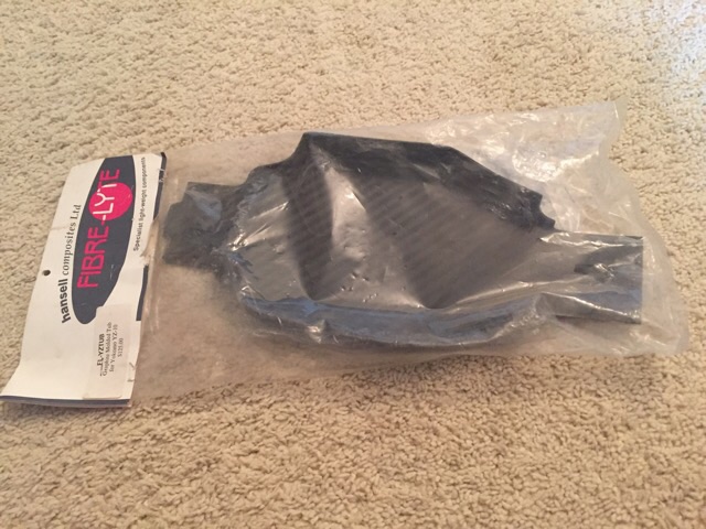

Thank you guys for the insight, sounds like the 870c is a great starting point. Are there any other good places to find cars besides eBay ? I've been looking for awhile and only seen 1. On a side note I was able to score this Fibre-Lyte chassis from my LHS yesterday.

Well your off to a good start, found one of the rarest parts going. Nice
