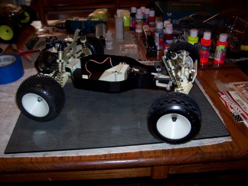

Re: RC10T Team truck
Finished up the chassis and trimmed the body just have to paint it. Restored the chassis using the team manual via the " The History Of The RC10T. I used a rerelease pan and rear bulkhead to run lipo and back ordered from tower the white 30 degree caster blocks. Also went with MIP T4 cv shafts and added the 1/4" axles to run the stock one pieces rims. Still looking for the correct narrow body . The hard part #6372 for me where the spacers under the trans brace . #6372 shows up as the spring and spacer for the rc10 dog bones. Ditched the spring and used the white spacer for the trans brace.
Hi Dave,
Team Associated had a bad habit of recycling parts numbers and also changing white parts to black
without changing part numbers.
You can use these washers as spacers under the trans brace,
http://www3.towerhobbies.com/cgi-bin/wti0001p?&I=LX2847&P=7
How is the plunge of the T4 cvds when the suspension is compressed?
Cheers, Dave.
I have to correct myself. The MIP CV's are the ones for the T2 #1082 just added the RC10 1/4" axles.

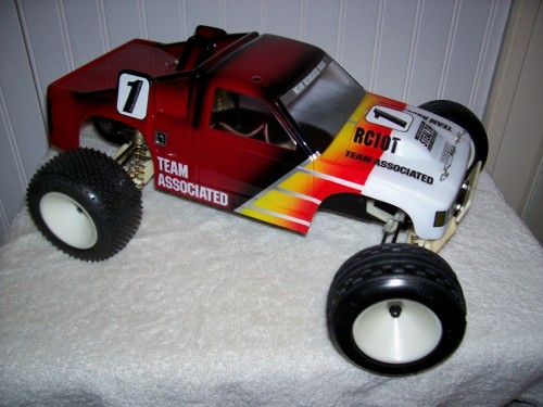

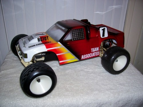

I believe it's sliver that fades to white.
With Losi wheels:
With Losi wheels:
Nice paint . Hope mine turns out like that. Hard to see the silver to white shading in the add pic. Thanks for the info.
