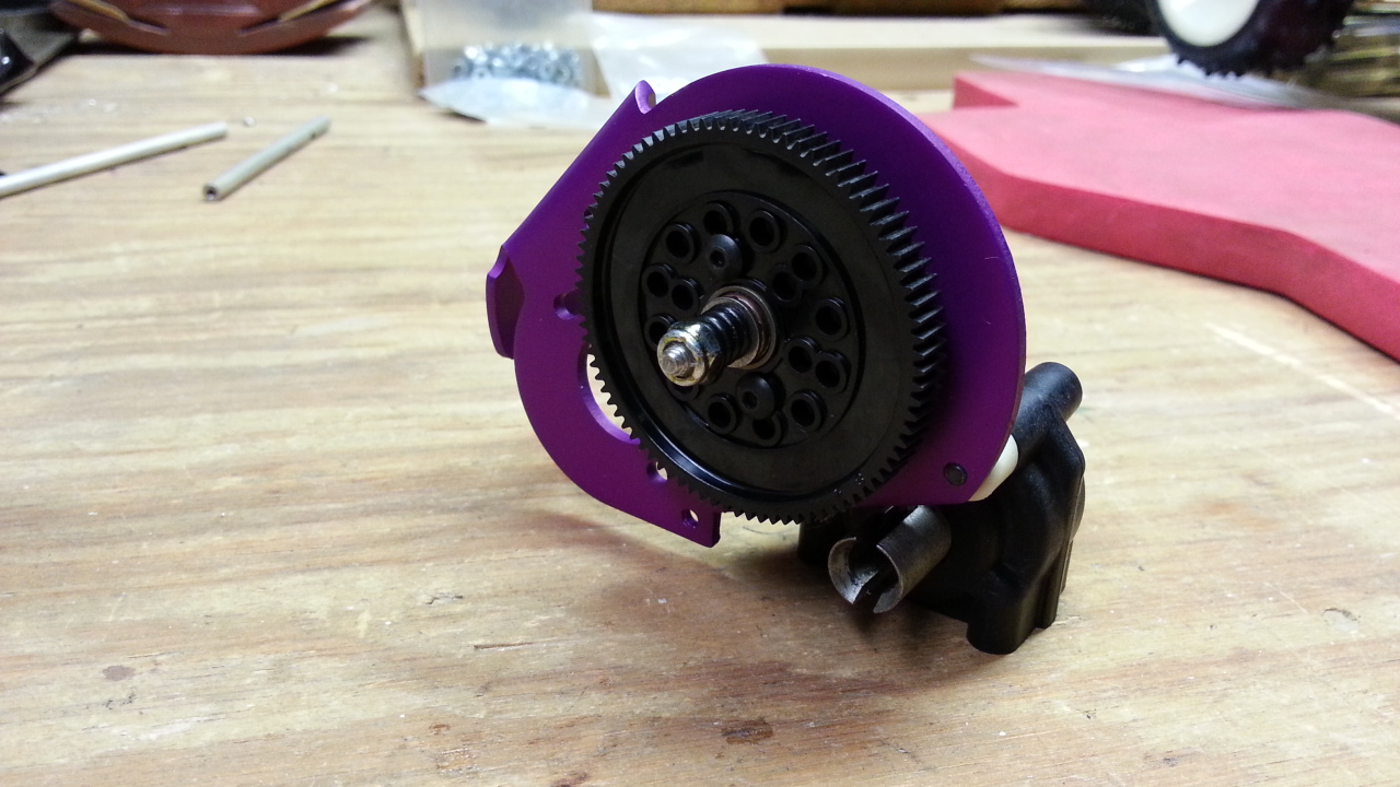

Seems like this would be an easy part to find. I need a spur gear for the rc10t. I am running a reedy radon and my gearing is 14/80ish spur,not marked. I want to find at least a 90t spur. Im seeing spurs for the rc10 buggy,but it doesnt look right.
Right now my motor temps are180-200 which is way to hot for me. Does anyone make these anymore or am i stuck with ebay hunting? Will the rc10 buggy gear fit?

This will work with the rc10t single slipper? I have the one where the gear screws to the metal slipper disc

It'll work on any Associated slipper clutch up until the b4/t4.

I converted my top shaft to the B4 shaft, and can now run the B4 slipper setup and B4 spur gears. It's one of the best mods you scan make if you actually drive the vehicle.
