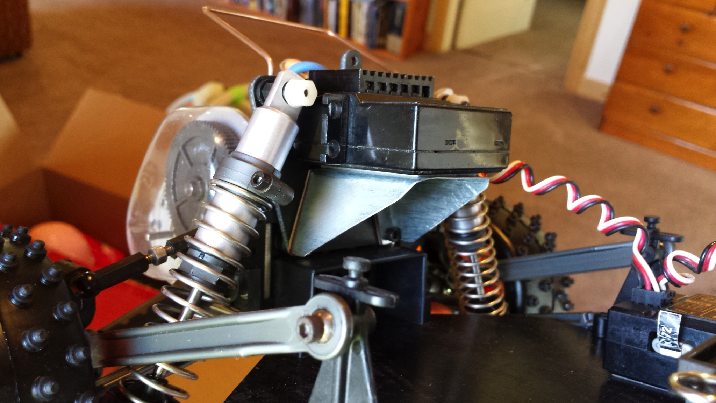

So I rebuilt the diff with off the shelf hardware store 3/32" chrome balls and the Thorp gears. Tore it all down, cleaned it up, put some 15W-40 SYN API CJ-4 in the shocks, put an S&K Torque II in it along with Futaba MC 112B ESC, FP-R102JE Rx / Magnum Sport Tx, and FP-S148 Servo. Even built and soldered up a little tin ESC shelf ala RC Car Action Pit Tips. And now I don't want to run it. Ha Ha Ha Ha.
But it all works and throttles up. So tempting.

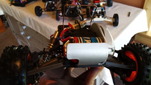

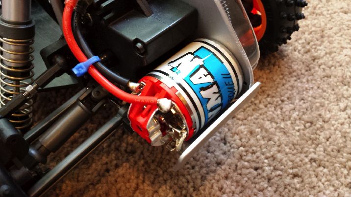

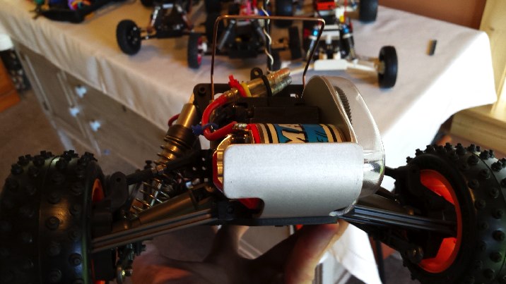

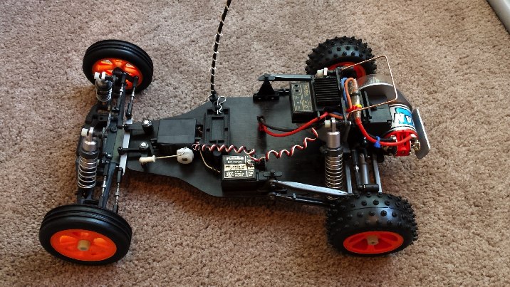

Well there are some pics. This thing was pretty clean when I got it. Thanks Limestang.RCveteran wrote:Sounds grreat. Let's see some pics please!
I am missing the spur gear E-clip because the Thorp topshaft runs one more than the stock and it is in the gearbox. So I guess it's not missing. More properly; I am deficient one crucial powertrain E-clip.
Mark
