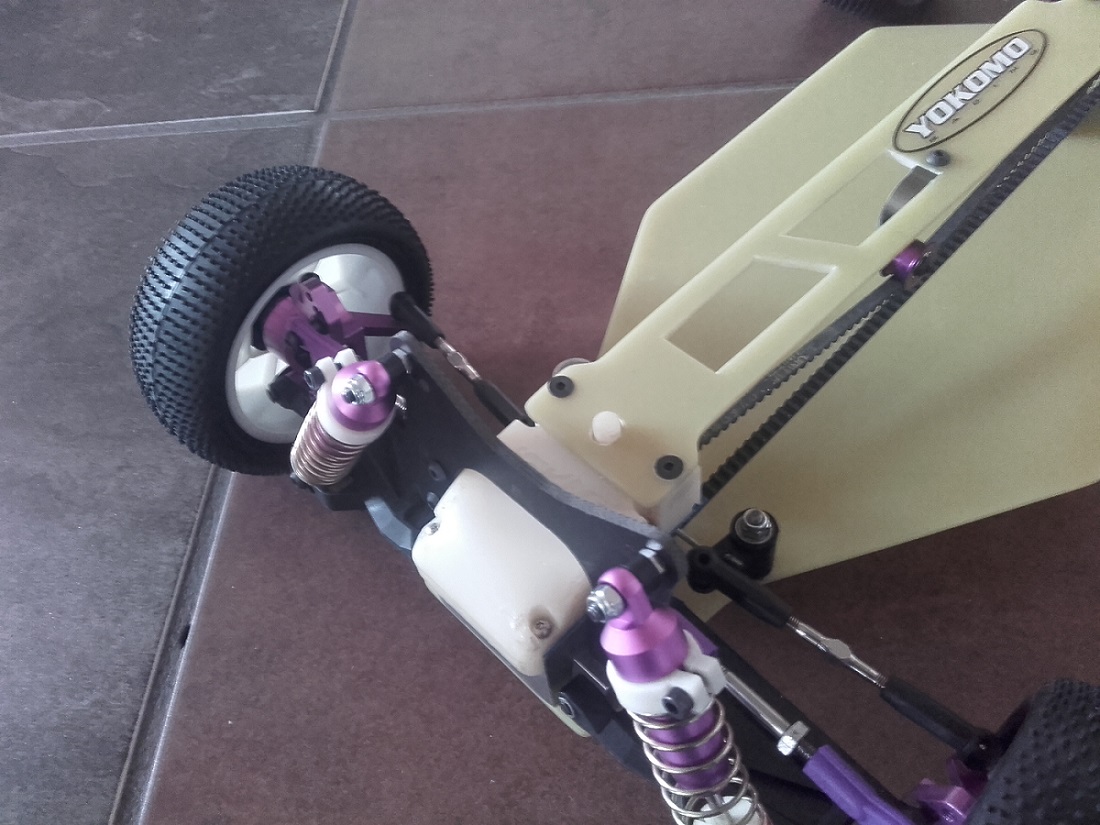

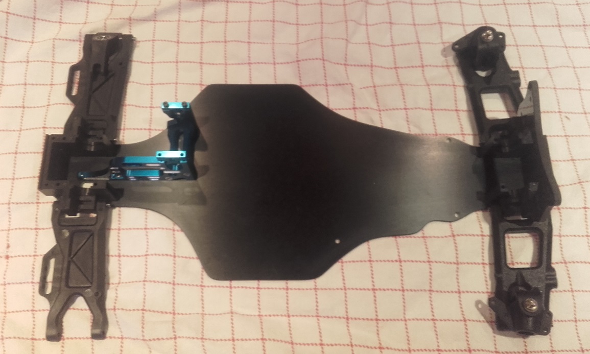

The question is obvious, but what´s the answer :P

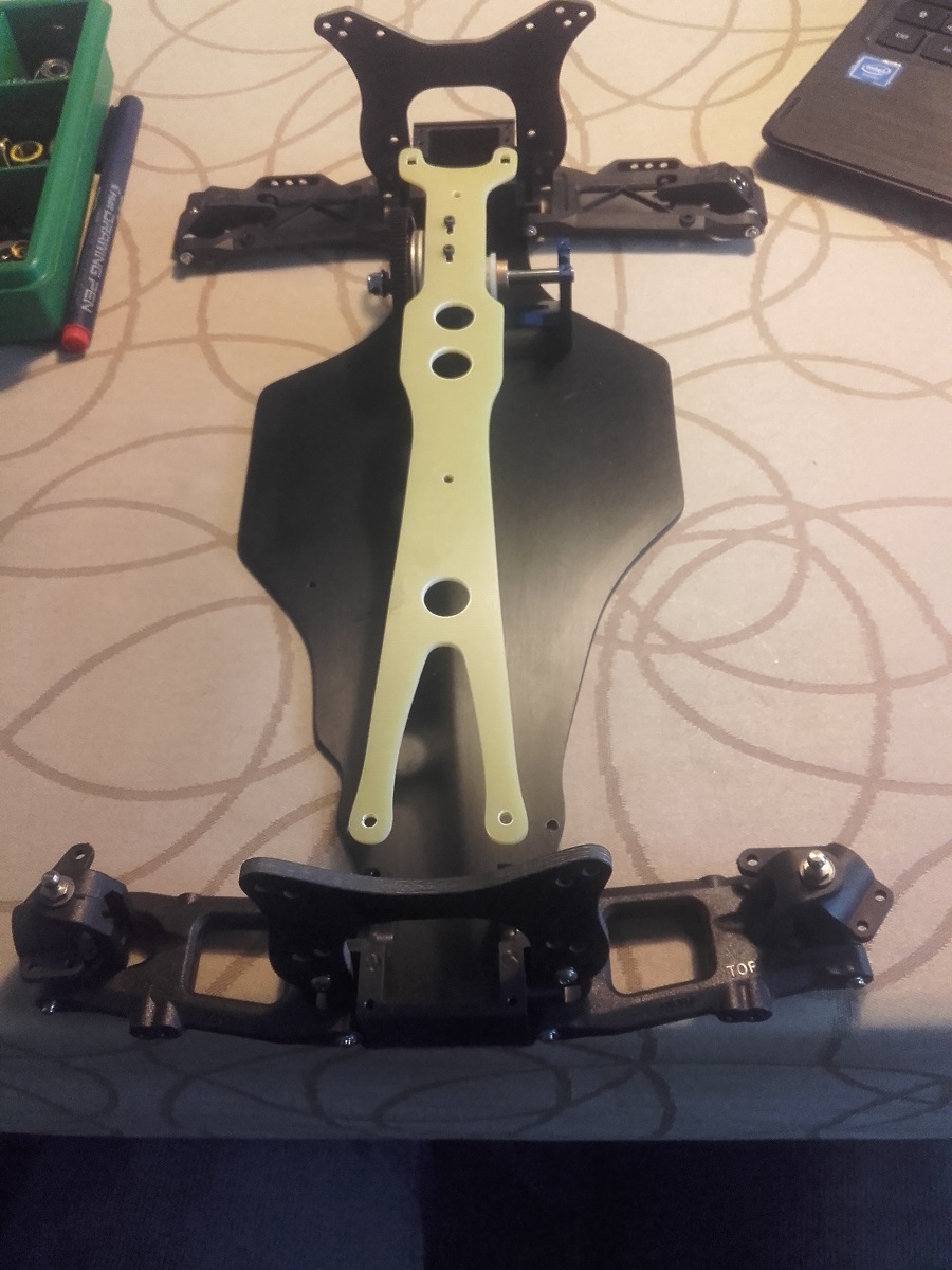

Peakey was right about the motormount being the thing in question - Mr. ED has the maker right.
But it´s not meant for Yokomo :P and the reason why I cheated on Jeff :lol:
The mounting holes are of compared to the Yokomo mount so I had to do an new chassis and topdeck without motormount holes.
The shocktowers are going to be 91 at the front and a homegrown 93 at the rear.

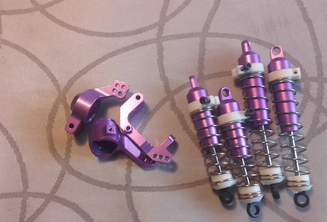

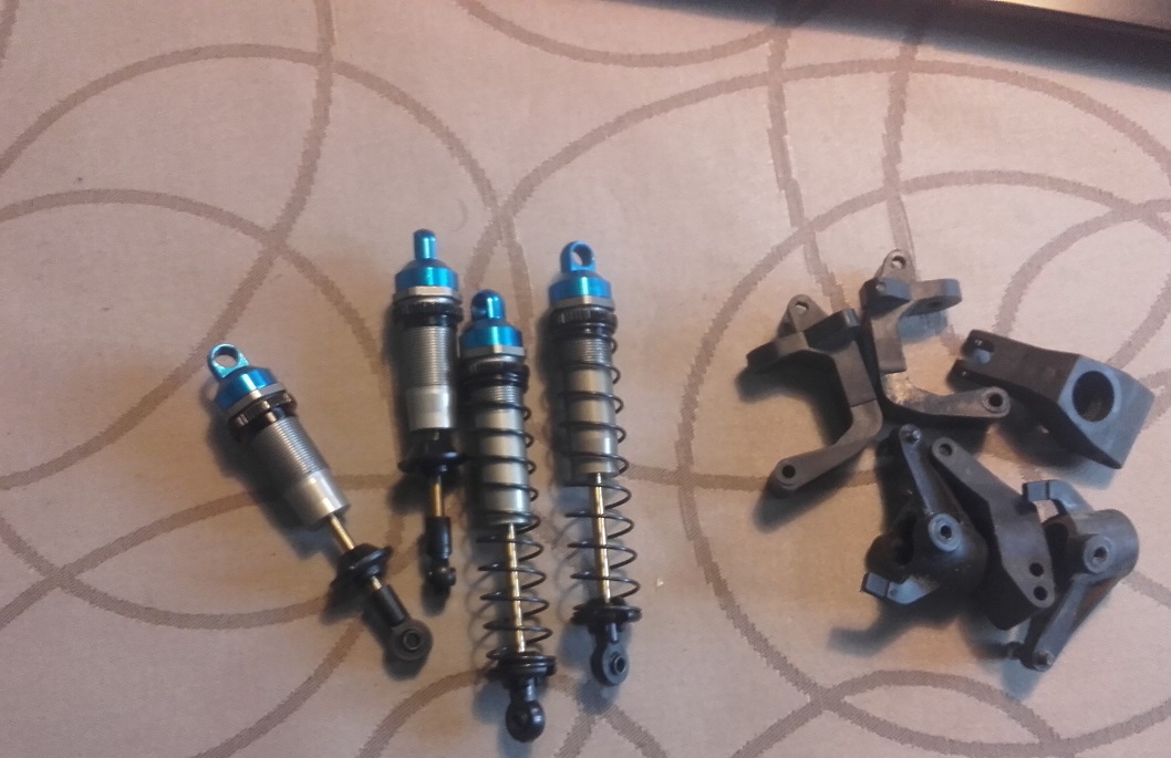

As for shocks, I´ve got two setups in mind - either AE or Academy purple shocks ala Option house golds.
If possible, I´ll try to find some sort of natural nylon arms for it.

What's the diameter of those shocks? :lol:

Just about 9,987 mm bore :mrgreen:

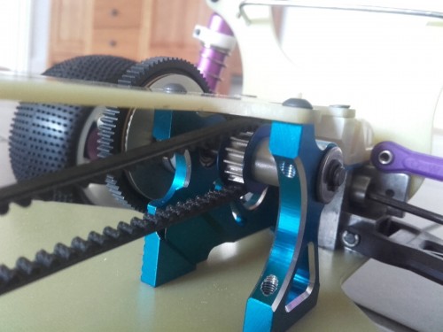

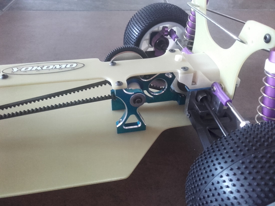

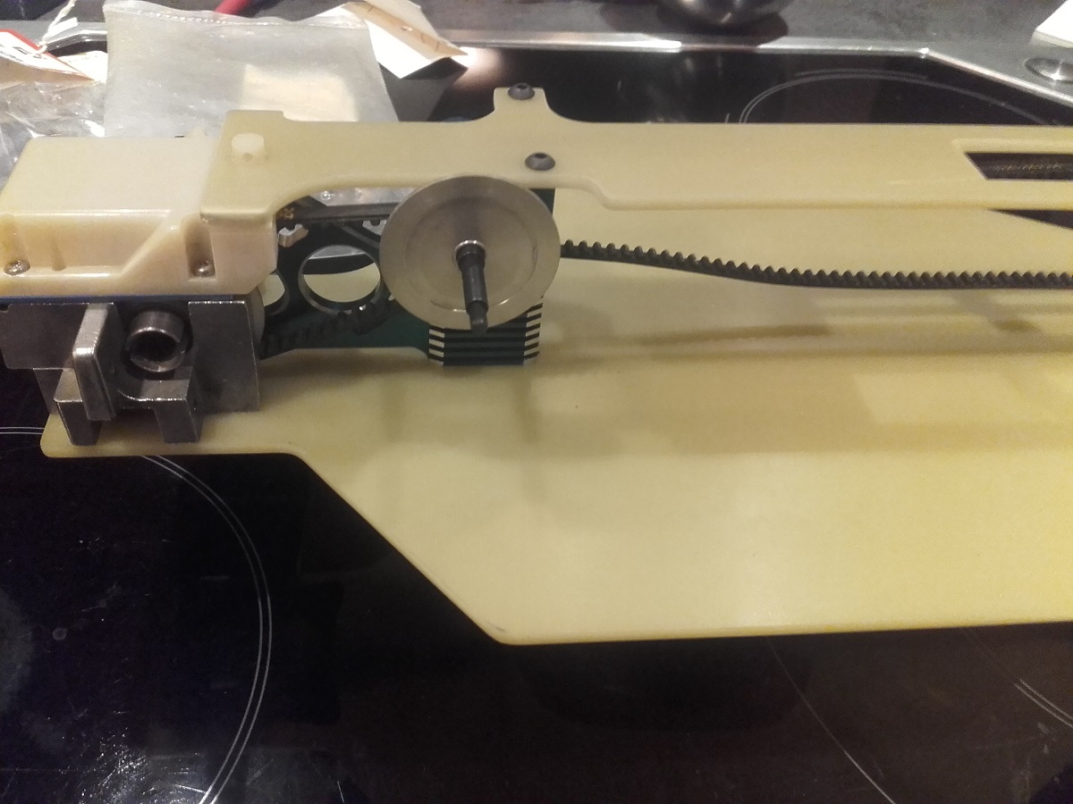

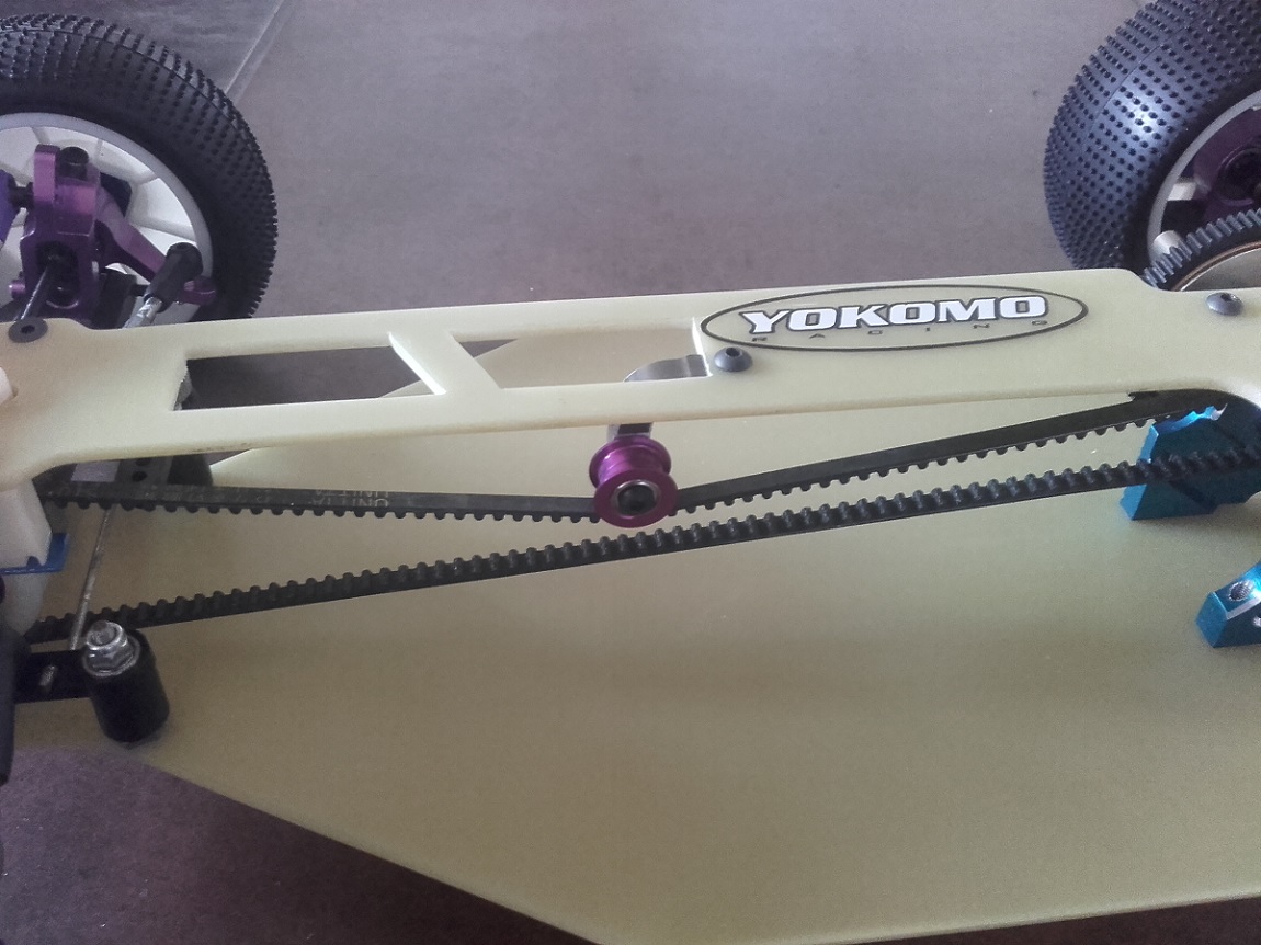

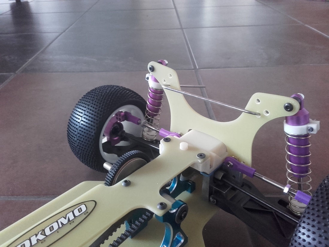

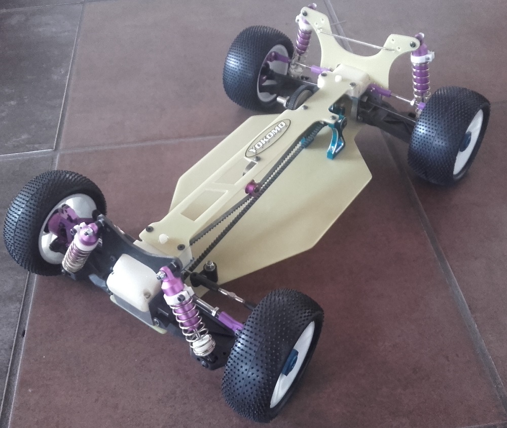

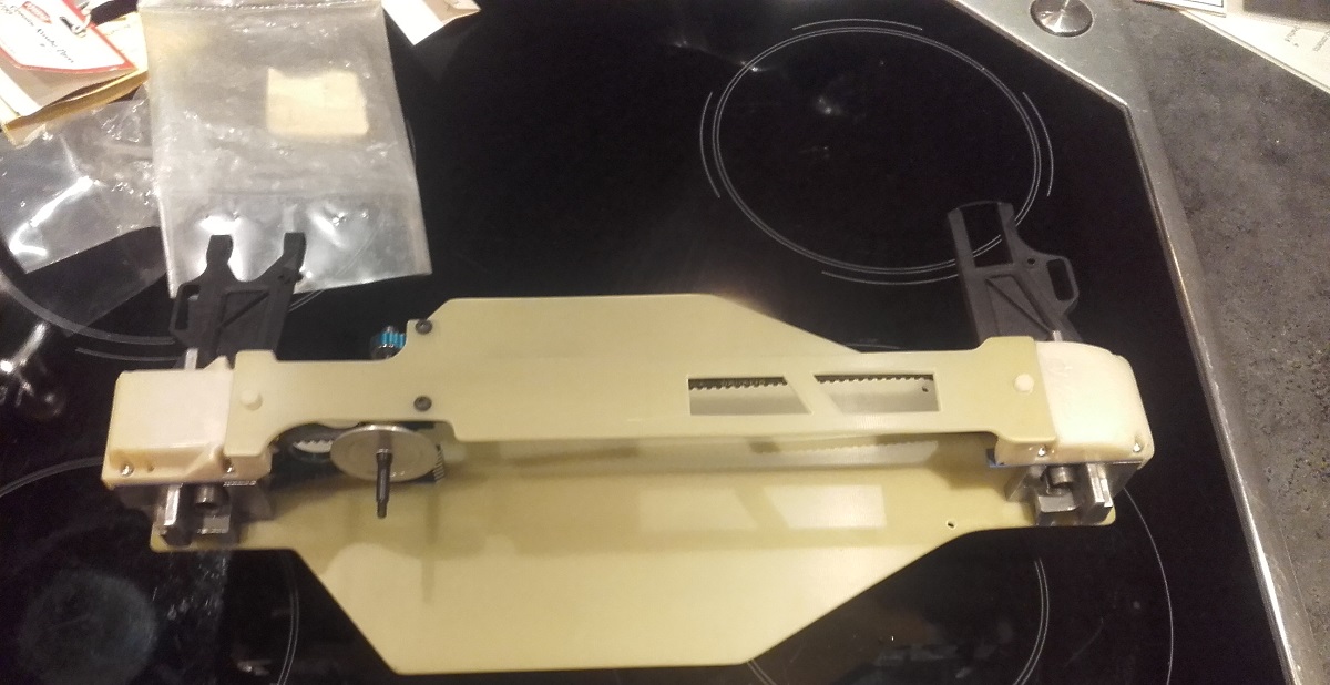

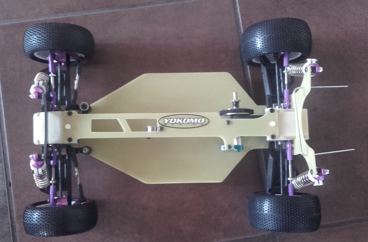

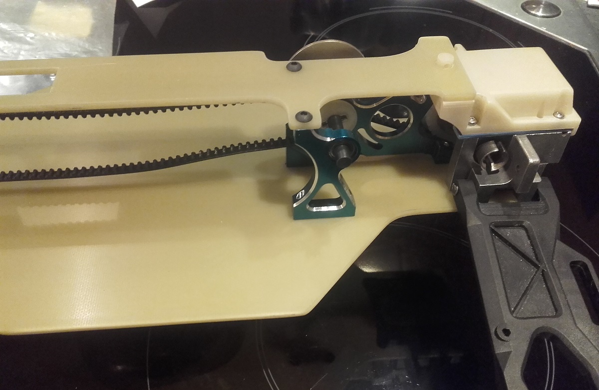

870 chassis blank by Jeff, formed into Works ´93 chassis.
HotDog front and rear bulkhead (no YR4 bumper cutout at the front)
Fastrax motormount
Works ´92 rear shockmount, fibrelyte Works 91/92 front shockmount.
Works rear arms and carriers - front arms are RPM rears for 870, modified to accept CAT 2000 C-hubs.
I hope to build some diffs from GPM delrin pulleys and perhaps Academy outdrives. (need to save the nip´s for the ´93 build :mrgreen: )
Layshaft is a random, cutdown, 5mm axle with 4mm threads.
Inner plate is original Yokomo T.C.S (which actually is the same as an inner plate from a Stealth with an added belt pulley and remachined groove for the 2,5mm crosspin)
Outer plate is Kyosho ZX-S, with added groove to hold the pad.
Front pulley is std. Yokomo
