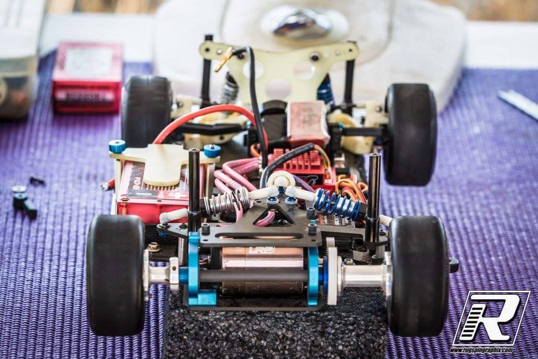

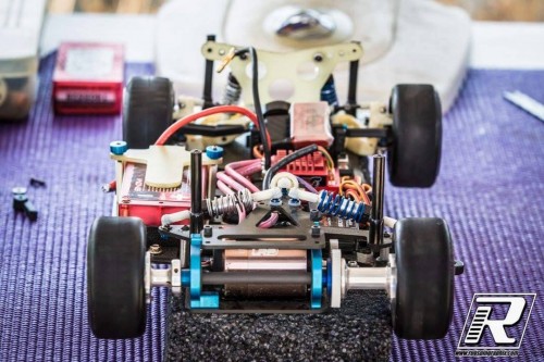

I last ran a pan car or oval over 20 years ago. Due to Facebook, I actually found (or he found me) one of my racing buddies that I got addicted to oval back then. We would race at Ascot/RCRC and other local tracks. He tells me they are going to run at the Velodrome again...I am instantly excited. I jump out and purchase a L3 oval immediately. I strip the car down and clean it up and begin the long journey of building a suspension front end for it. Most guys are using DS front arms, B3 carriers & axles and custom bulkheads & towers, with micro sized shocks...looked in my parts box. Nope, didnt have any of that. What do I have? RC10 shorty arms, 5/10/15 degree carriers (not sure which ones), trailing knuckles & B4 trailing axles. What the heck...lets build a frankenstein!

I dug into an box with an old OFNA Z10 sedan. Started looking at the front gearbox mount/bulkhead and thought...that could be a base. I measured it out and it was pretty dead on to what I needed. I had a small sheet of Delrin (or Delrin like material) and quickly made a spacer to lift the bulkhead up off the chassis. After that, I trimmed the hinge pin area and fit the front arms. Made a little Delrin piece to fit inside the bulkhead to hold a shock tower...now, what to use for a shock tower? How about a modified rear RC10 shock tower? SURE! After a few measurements and cuts/grinds/cuss words/re-cuts, I end up here:

So, I clean up the L4, move the front end over. "Borrow" the micro shocks from the L3 and fab up a way to hold the shorty 2 cell lipo battery.
I wasnt 100% happy with my first battery holder (RC10 stock holder up side down, bolted from underneath & holes for the wires opened up. So I robbed by gold pan racer of the cut battery box & G10 strap with hold down screws for the race.
Painted up a body, tossed on some stupid large pinion gear & tiny, tiny spur...

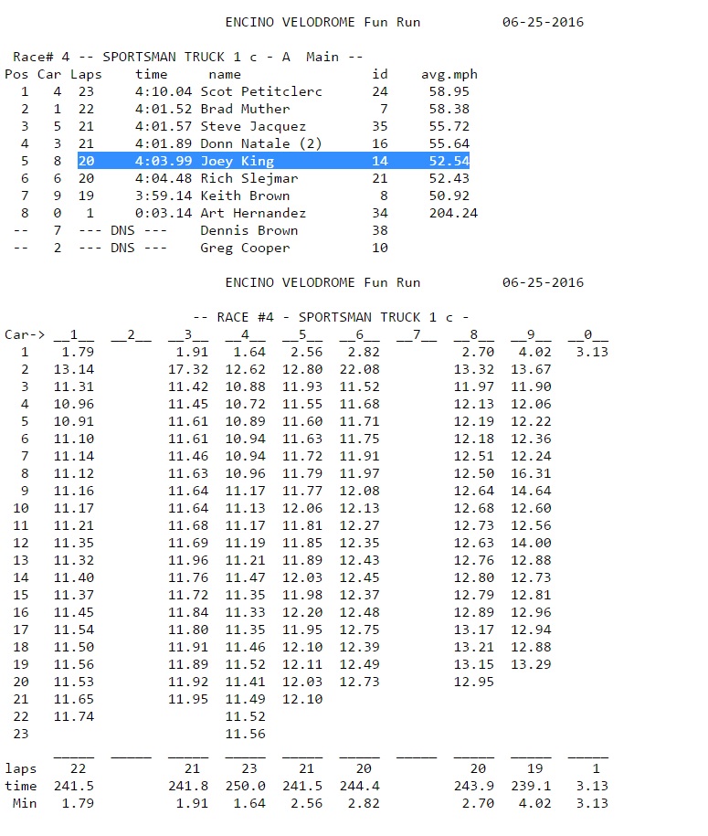

Qualifying starts, they split us into small groups, so we can get good clean runs. Standing starts..great, something I didnt test at all. Tone sounds, I roll onto the throttle slowly, truck feels good, going straight, so I let it rip. Take off into the lead and never look back. Completely amazed. Ran 20 laps (TQ is 23 laps, so I am pretty slow overall). Motor was cooking though...
What to do? Motor was hot, but down on speed. So I took some timing out of the motor & gear up 2 teeth. Q2 comes around and I immediately know that was a mistake. Truck feels sluggish around the entire track and the other trucks are walking away from me. 19 laps & motor is over 220 degrees. Crap...quickly get it in front of my makeshift AC unit to cool it off and hope I didnt hurt it too bad.
Q3, dropped my gearing as low as I could, I dont own very many 64 pitch pinions. Q1 - 72/62, Q2 - 72/64, Q3 - 75/60...Get out onto the track, tone sounds & I roll on the throttle. I dont spin out so I get it up to speed and wow, truck feels much better. Still down on speed overall, but what's a guy to do? Drive the wheels off :) I turn 20 laps, 2 seconds shy of 21. Satisfied we head to the mains.
Mains - they combined all the truck heat into 1. 10 trucks, I am 8th overall. Tone sounds and a bunch spin out...but not me :), I roll on smooth & easy and take off in 4th place. I concentrate on just turning smooth laps. I do get passed and dropped to 5th, where I stayed for the rest of the race. Down on speed, but drove super clean and didnt get in the fast trucks way. I'll take it...5th in the A main after a 20 year absence...

Some more stuff from the race :) , yes, even though I was down on power, I was over 52 mph average for the entire race.
