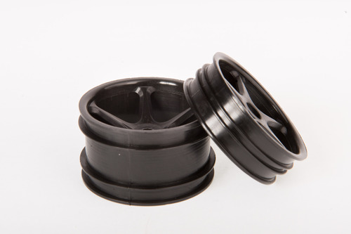

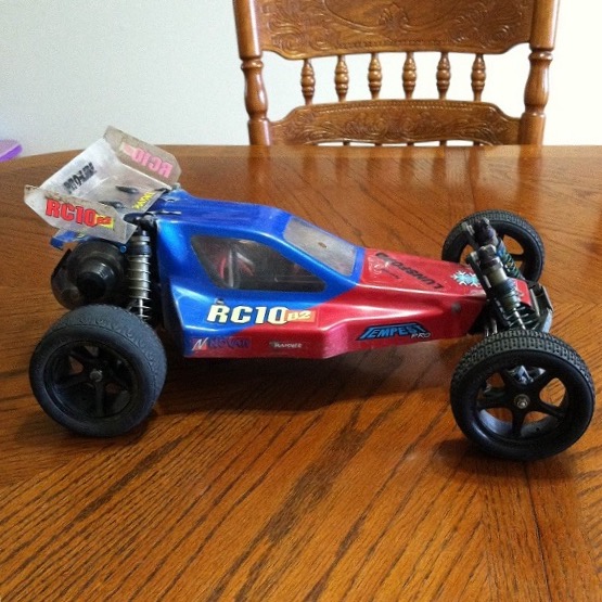

I have these for my B2. They come from the UK, I had no problems with payment or shipping.
http://www.jcracingproducts.co.uk/clearance?product_id=259

Tamlok - Wow. That's and outstanding find and exactly the type information B2/B3 owners need to see. The black spoke wheels look great. My original RC10 Graphite (now a shelf queen) has a set of 3 pc wheels that I dyed black; it looks amazing IMO.Tamlok wrote:I have these for my B2. They come from the UK, I had no problems with payment or shipping.
I already ordered 1 set of B4 front rims and Phonenix BX rears all in white. I haven't ordered the front axles yet, but as scr8p stated above, it is a pretty cheap conversion. I will have to decide which way to go. I'll re-post either way.
Thanks for the info. Pic posted as reference

the JC wheels are really nice. They have a profile that fits narrow outline tires, particularly the fronts, so the latest 2.2" tires could be a little balloony on those wheels just FYI.
