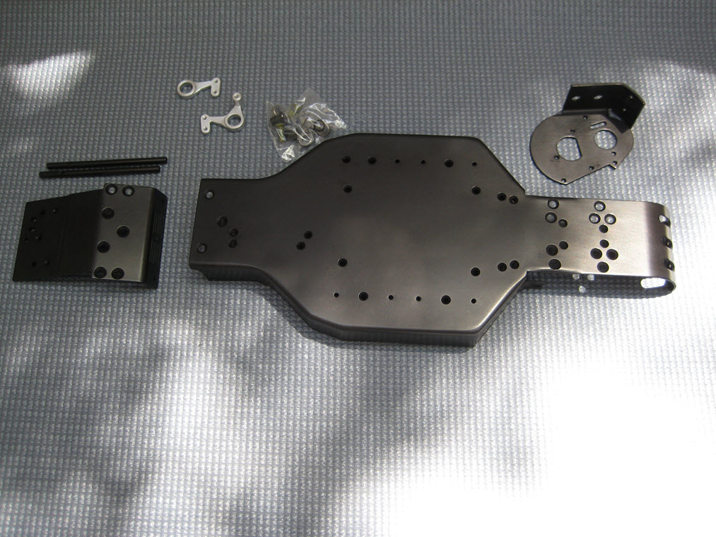

Ok, I believe I'm done buying Worlds rere's now. :lol:
I've had this build in mind ever since the rere's started. In my opinion, AE kinda dropped the ball never offering white wide track front arms. Between the Classic and worlds parts, it would've been easy to build rere 6 gear CE's, Stealth CE's, and Team cars. Well, the planets sort of aligned for me the other day with a nice ebay lot to get this started.

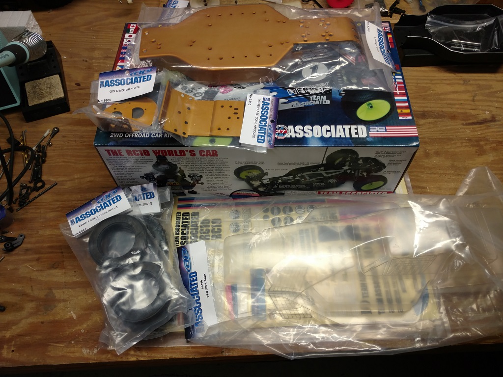

I won an auction for a new Worlds kit. But it also came with a full gold chassis set, as well as classic tires, sticker sheet and a protech body. Though all i will be using is the chassis parts.
So basically what will happen is the gold parts will be redone in black. That will give me a full nose plate that was never offered in black. I'll also be picking up a stock style bellcrank, white wheels, white shock hardware, white rear arms, fiberglass towers, and a Viper body. I think I have a nice white trans brace for it and I have a pair of white front arms. But I'm gonna try to paint the kit front arms first. If I can get them to match decent they get used on the build so I don't waste new originals on a rere. :wink:

So you're going to reannodize the gold to black?
Posts: 16839
Been thanked: 1338 times
Re: Scr8p's "Team Car" Rere
shodog wrote:So you're going to reannodize the gold to black?
Yeah. They never made a black rere nose plate that wasn't cut off like the worlds. So I would have to get that done no matter what. I'll send it all out and hopefully it all matches.

I see that the gold pan nose plate has a few more holes in it, and I'm guessing that the classic steering assembly works with the gold nose plate? So that's what you would need to replicate a Team Car?
I'm asking because I see that ae offers a black classic chassis, but no classic nose plate in black. Only the short World's version. Also, the .71 front Team shocks are basically non-existent. I haven't managed to find a set anywhere. Yet. :| I'd love to find a set of those.
