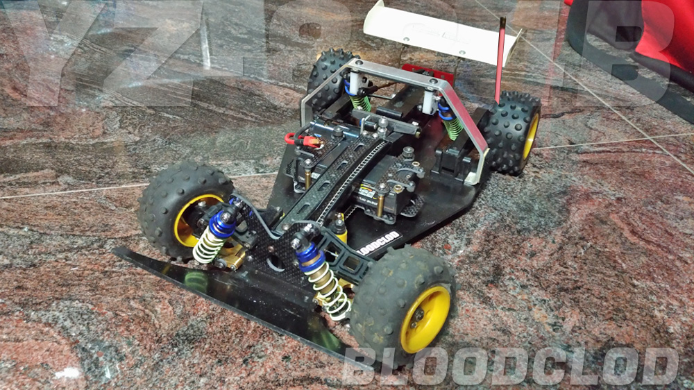

This Yokomo 834B last saw action in 2010 when we had a local vintage event - after which it was put on a shelf and untouched for the last 7 years. lol! :)
Standing proud at NOOB Vintage 2010.
I happened to visit rc10talk recently and as it so often happens the itch to work on the car started again (rc10talk is dangerous I say!)
So here's some 2017 updates to a 1983 car. I really wanted to keep the kydex chassis with the huge bumper as well as the original rollcage as I felt these are very iconic parts of the car. However, the plan was to see if I could make this a more decent runner by adding some touches of my own.

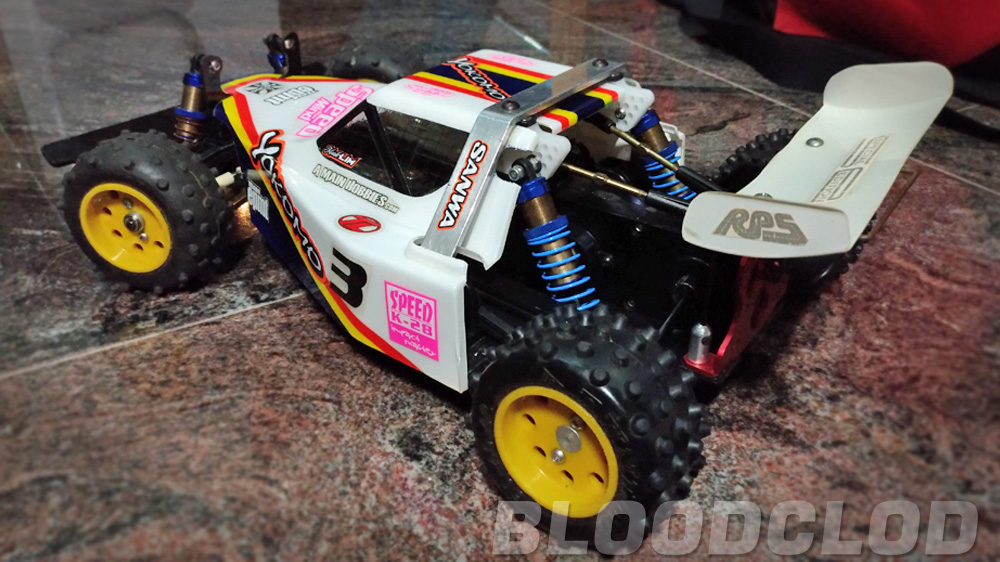

Here's the car after I replaced the rear monoshock with twin shocks in the rear, made a new shorty-capable battery holder and also a custom top-deck reinforcement plate. Also put on some parts I've collected over the years like the Lohas front and rear plates (red parts) and Pargu's aluminum front lower arm.
Carbon fiber goodness... I wonder if I went a little overboard. lol!
The top deck reinforcement is aimed at stiffening up the otherwise very flexible chassis.

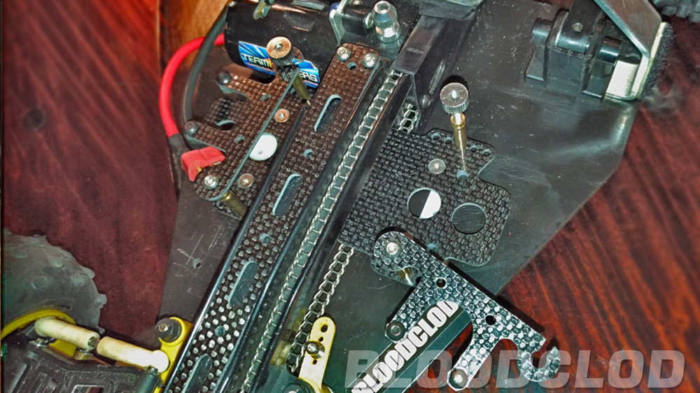

The battery mount was created to hold shorty lipos securely and without the need for any battery straps. There are actually multiple positions to shift the battery sideways - particularly to offset the weight of the motor on the right of the car. The battery retainers are designed for ease of use - the charging ports (including the balancing port) are all exposed so you can charge the battery in the car if needed but to remove it, all you need to do is loosen 2 thumbscrews without even removing them and the battery will slide right out.
Rear suspension mounts were designed to integrate to the vintage rollcage while being very rigid. Multiple holes allow for different shock configurations (also because I have no idea what works. lol!). It's not installed yet but the design will integrate with the little carbon fiber tab on the back of the gearbox to install turnbuckle stiffeners.
Sideview of the car. I've still to install the steering and also plan to design a front shock tower to run dual shocks up front. I know many guys feel the monoshock is part of the car's charm... but I think the performance of dual-shocks for a runner far outweights the look of the monoshock. We'll try and see. lol. I'm hoping the Pargu front arms are durable as the plastic stock ones are too flexible for my tastes.
I hope to update this as I add to the car. Any ideas on how to make this a better runner would be much appreciated. I'm considering the easiest way to add some width to the car... any suggestions?

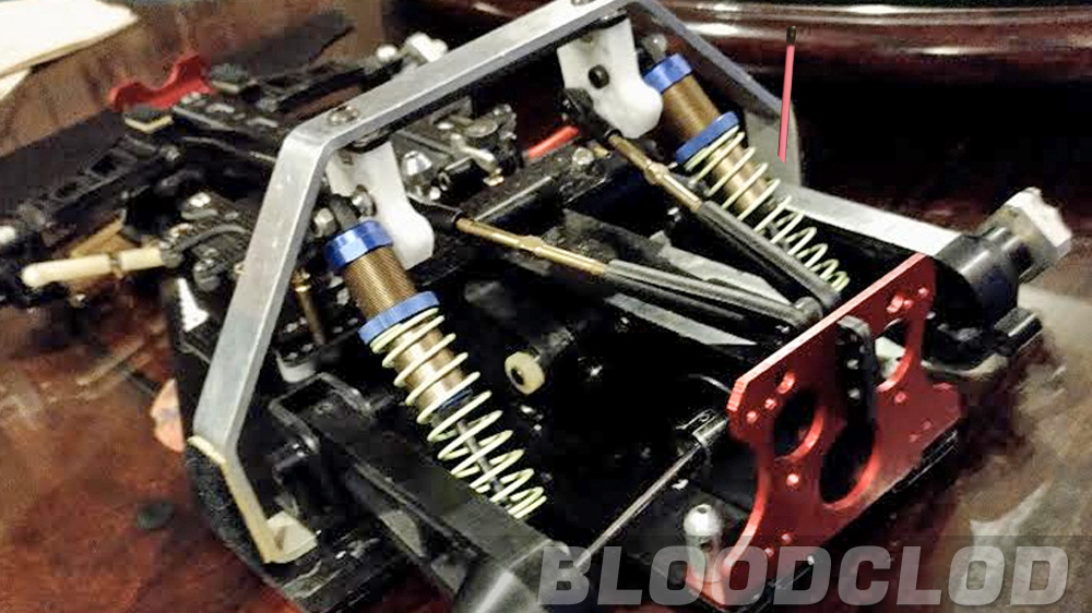

Meanwhile I popped by the hobby store and althought they didn't have any turnbuckles long enough for my purposes, they did have these cool looking long ball-ends which I think look very nice. They are installed on the rear and do a great job in supporting the rear end so the chassis is more rigid and the suspension compresses without tweaking the roll-cage.

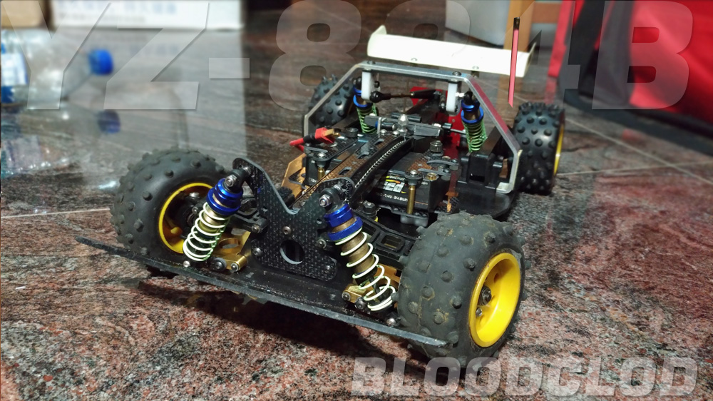

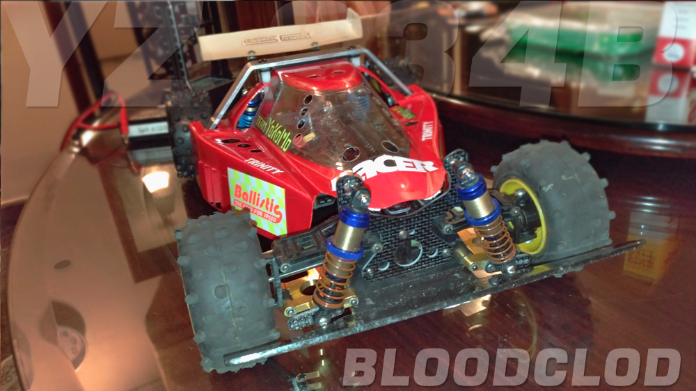

Designed and cut out a front shock tower - it was designed to fit modern 3" buggy shocks. Also widened the rear a tad.
Quite like how the car is turning out so far. The shocks definitely need some setup as the fronts are way too stiff and the rears too soft as it currently stands.
Was deciding whether to go with the "Y" shape design (which I went with) or a the "U" shape. I do like how this looks but I will have to consider how to fit the shell without losing too much of the look of the car. A "U" shape could allow the front of the shell to possibly still fit but it would weaken the tower. What do you guys think?

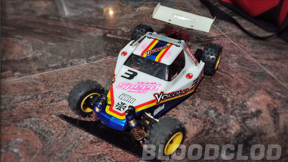

Tried another version of the front shock tower. Please forgive the very old basher body that came with this car when I bought it years ago. This new tower should allow the cover to be cut so that the front can still be retained to extend in front of the shock tower itself.
Which shape do you guys think looks better? :)

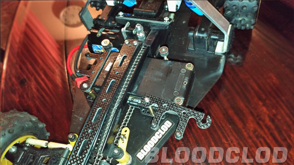

Here's a picture of the battery tray and how to remove the battery by just loosening the thumbscrew. This way there are no pieces to roll off the table and lose. lol!
With the battery removed you can see the different adjustment positions to offset the battery to the side to balance the left-right weight distribution of the car. Not sure how big a difference it makes on an old design like this but it looks cool.

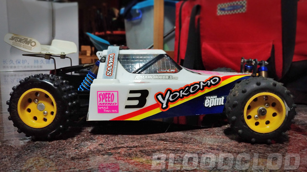

The suspension didn't feel right on the bench so I designed some new blocks for the rear to revise the geometry - particularly to stand the rear shocks more - and it was just so much better. With everything in the ballpark I carefully cut my shell to fit around the new suspension mounts front and rear and here's how she looks!
Here's the side view. I think all the 834B shells are amazing because they are so unique but this original shape will always be my favourite. I believe this is a Mr Lexan shell that I bought probably around 2010... awesome quality!

The second version front shock tower designed with a "U" shape allows the shell to fit over it so I don't have to cut the front off. Overall I think it really changes the look of the front end of the car.
Not that many guys will bother but this shows the reworked rear upper mounts that really transformed the rear suspension action. I think the turnbuckle supports do a nice job of filling up the space between the shell and the rear wing.
