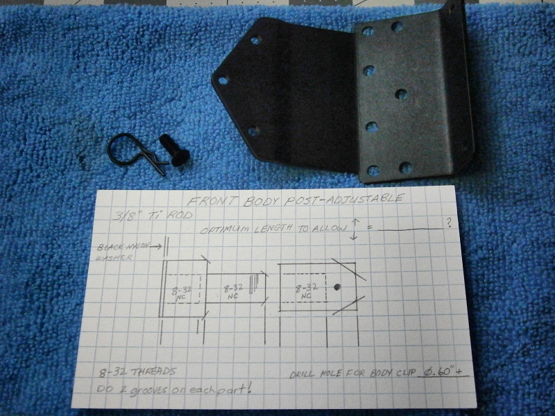

- NomadRacer
- Posts: 1467
- Has thanked: 83 times
- Been thanked: 77 times
Re: NomadRacer's Small Things
This is how I start out to make something, after the thought pops into my brain. Some things always change as I get into it!
Drawing not to scale
