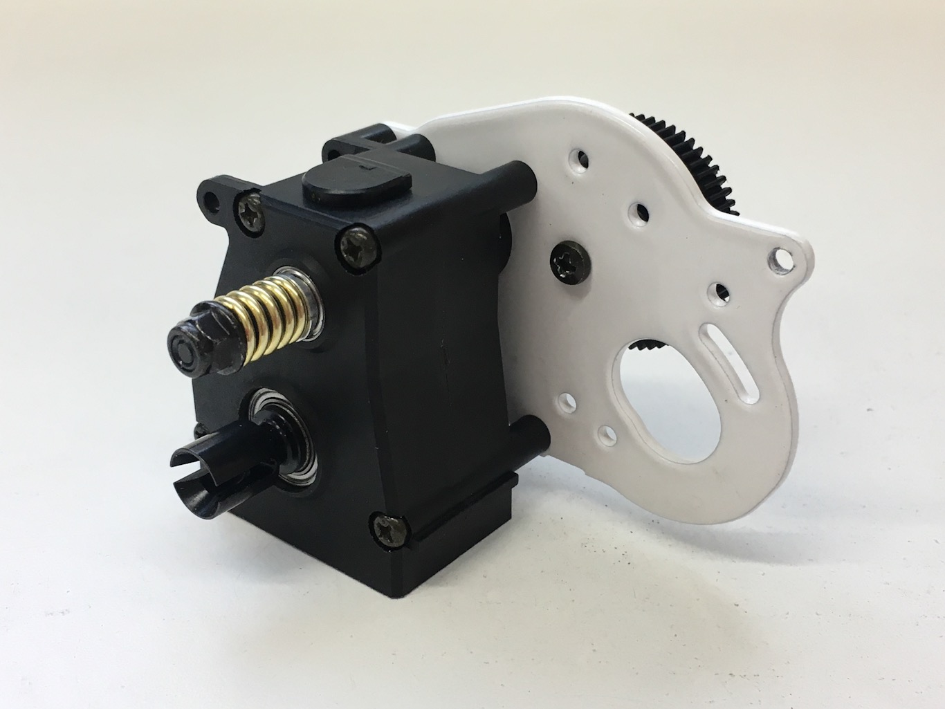

I’m too excited to keep it under wraps since today I finely got the transmission to work properly. Here it is so far:
Sweet slipper setup and 48-pitch gears!

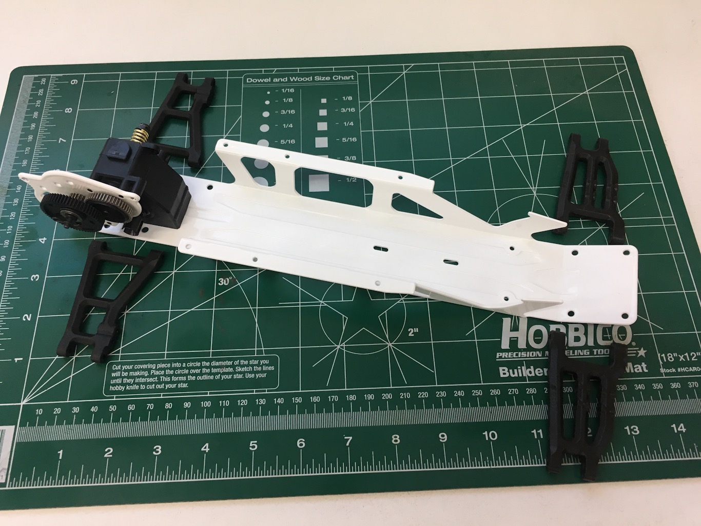

And here’s the chassis and arms I’ll be using:

sweet! how did you get the re-re optima internals into the original ultima gearbox?

It took a lot of fiddling. The most difficult part was that the fact that the Ultima case takes 8x14x4 bearings and the re-release Optima takes 10x15x4 bearings. My first thought was to have the diff halves milled down. Then I was looking around on the AVID website and found 10x15x4 flanged bearings. So I drilled out the case and loaded the new bearings from the inside. I also had to make some upper shaft shims. I was able to find some perfect aluminum shaft at the hardware store that has a 5mm ID. I had to shorten a couple of the Optima shims as well. Open up the upper bearing holes so that the spacer/shims ride on the actual bearings, etc. Quite a bit of fiddling and fitting but I’m happy with how it came out.
Aluminum shaft and factory unflanged (not usable) bearings pictured

Soon. Gomachv is designing some cool shock towers and upper plate for me.

You're going to have to move the tower a good 5mm forward, and the shocks behind it if you're serious about using those rear arms.

Perhaps. I was inspired with an idea after looking at these freakishly long RPM arm shock mounts. We’ll see how it plays out. I’m not a huge fan of shocks behind shock towers on vintage cars but if that’s what it takes, I’ll burn that bridge when I get there.
