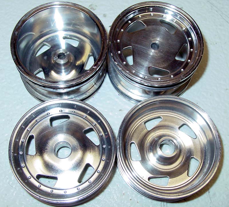

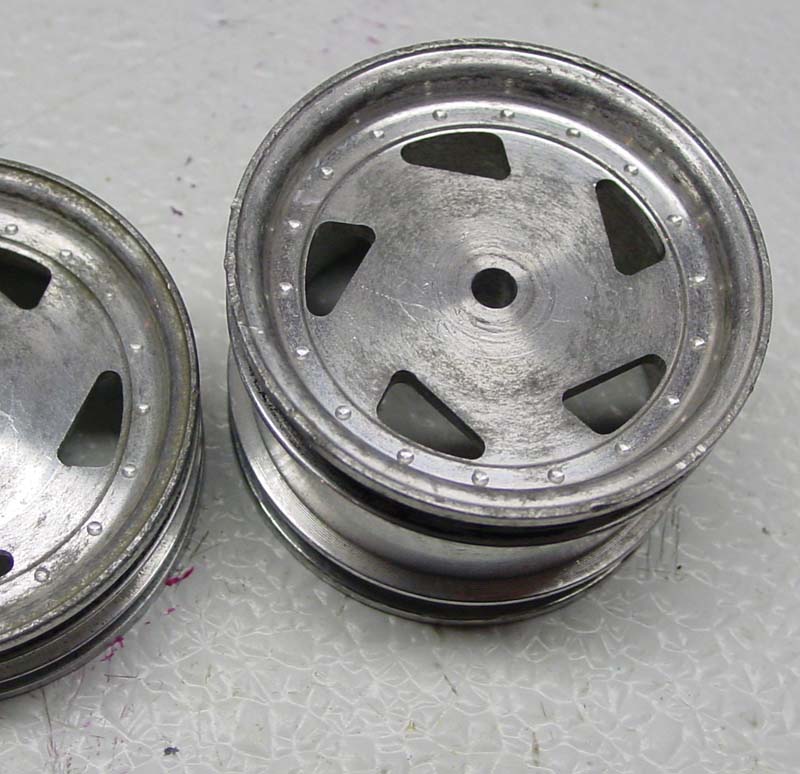

I got a set of these wheels with an ebay jrx-2 purchase.
They can use some help, but I am not sure what the best process is for refinishing them.
Any advice would be appreciated. I have a dremel, and a drill press but no bench grinder/polisher.
These have already been soaked and scrubbed to get any dirt and grime off.
Thanks!

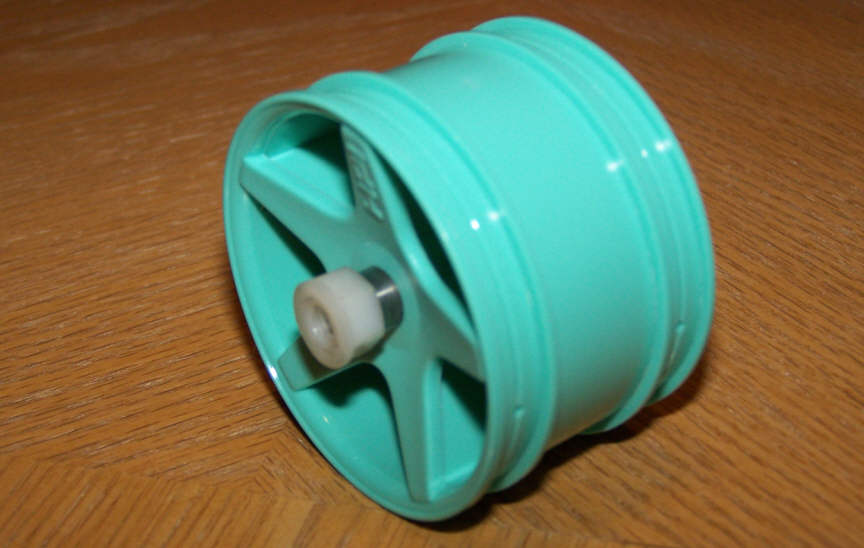

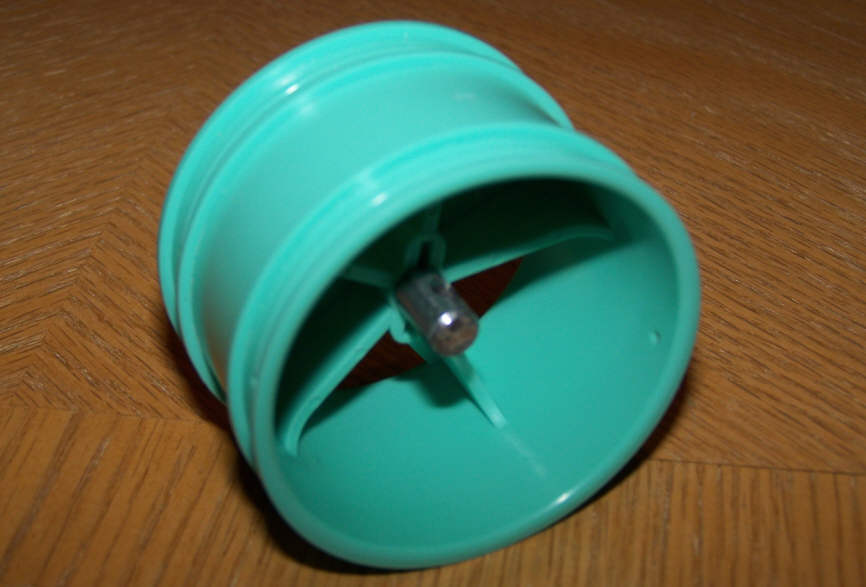

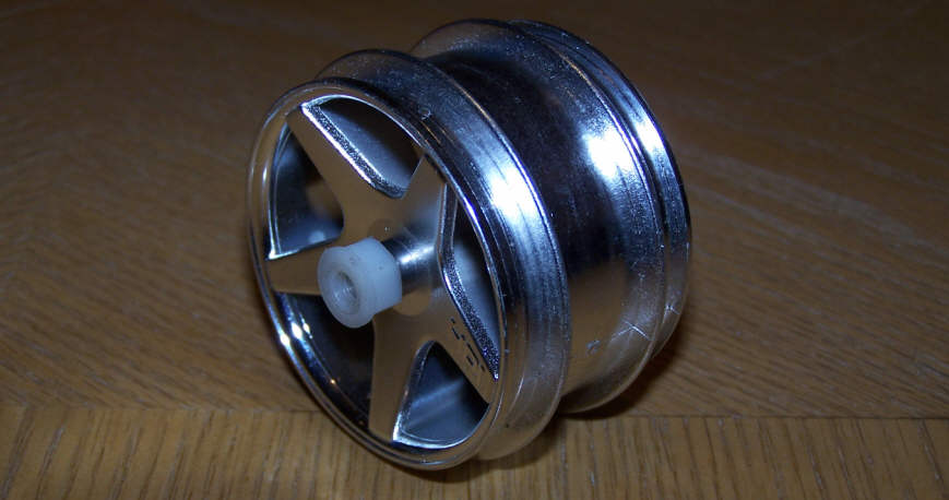

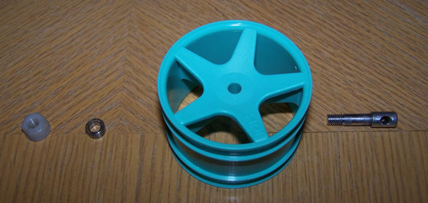

I've added some pictures:
1. The parts: 2. Assembled (front veiw): 2a. Assembled (rear view)...insert the axle into the drill chuck: 3. After some polishing, your finished product!!

I would never have thought of using steel wool. I used an old hex-shank rc-10 front axle as the nut is 4-40 so it takes up less room and allowed more surface to be finished, the little that could not be reached is under the larger losi wheel nuts anyway.
They are not perfect but they look good.
I was not sure what grade to use so I bought 0,2-0,3-0, and 4-0.
I started with 2-0 and worked up to 4-0. the wheels have a satin like finish. The wool makes a mess, but does a good job in not much time. If you are looking for a mirror-reflective shine, than this is probably only the beginning of the process, but I like the current state and am not going to polish any further.
I did use a file lightly touched to all the edges to clean up some of the road rash.
Thanks a lot highwayracer for the suggestion.
