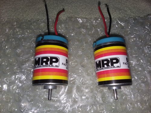

MRP 552 Factory Team set up
I have a pair of these that were included when I bought the Jomac, 12E, and Delta spyder car lot.
They look mint and unused to me.
I posted in the "what is it thread" about them:
https://www.rc10talk.com/viewtopic.php?f=33&t=14461&start=3870#p483079
You can see on the next page after my post where Phin gave me some info on them.
I sent you a PM
Dave

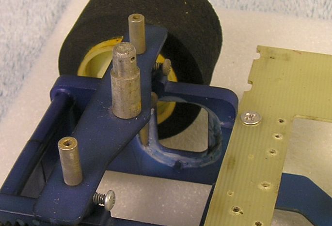

If you want to install an open endbell motor (ie Yokomo/Kyosho from the later 83/84 era) you need to butcher the left side motor pod:
This poor thing got raced to death....

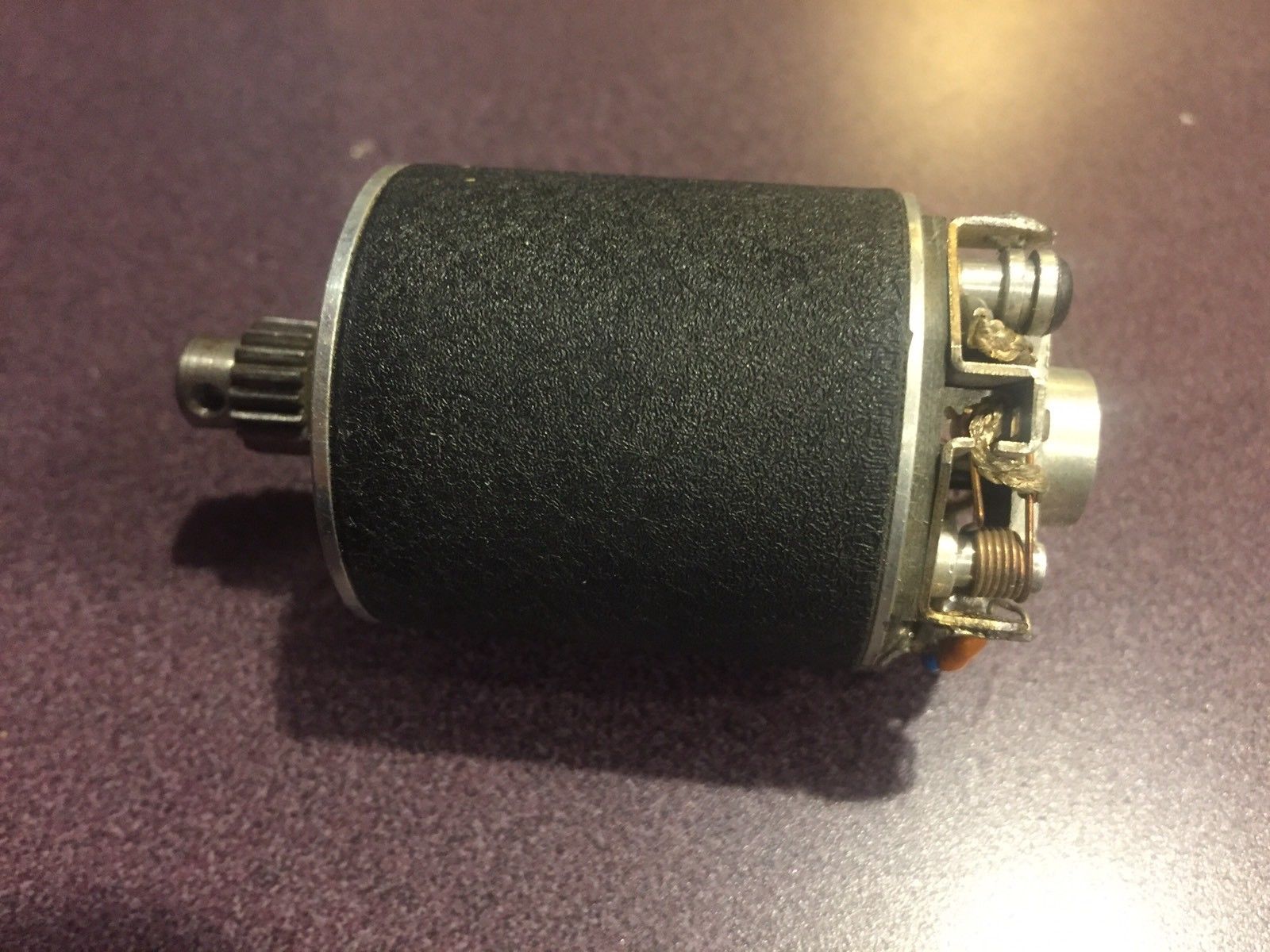

I really don’t like parting with my motors but if you get stuck I do have a couple leisure 05 motors new in pack and I would be willing to get rid of one
Same motor as in pic

Is is a checkpoint? or an early fantom? The brush holders are not the slot car style. No decal or markings.....prototype?
- Posts: 12336
- Has thanked: 1129 times
- Been thanked: 3919 times
Re: Early 80's 1/12th motor
Fantom must have got their cans from the same place
I thought I remembered seeing some checkpoint with the large hoods as well, but maybe not.
I’m not sure how to tell the difference 100%, but the armature night hold that info
Very cool motors. Wish I never got rid of mine back in the day

I always heard Jim sold Fantom the cans and machined bits, but who knows. In either event I hope that motor looks at home in the lightning. Still need an ESC for it.....

This is a Fantom motor. Jim sold some cans to Fantom but they used the usual brush setup, not the slot brushes. So it´s easy to decide if it´s a Checkpoint or a Fantom.
