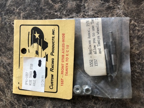

The CRP axles were for the old e-clip style knuckles. And, I think they were all 5mm axles for use with Tamiya wheels.

I dug around and found the CRP axles. Damn metric crap!
I suppose a guy could have the axle end turned down to work with the proper bearing.

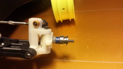

I'd need to find the pics in photobucket, download them and re-upload them here. Using a combo of different sized bearings, you CAN use the B4 front wheels on the original length front axles.

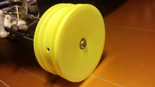

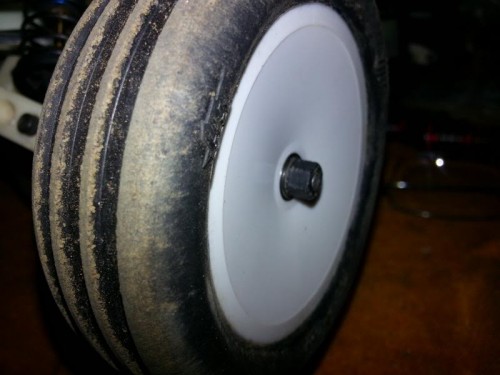

These are not my pics, but I had saved them: (I dont quite remember who did this originally)

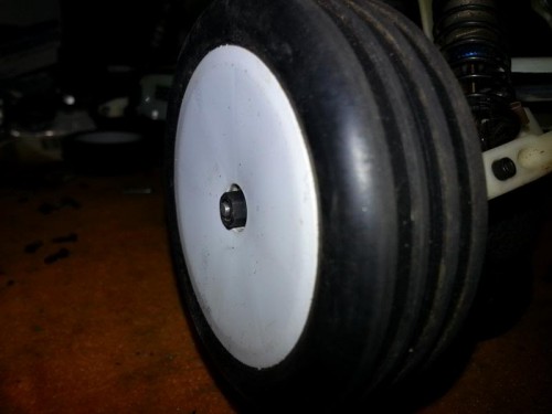

Here was my results - Duratrax wheel on one side, B4 on the other:
