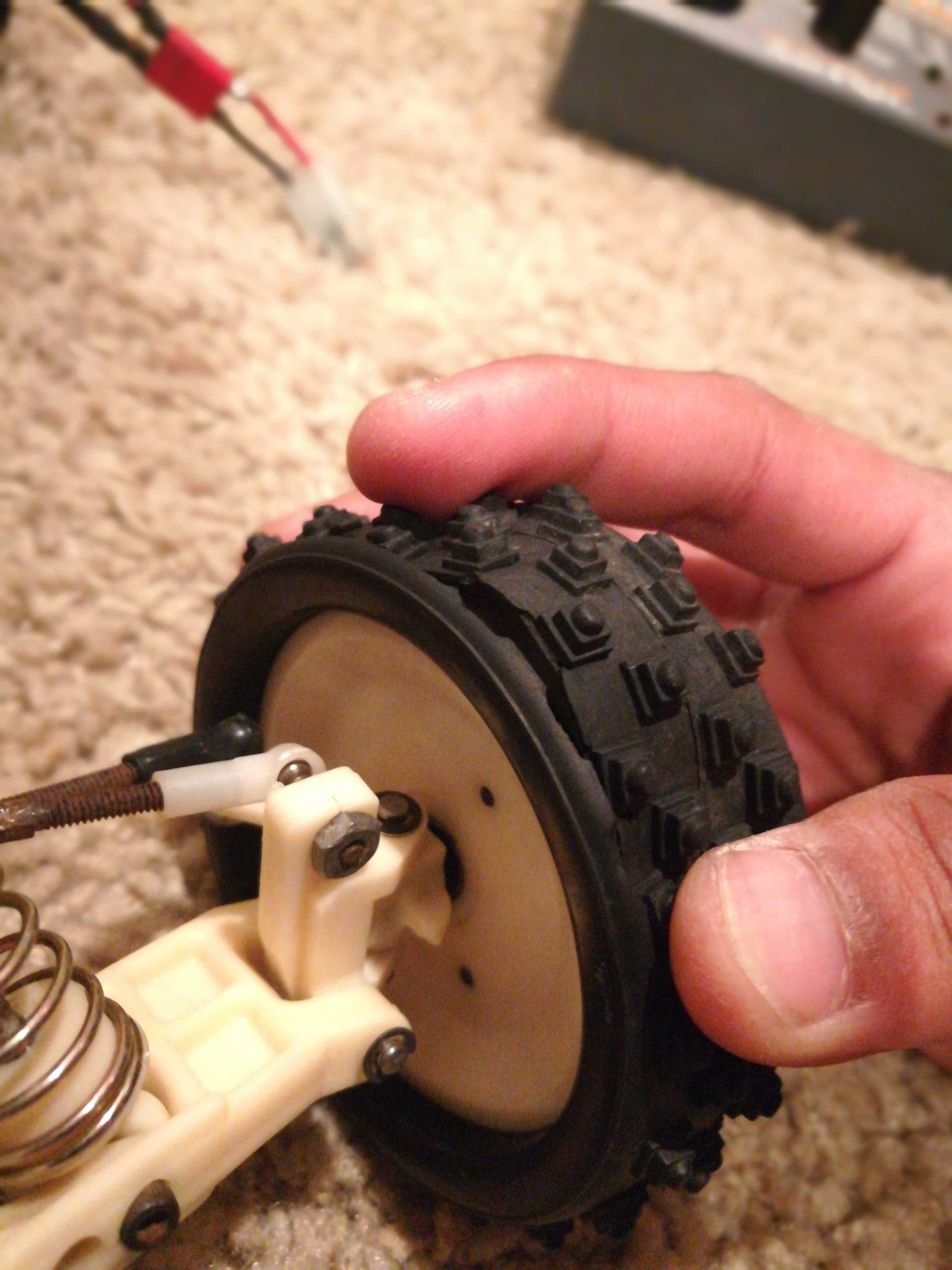

Post by Vodzilla »

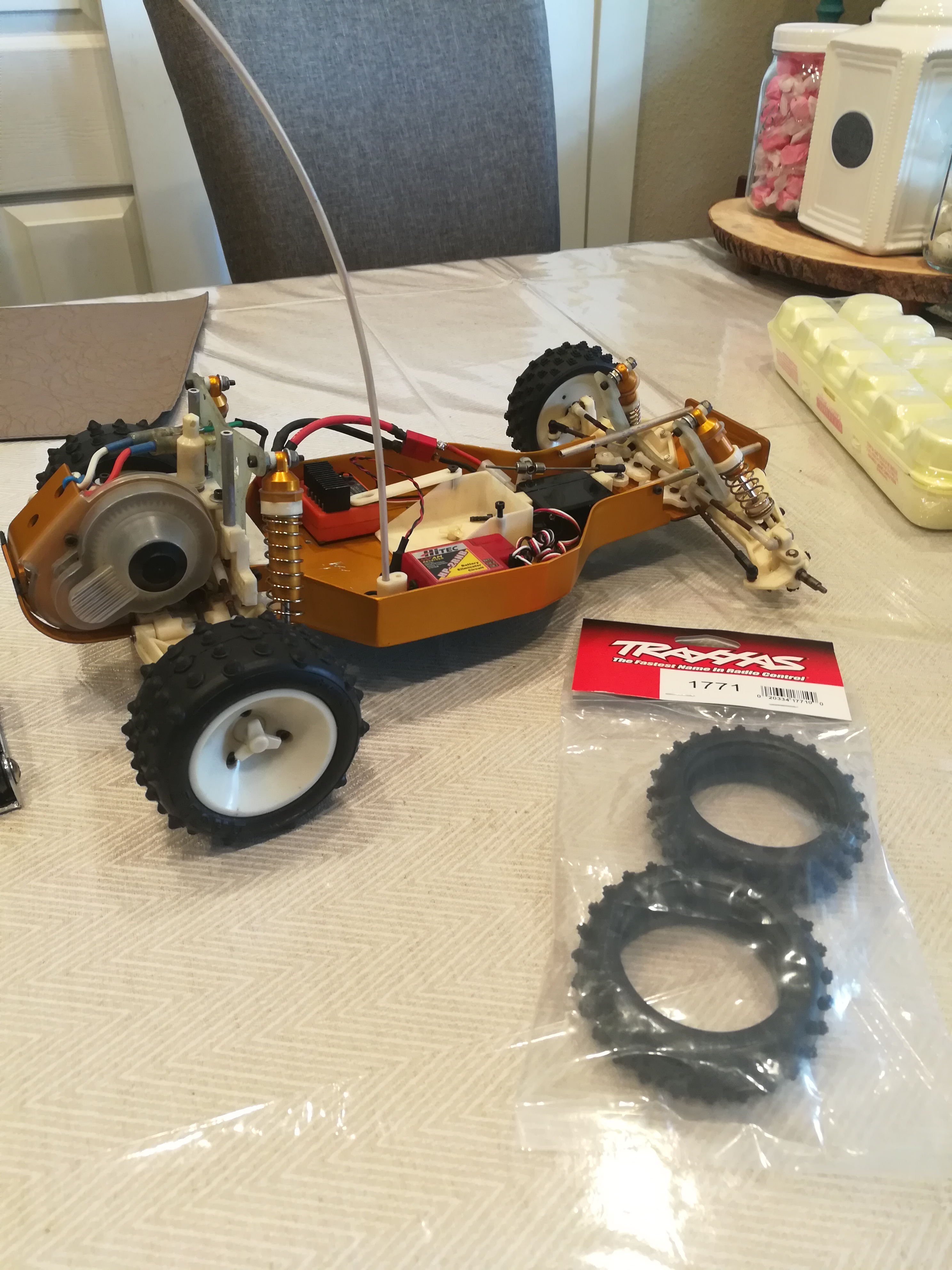

For now, I ordered the front tires you linked. The rear ones you linked, I will order in the future as needed. Thanks for sharing what would work for my current wheels. Attached is a picture showing my rear wheel, I believe they are 3-piece.

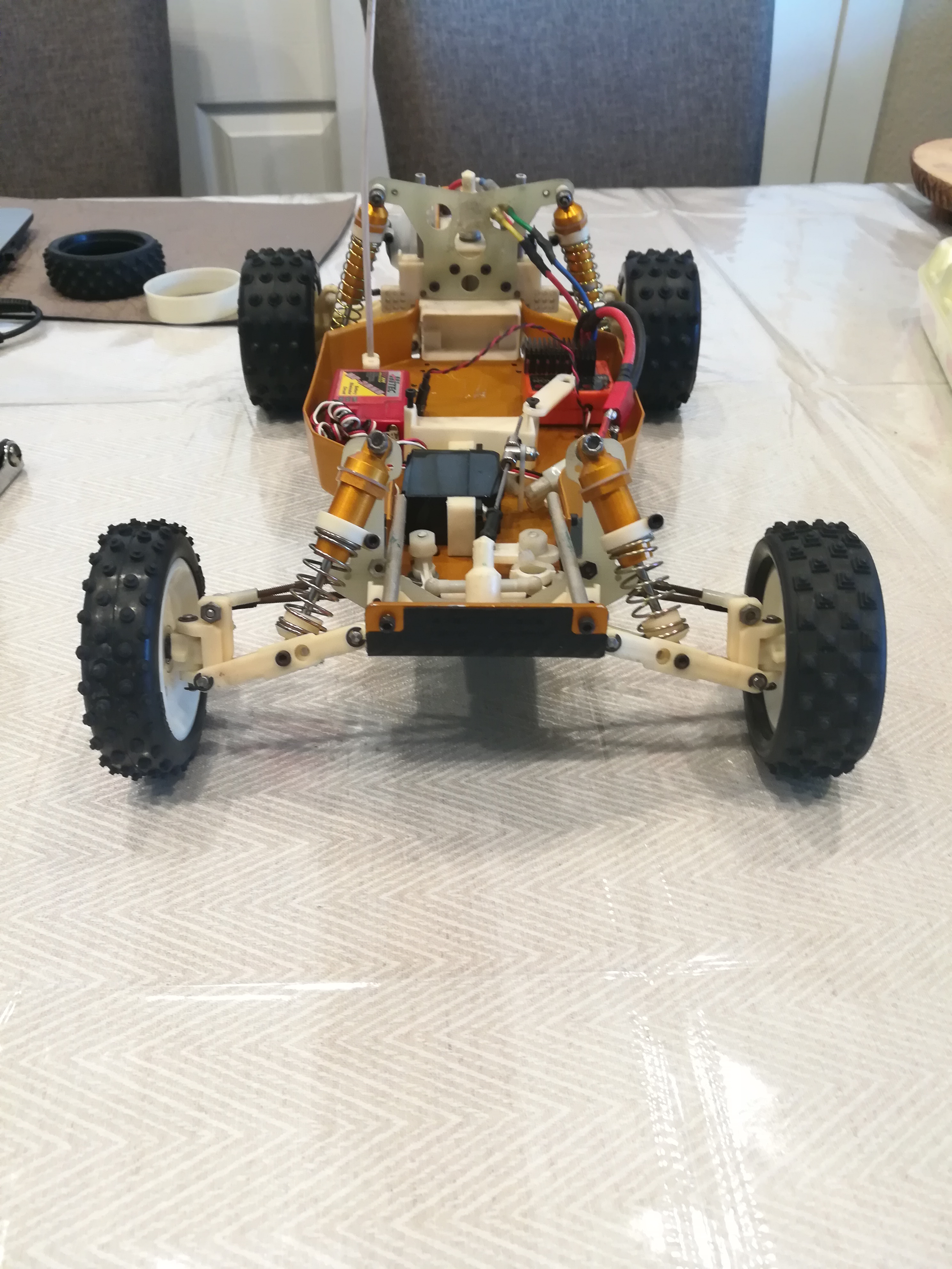

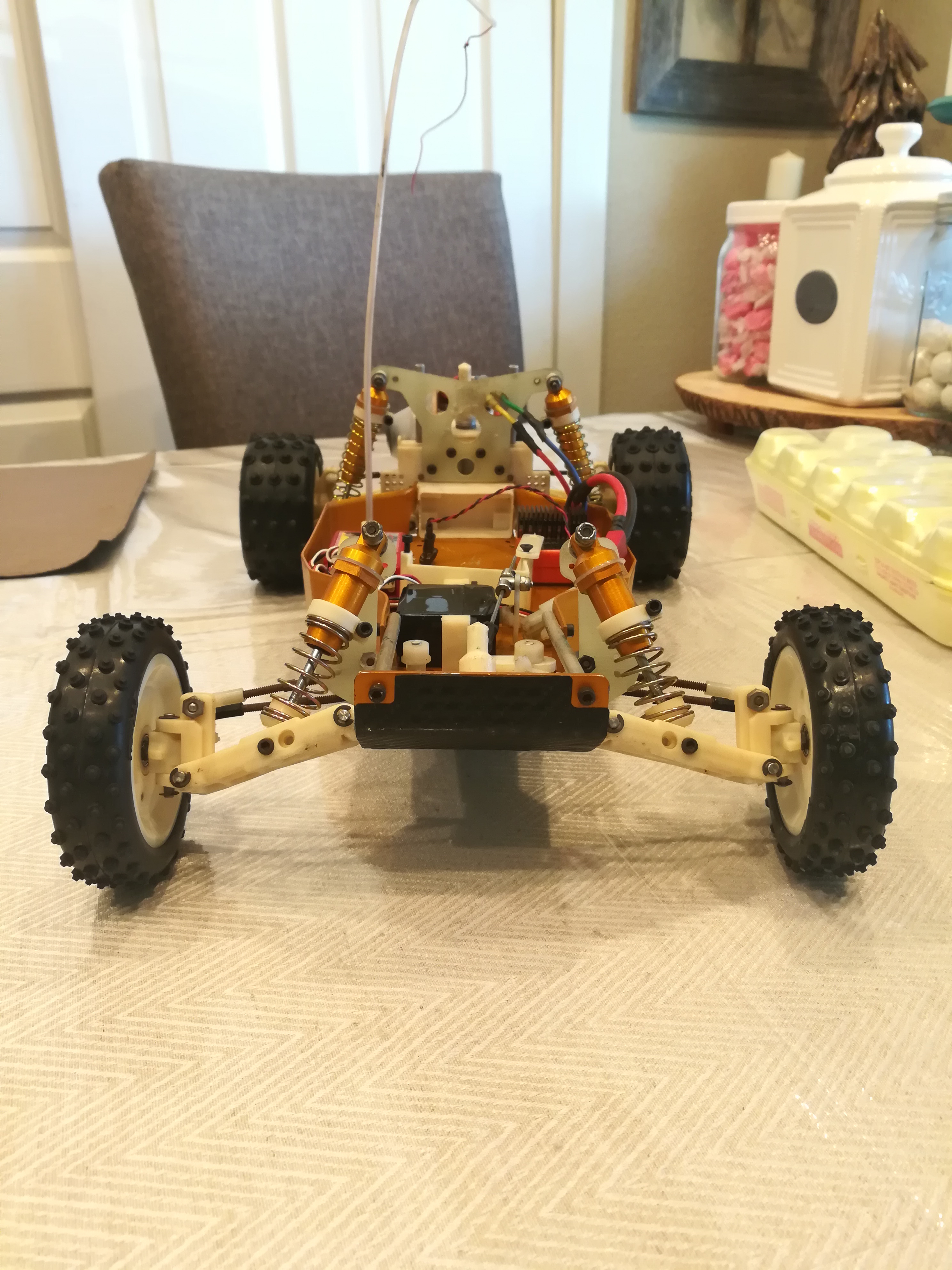

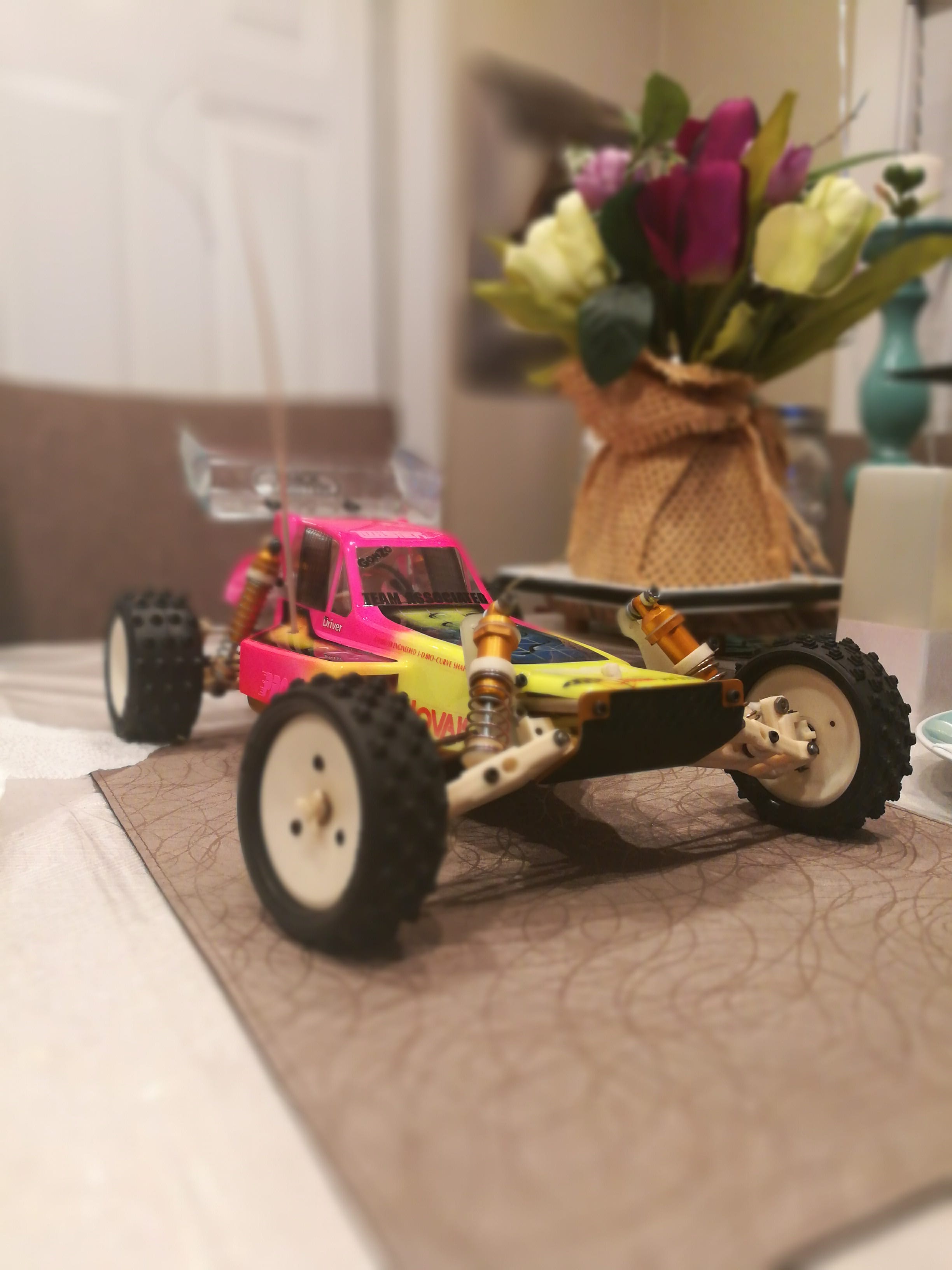

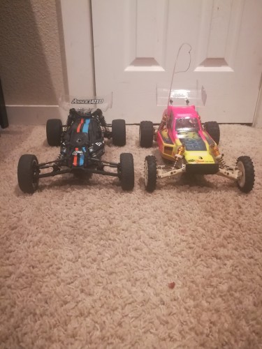

Update:
Traxxas front tires arrived today!
Traxxas on the left
Traxxas on the left
Traxxas left and right
XLR8
Posts: 3321
Has thanked: 1688 times
Been thanked: 1183 times
Re: RC10CE runner tires
Post by XLR8 »
Wow, that was quick. Did you get those from the local hobby shop? Either way, looking good.
Vodzilla
Posts: 23
Joined: Wed Apr 25, 2018 5:55 am
Location: Santa Ana, California
Post by Vodzilla »
XLR8 wrote: Fri Apr 27, 2018 4:39 pm Wow, that was quick. Did you get those from the local hobby shop? Either way, looking good.
I actually ordered them April 25, 2018 Wednesday, a day before I made this thread. A Facebook friend advised me that it'll fit my fronts. I guess I was looking for more options, hence this thread. :lol:
XLR8
Posts: 3321
Post by XLR8 »
Those Schumacher 4-row rear tires scr8p recommended should work well for you. I've found them to be a good all-around dirt and short grass tire (perfect for the backyard). Schumacher also made a "Mini Spike 15x12" (#2002378) that I've found works great on my dirt track when it has become dusty dry-slick. Unfortunately these have been discontinued but you can find them occasionally posted for sale on ebay.
I should also mention that since you're planning to run your car, you probably should replace the plastic knock-off wheel nuts with proper metal nylock nuts. The knock-offs are meant for display; they won't secure the wheel under power.
