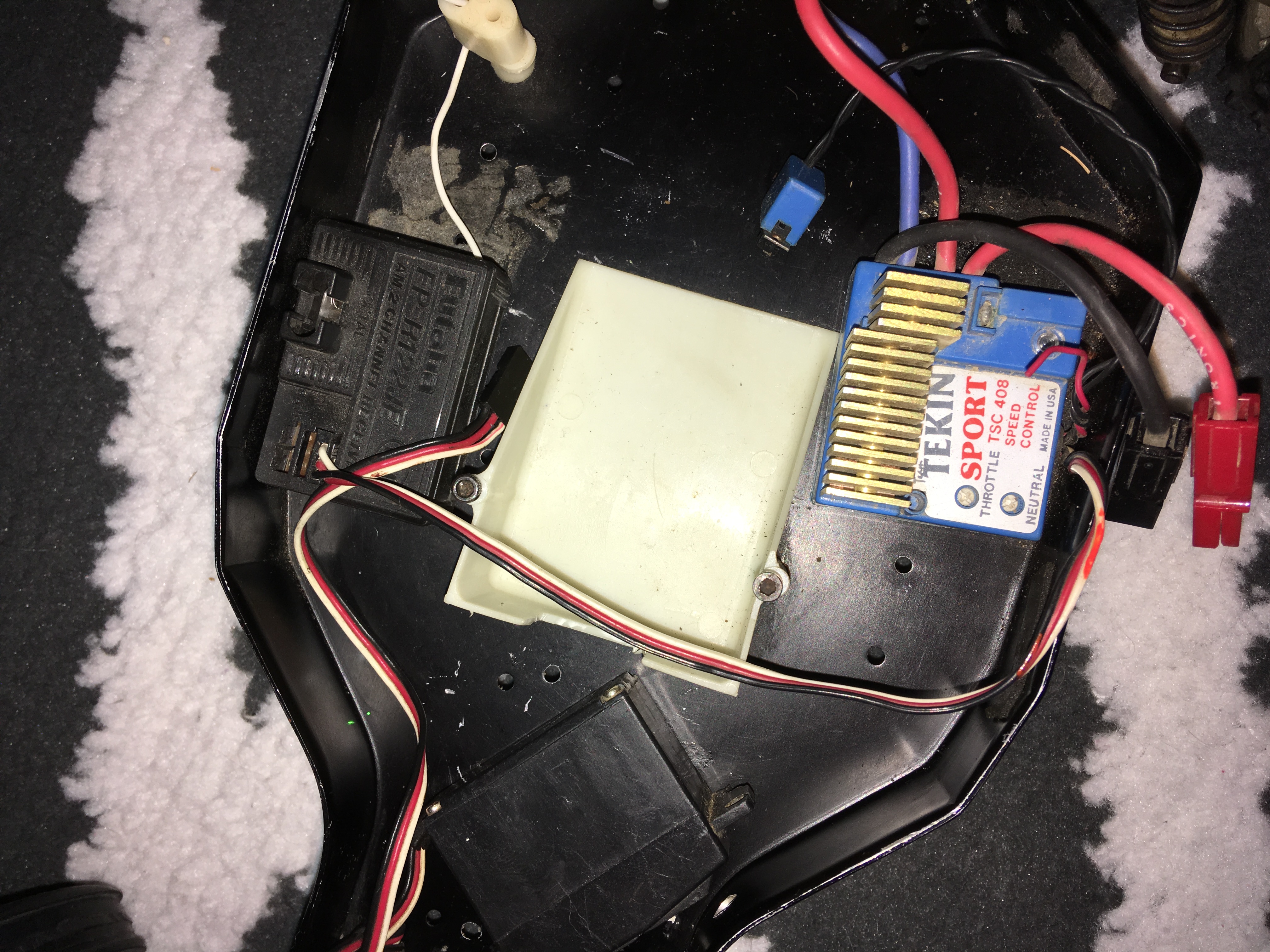

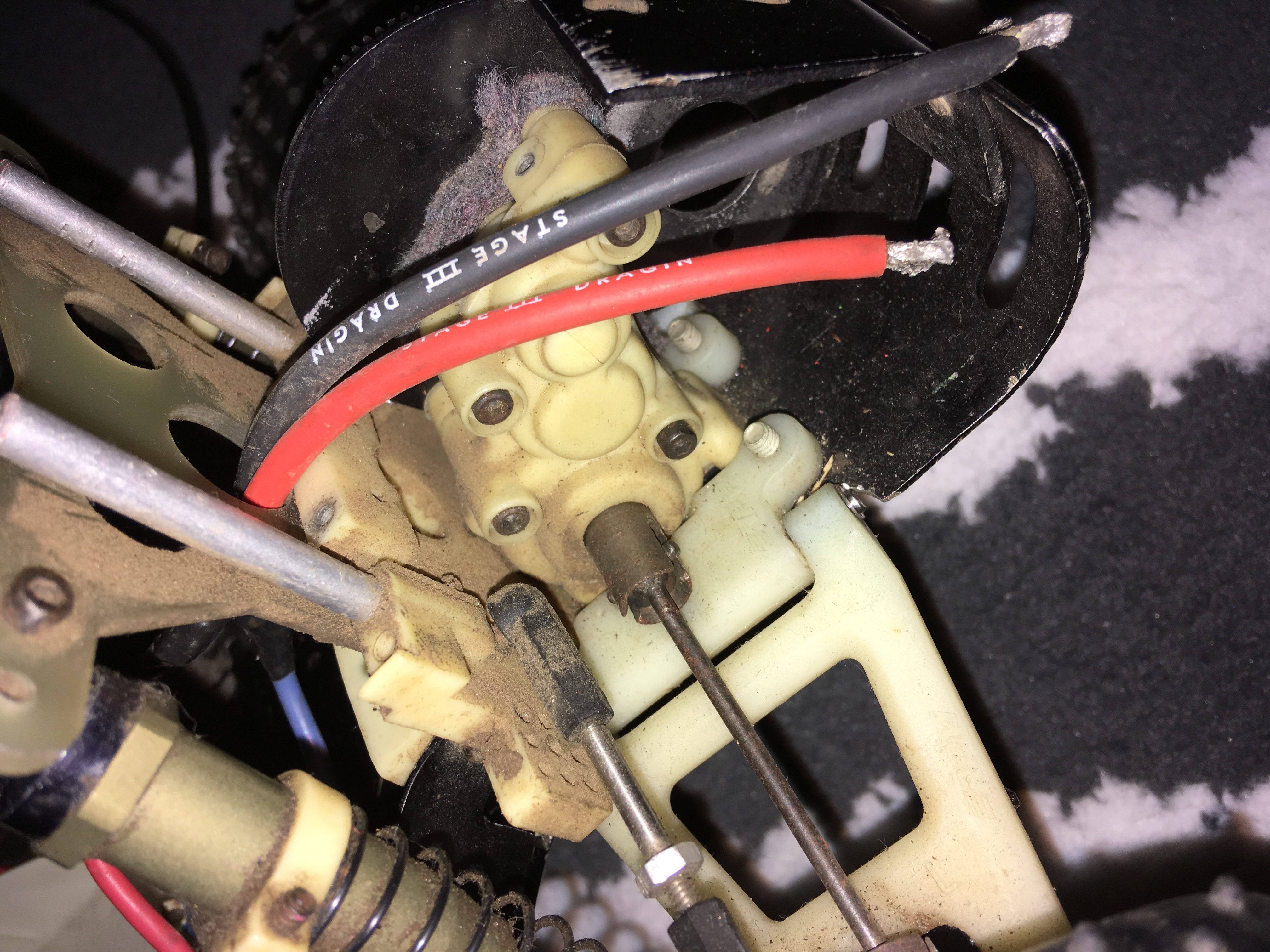

Any way to just replace the old transmission w something newer? Check out my speed control, I think it’s for stock motors..what’s a decent brushed motor I could use w this? Is my tranny stealth?

No need to change anything. The trans is a stealth design and is pretty much the same as anything newer from associated. It can handle a good amount of power.

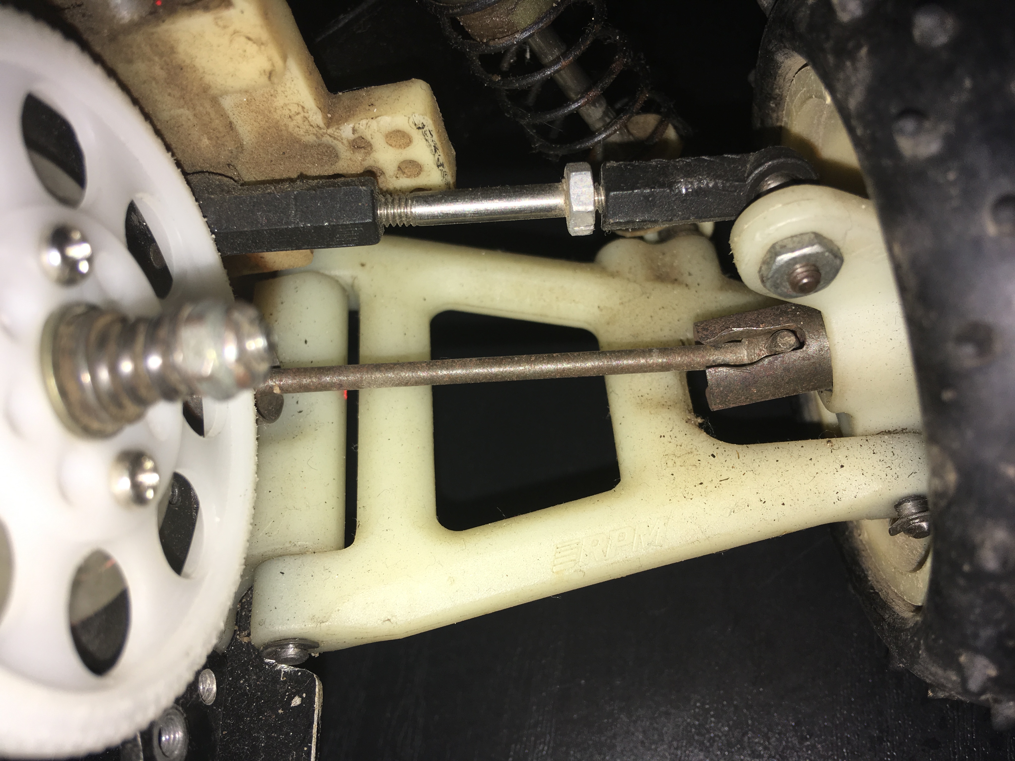

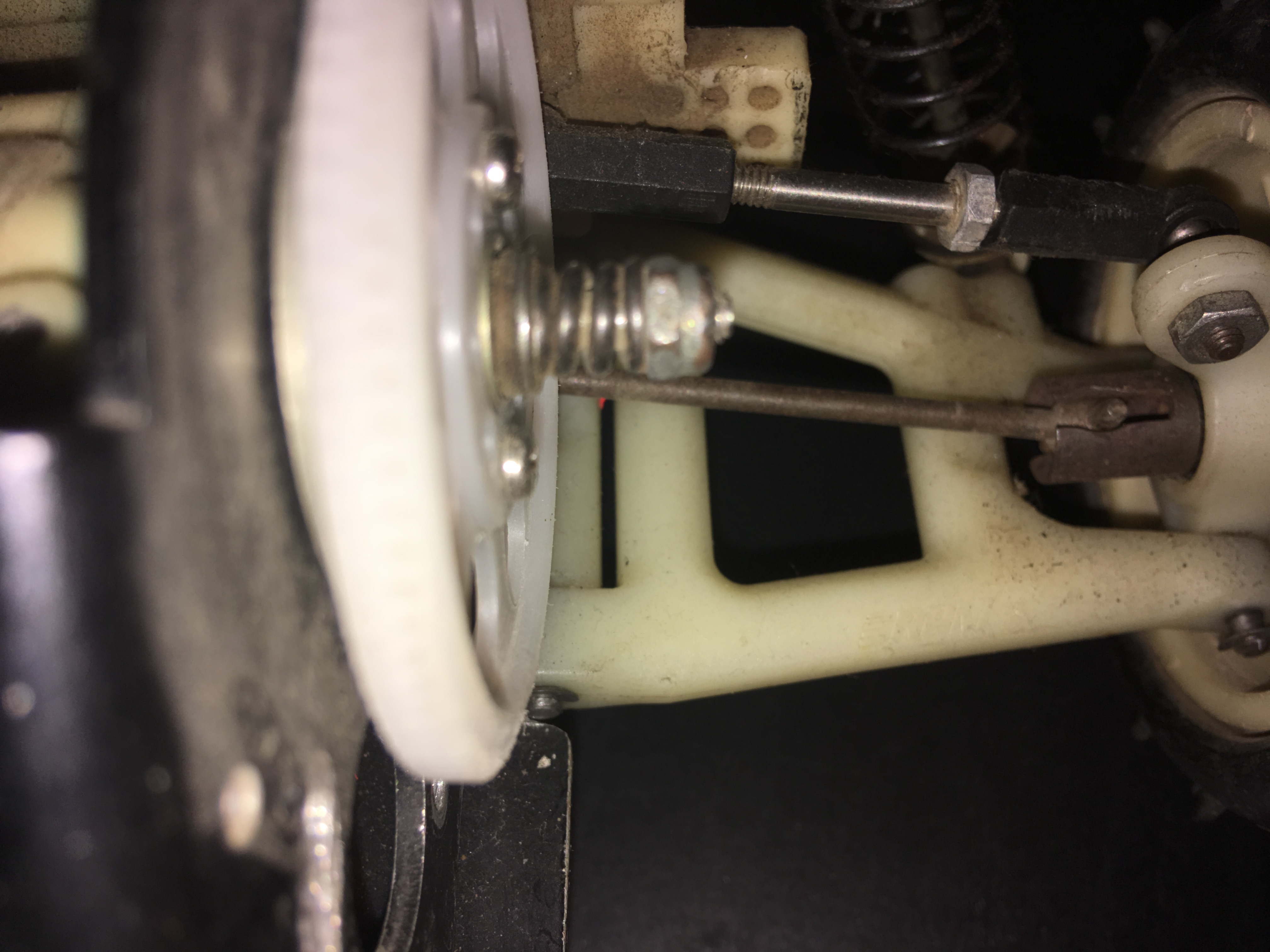

Your particular car however looking at the picture has been modified for rpm 'worlds' arms. They are no longer available, but you can find replacements but they won't look the same.

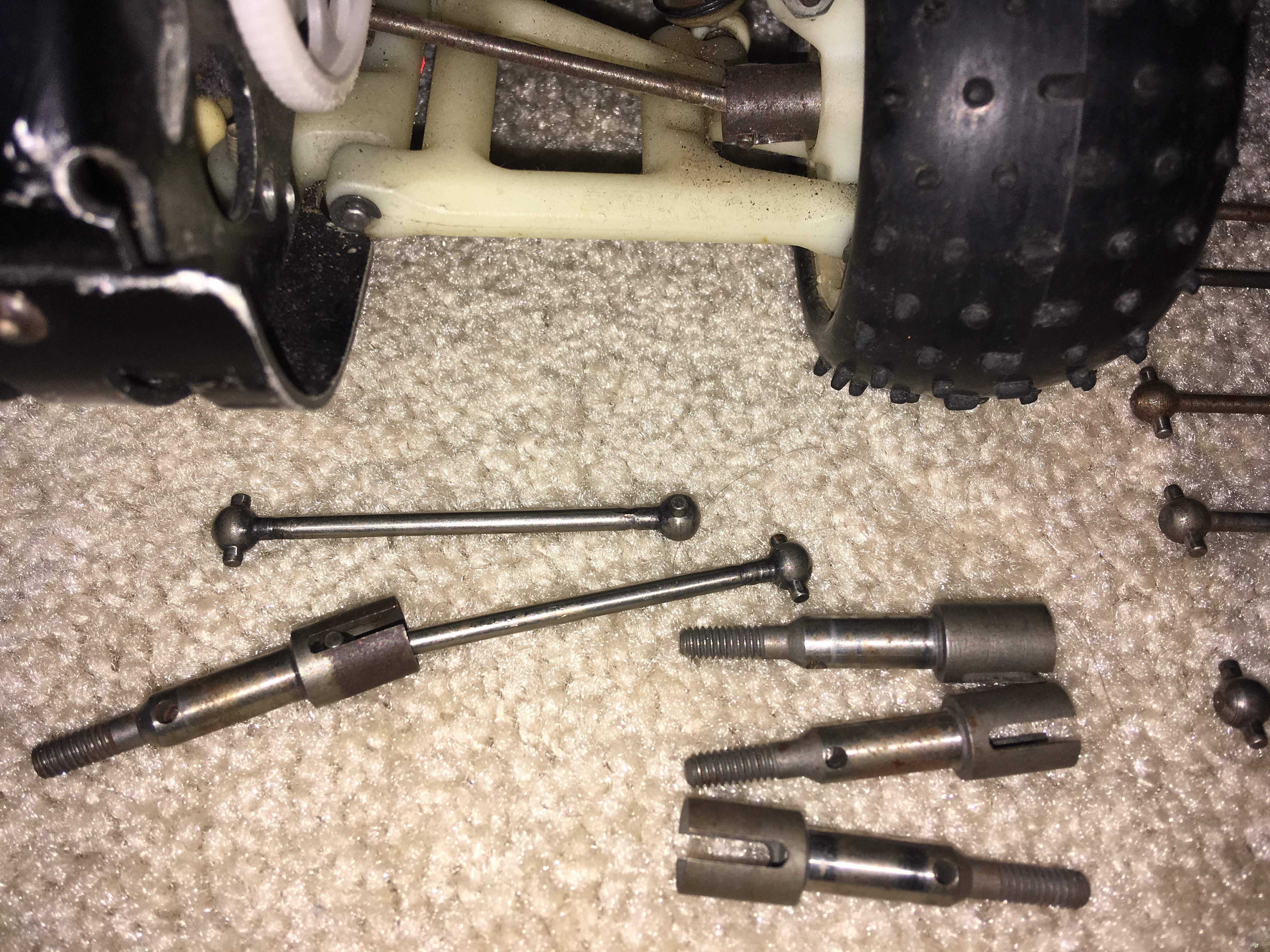

Are these dog bones/axles in need of replacement? I see they have chewed up the end...

Yes, I would replace the rear axles on this car, you can still use them as is but your suspension is probably not working as it should. This should do:
https://www.towerhobbies.com/cgi-bin/wti0001p?&I=LXDWJJ&P=7
if you don't already have 3/16 wheels, this will allow you to use these:
https://www.towerhobbies.com/cgi-bin/wti0001p?&I=LXDWJL&P=7
there are whites, too.

Can I replace w these parts? Should I make the changeover? I do have quite a few tires and rims for the car.
