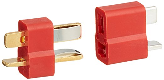

Can someone recommend me a type of connector between my esc and motor? Right now it’s a straight wire soldiered on both ends. I’d like a connection in the middle so I can more easily change/swap motors. Seen it before just don’t know what the connection is called. Thanks.

The most common connector for a brushed motor would be a Dean's Ultra Plug.

can i use this on battery connections? lipo and nimah.NomadRacer wrote: ↑Fri Jun 15, 2018 6:38 am The most common connector for a brushed motor would be a Dean's Ultra Plug.

You can use the Dean's plug for both esc and motor. Install the female on the battery pack end! Further, install the connections so you can't plug them in to the wrong thing.

Any reason I couldnt use bullet style connectors instead of the dean style plug? The cheap esc i just purchased has bullet connectors already on it.NomadRacer wrote: ↑Sun Jun 17, 2018 3:41 pm The 6614 black idler gears are a graphite composition, much stronger than the original/stock idlers.

Why do the female ends go on battery pack? Is that just industry standard to match chargers?NomadRacer wrote: ↑Sun Jun 17, 2018 3:41 pm
Makes no difference for motor to esc?

industry standard but for a real reason. if the male connector is on the pack, on a deans connector, the pins are exposed. easy to short=very very BAD for battery/connector/and whatever gets stuck between the pins.
it makes sense to orient the speed controller output the same way, this way the esc can't short the outputs and be damaged, and as a plus, if you wanted to run a motor test, you can plug it directly into a pack.
