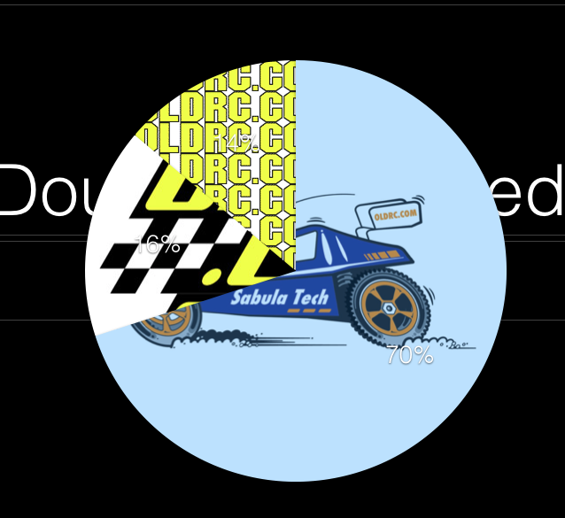

Here is what can do in Keynote if you have any recent Apple product. It is real easy.
