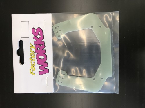

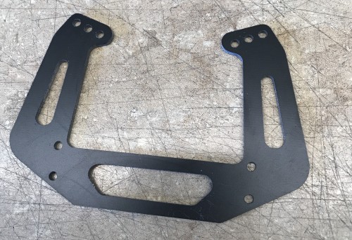

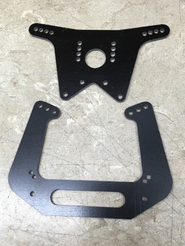

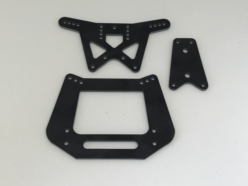

We (Factory Works) sell several styles of front and rear towers including big bore specific towers.

Website is outdated. We sell on eBay or direct (direct is cheaper for you- no eBay fees)
Fronts only would be $16.50 shipped outside eBay, and the front and rear sets would be $26.50 shipped. You can send me a pm here for details. We send a paypal invoice. I’m out until Wednesday on vacation so replies might take a bit longer than usual
