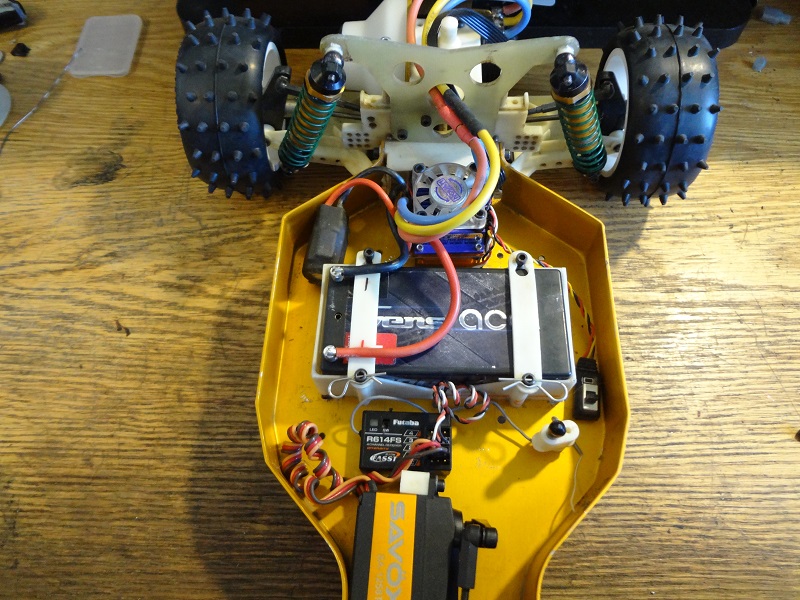

This is how I have mine setup. One of the advantages of using this configuration is that you have the option of moving your battery forward or back to get your car properly balanced.

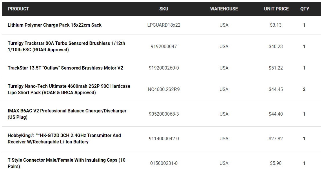

Well, I took what was here and did some research and hopefully I got the right stuff to put 3/16 CVA's in. I'll let you guys know in a week or two. Got some titanium turnbuckles too because I have no self control apparently.
edit: so here's where I'm at, ha. White parts to be cleaned/maybe whitened, shocks being torn down (one was empty...) tub ready to be de-taped.
