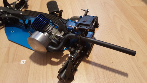

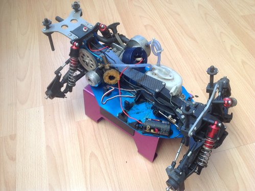

A recent addition, a Nitro 4x4. Bosscat based with engine and clutch from Nitro 10 range.
Doesn't seem to be much info on these, so I thought it might be useful to document restoration . My plan is to rebuild it as a Panther buggy with a view to gently running it.

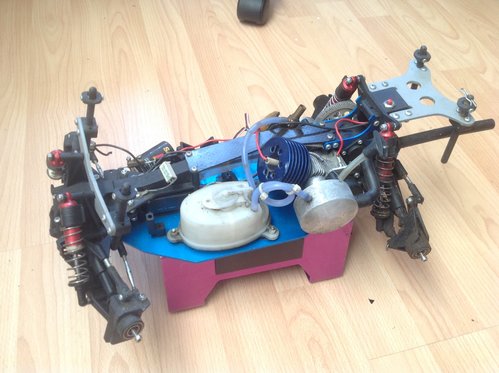

Prior to strip, fairly complete including truck body mounts. Has clearly had an impact to the front, but damage is restricted to transmission housings common to Bosscat.

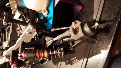

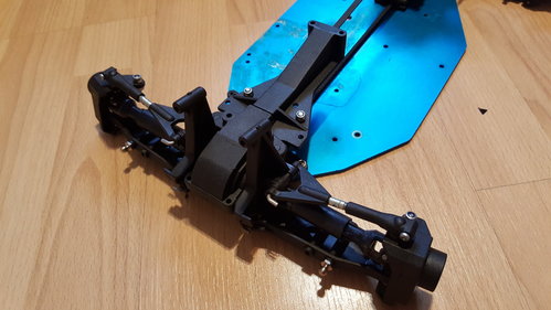

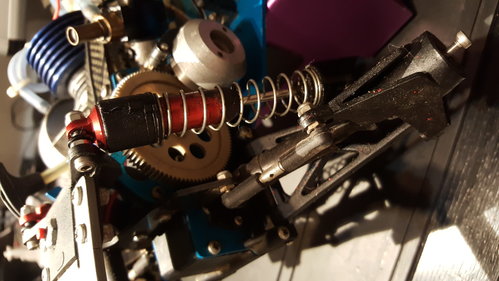

A few more photos of strip down - a surprising number of unique parts

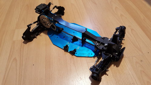

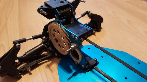

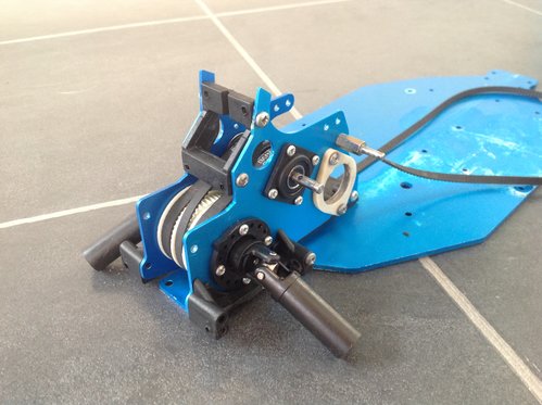

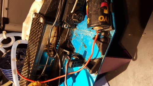

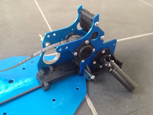

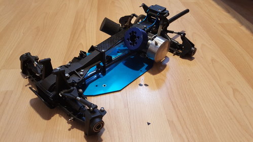

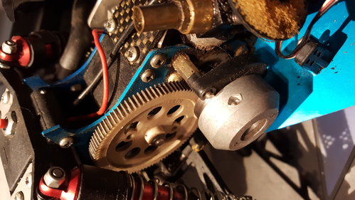

Small amount of progress made, everything cleaned up and rear transmission built up with fresh belts This is predominantly as the Bosscat including Pro diff but features a few unique parts. During stripdown it became clear that chassis has had a whack on the back at some stage which has bent tabs on top of side plates. These will be left as-is for fear of them coming off if I try to bend stretched material back into position and won't effect running. Discolouration to pan due to a battery leak is also mildly irritating but will be largely unseen once electrics are back in, so I'm not letting it bother me too much.

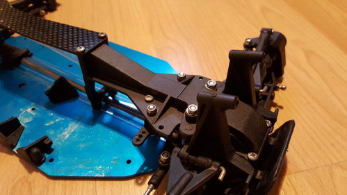

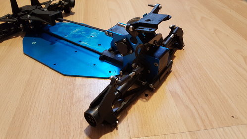

Front transmission and suspension in place.

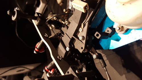

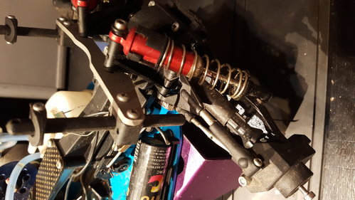

Belt covers and top deck in place. Lower belt cover is as Bosscat, so a replacement from Penguin RC was used. Upper one is unique so fragile original was cleaned up and refitted. Note unusual front moulding and dog leg upper deck to clear engine.

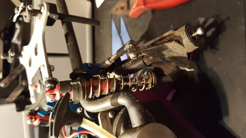

Engine back in along with clutch and exhaust. A very tight fit that required removal of carburetor - I suspect that Schumacher originally fitted it through transmission much earlier during original assembly.

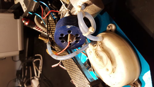

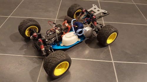

Good progress yesterday, electrics in, shocks rebuilt and on and all plumbed up. Throttle linkage still needs some work to remove unwanted slop, but otherwise ok.
....and for the 1st time in 20-odd years it's had a tank of fuel through it. Took some starting on a cold English evening with a bit of help from offboard glowplug warmer but otherwise runs fairly well.
