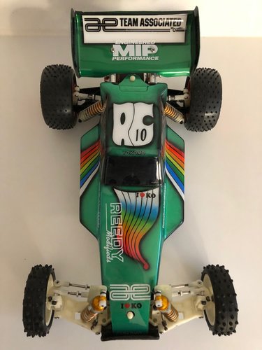

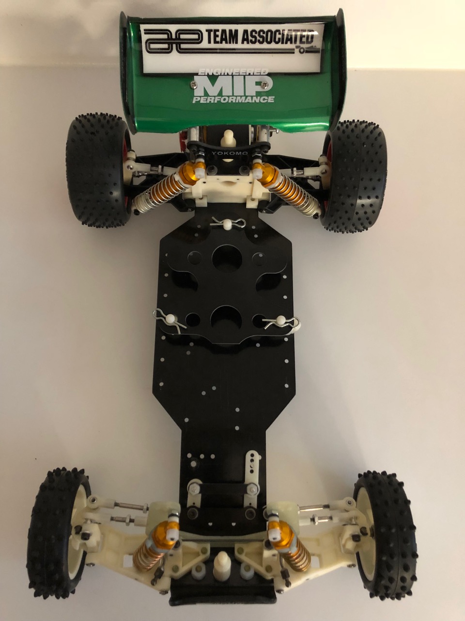

Hello everyone, still working on this one regarding the chassis and front stabilizer but so far so good.
Any help / tips appreciated to get the chassis cutouts done.

Great looking car Phoenix!
As far as cutting out the battery slots. I would draw them on CAD then print to size, glue the paper onto the chassis with a kiddies glue stick, and cut out carefully. Probably not a good idea to use a dremel. I would drill inside the lines probably corners first then a few larger holes so that I could get a coping saw in there. Remeber to use a face mask as carbon fibre is not good for your health.

Re: RC10 GX Masami 1989 Style
Nice job
Let me know if you need an exact drawing for the battery slots.
Thanks that would be cool ! I also found someone to mill it based on that.
