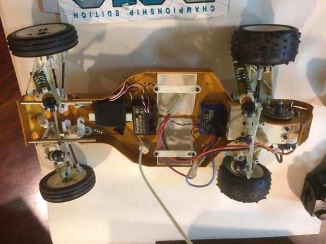

So I finally got my first RC10 from ebay. Excited to get back into this hobby after over 20 years and share it with my kids. From looking at the guides here I think this is quite a late Stealth Build?
Oddly the car itself is slightly different from the instructions, not sure if they were actually for a different model or what.
Posts: 12335
Been thanked: 3917 times
Re: Got my first RC10 - time for a re-build
The image link you posted takes you to a gallery instead of a single pic. I’ll just post them here for everyone to make it easier.
It’s a later CE, but not very late as they went to black parts at the end.

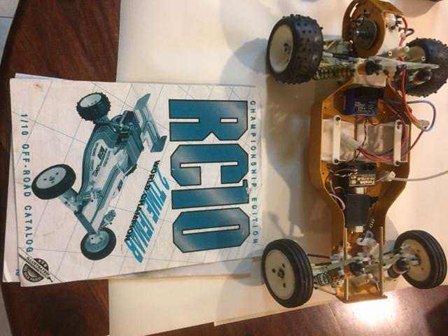

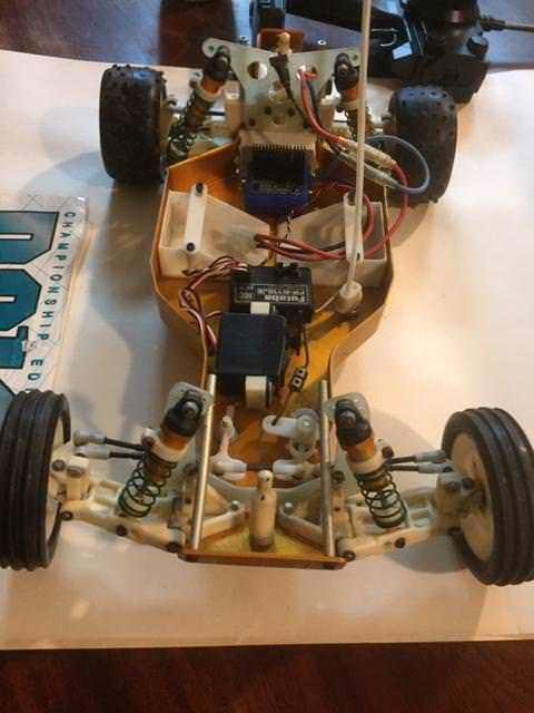

Starting to clean this thing up. It came with Receiver, Speed controller and Servo, I’ve also bought an old Futaba controller so I hope I can get it all working.

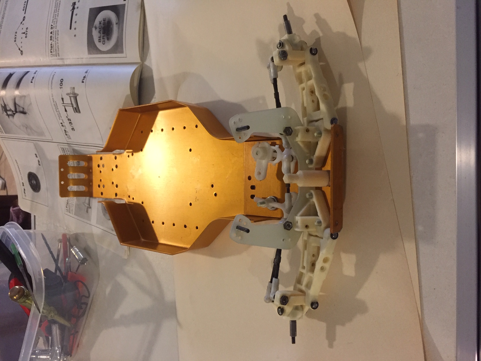

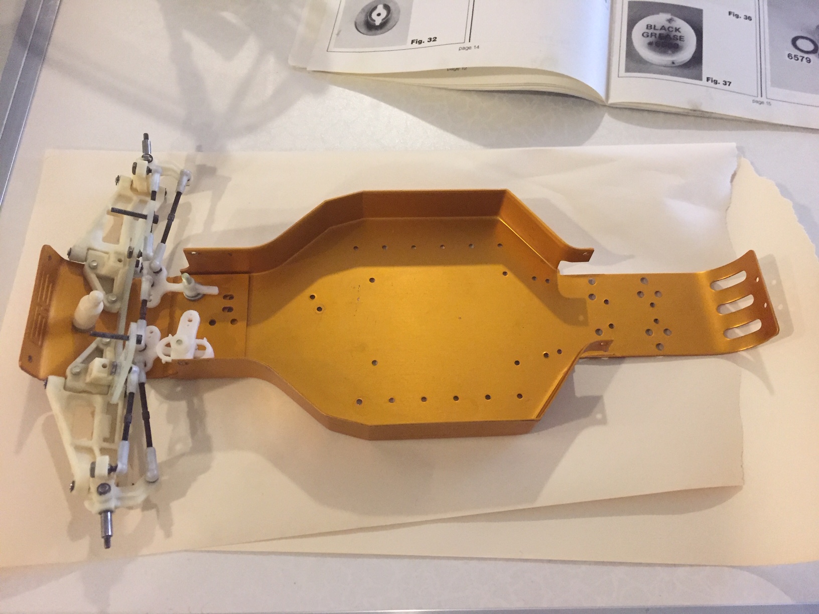

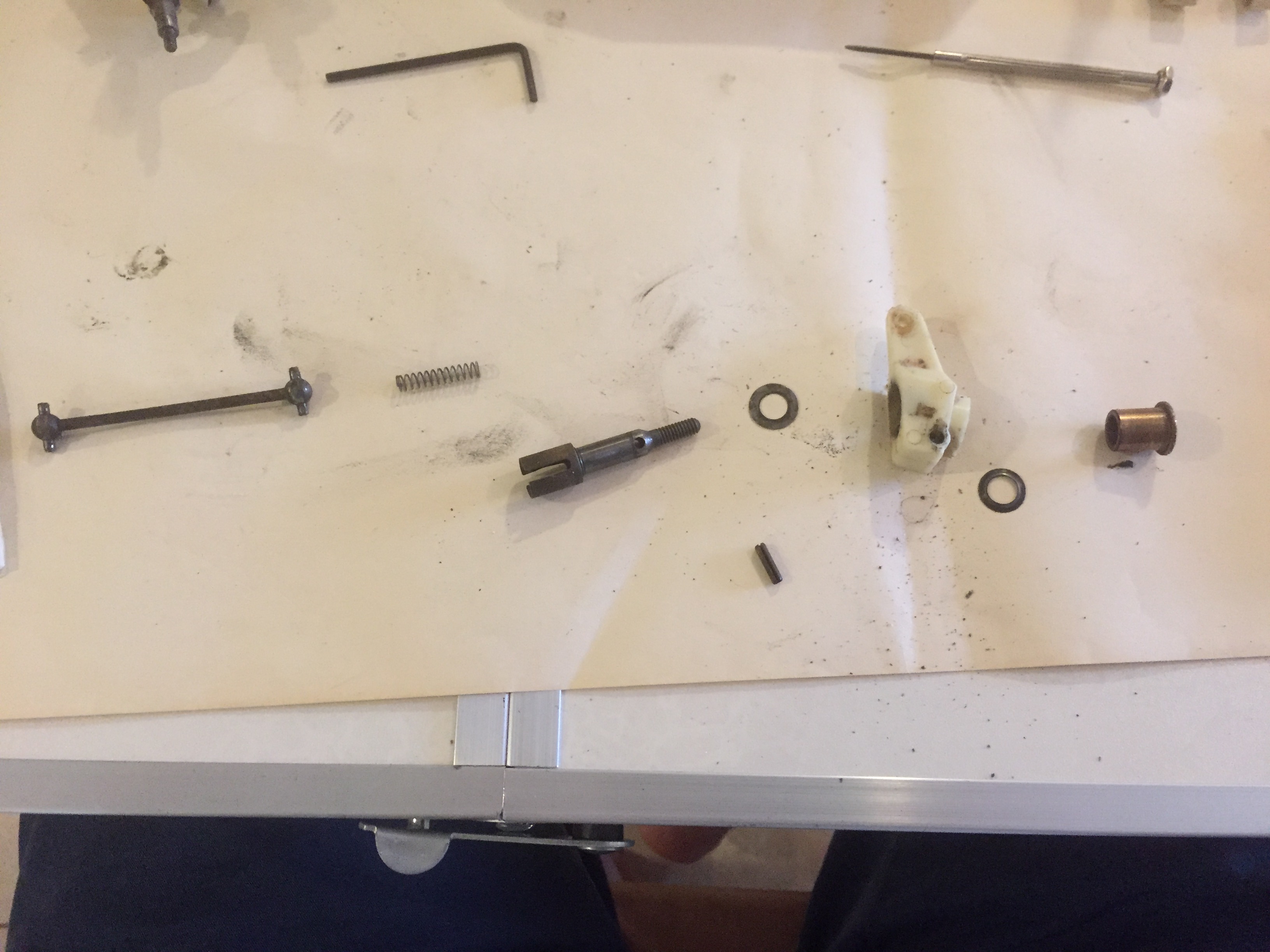

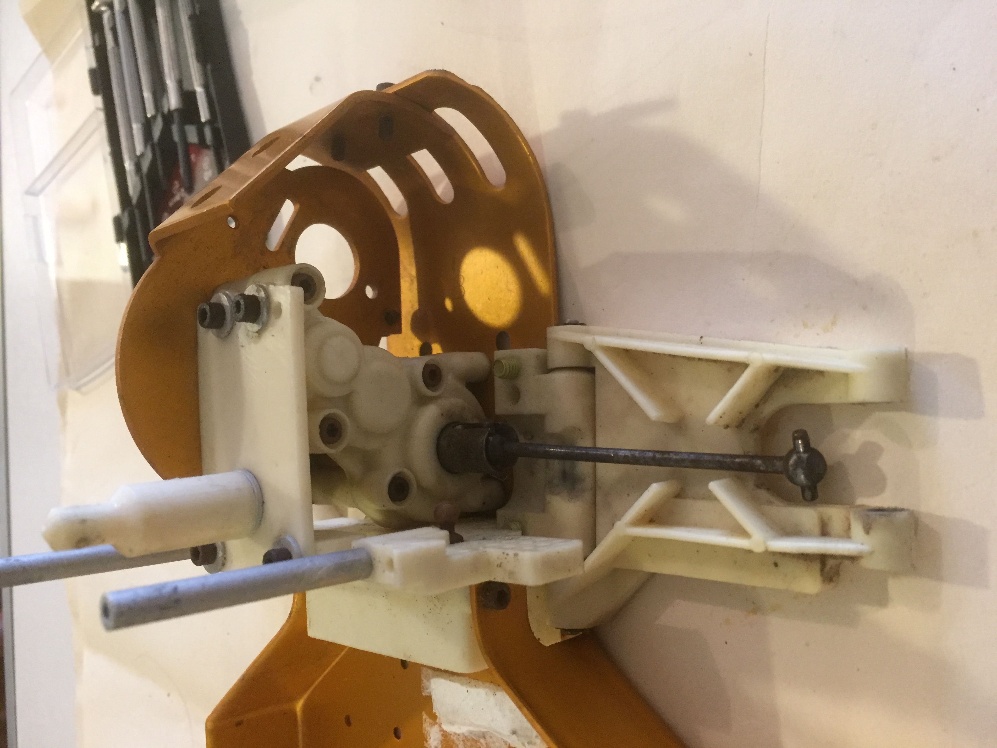

The rear axle mechanism is different to the instructions. Not sure if this was an upgrade or what. Anyway took some pics to make sure I can rebuild it.

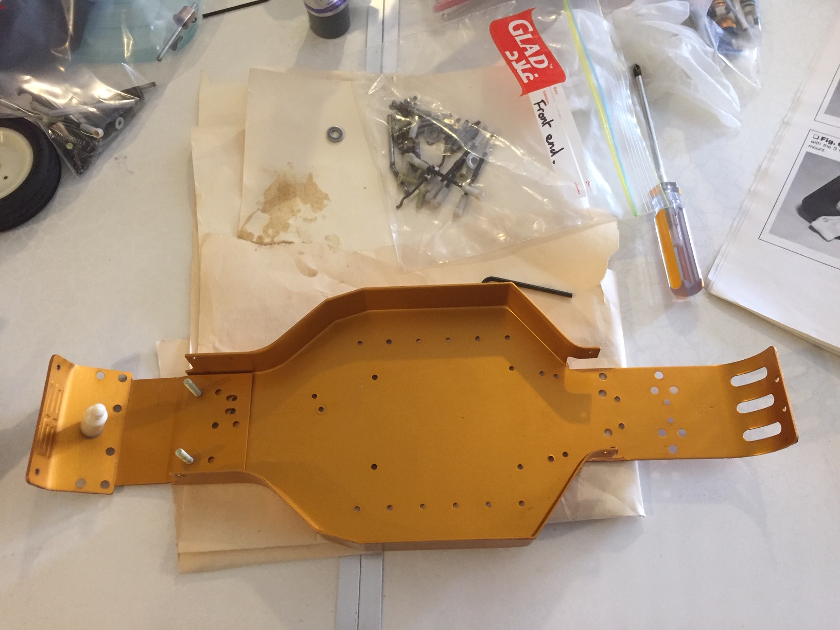

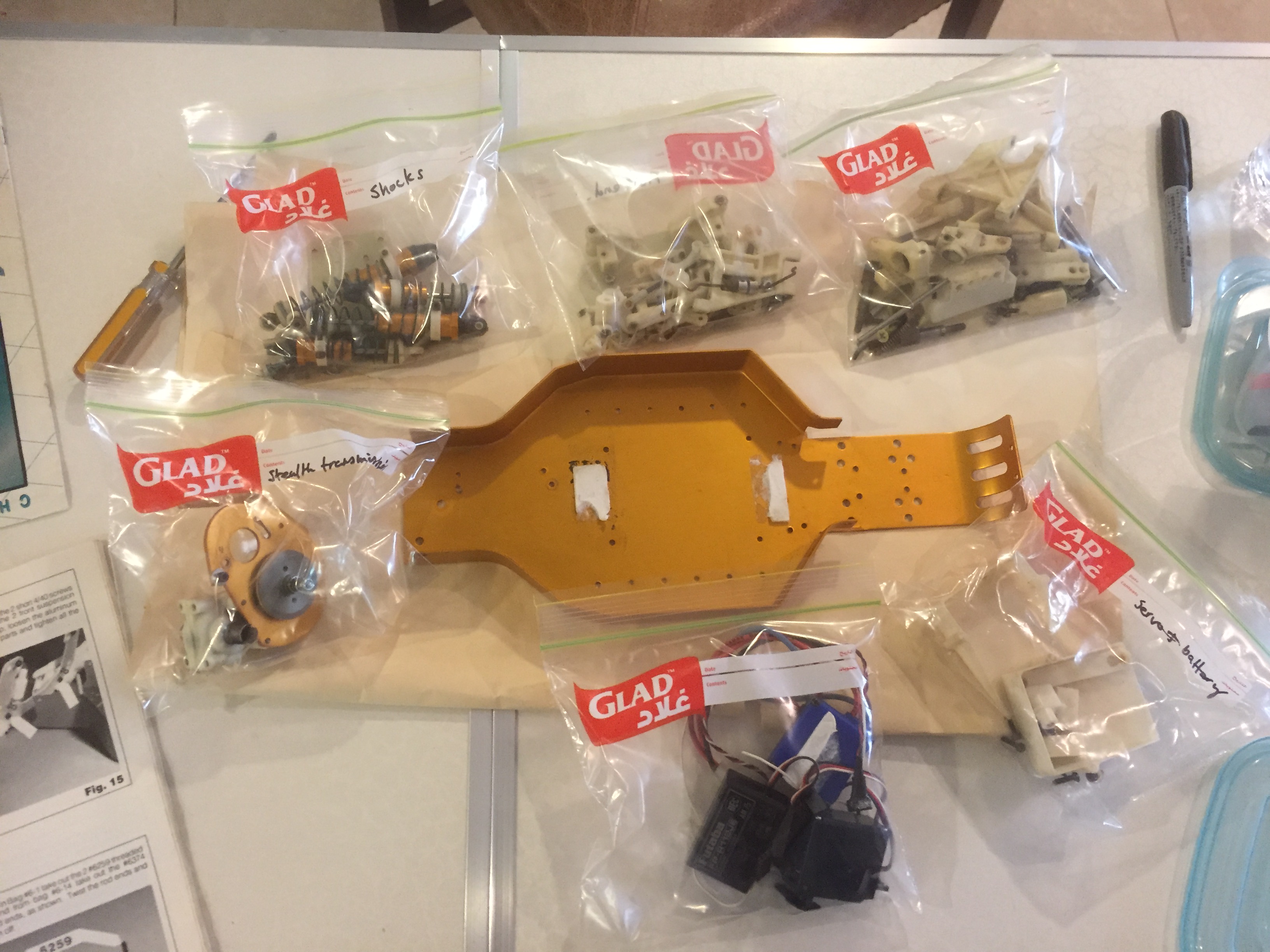

Everything stripped off and ready to start cleaning. I’ve found some simple green and goo off as per recs I’ve read here.
Posts: 16810
If this is a car you plan on using, I would replace all of the bushings with bearings.

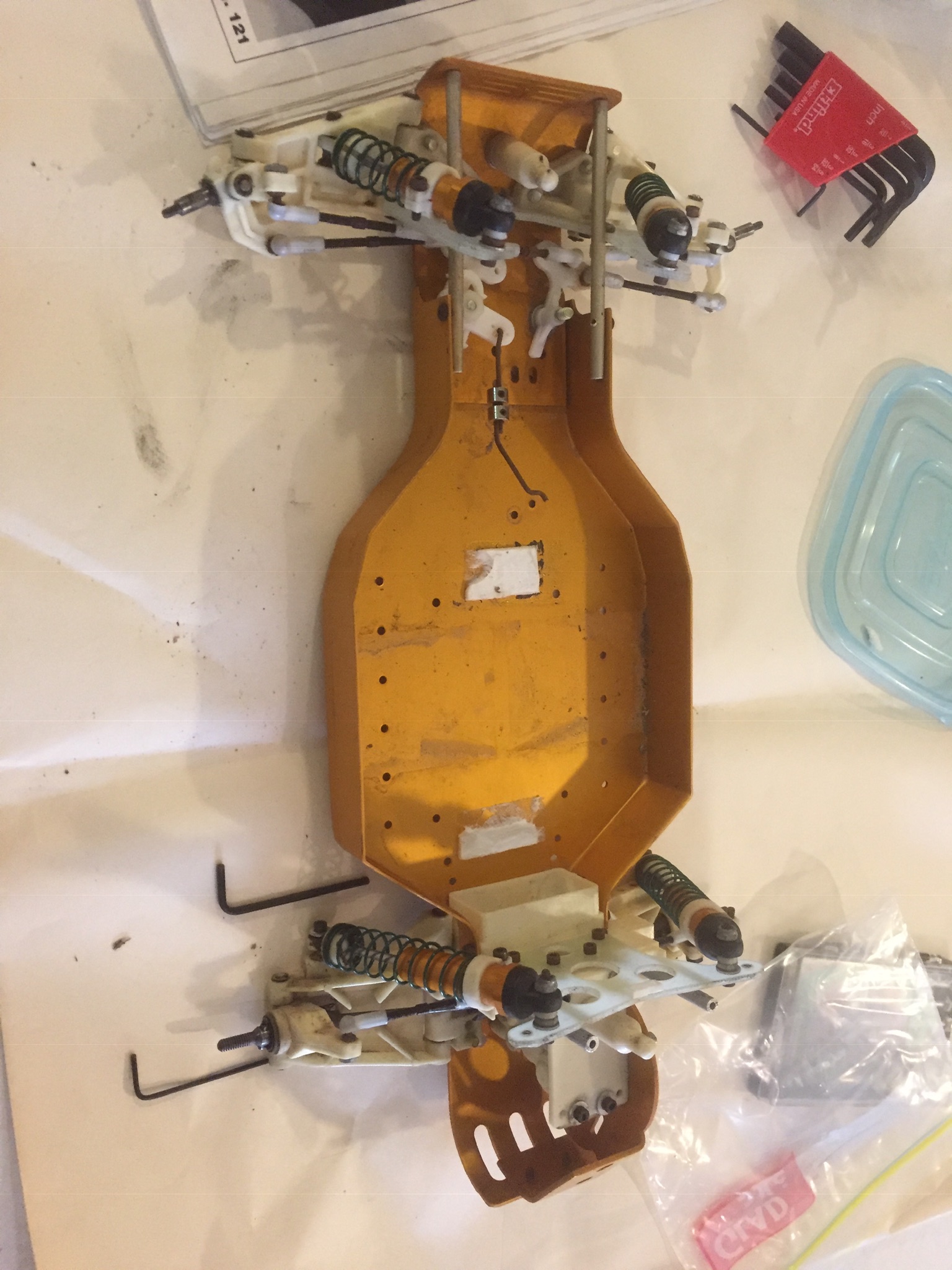

I've got the chassis cleaned up pretty well. I used Goo Off to get rid of the residue from tape. The bottom is a little scratched up. I might look into getting it re-anodised, but I want to run this so probably not worth it.

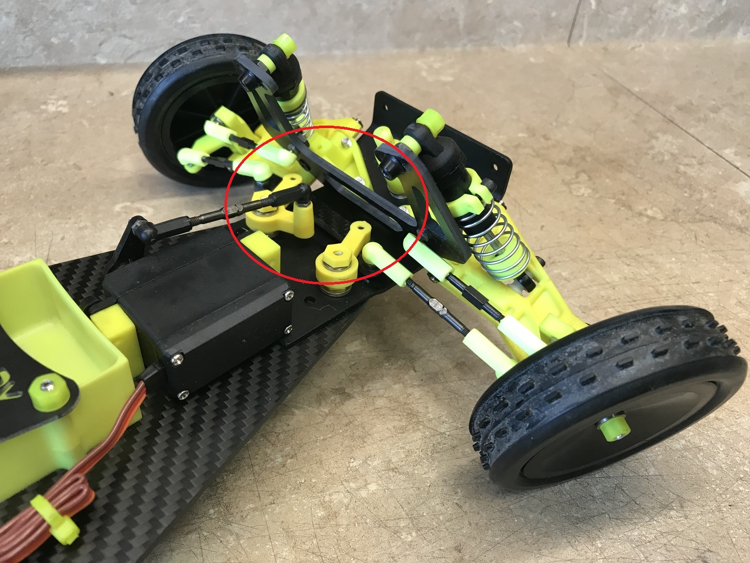

1) I've lost the nylon nut on the steering mechanism - I couldn't find replacements for this. Suggestions for alternatives?
2) I've seen steering upgrades on here but couldn't find one on Amain hobbies. Both arms on the steering mechanism are cracked where they connect over the screws that come up through the chassis.
NomadRacer
Posts: 1467
Has thanked: 81 times
Been thanked: 79 times
Post by NomadRacer »

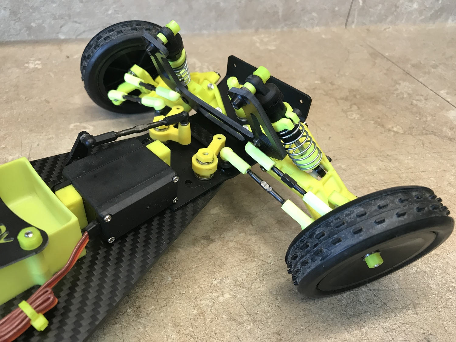

Factory Works, (GoMachV on this forum) can fix you up with a steering kit that will give you everything you need to fix your missing nut and cracked steering parts.

Yes, if you are interested in an era correct upgrade just let me know. Otherwise sourcing parts from the rere rc10 classic shouldn’t be bad, but parts are drying up a bit

Yes, so what would an era correct upgrade look like?

The upgrade from Factory Works consist of a bellcrank set, crossmember (replaces the short turnbuckle), Some screws and washers, steering posts, and instructions. I have this steering kit on multiple RC10's myself.
