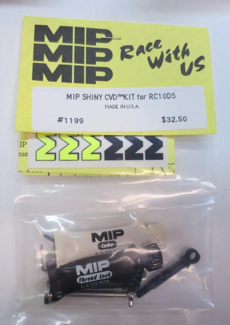

IM SOO JEALOUS OF THE CVDS.WOULD YOU BY ANY CHANCE HAVE THE CVD PART NUMBER SO I CAN EMAIL OR WHOEVER MAKES THEM IF THEY HAVE THEM. MY SOLUTION IS OK FOR SHELF QUEENS NOT FOR WHAT IM GONNA DO. IM GONNA RUN JACO BIG FOAMS ON THE BACK AND SEE HOW THE CAR DOES IN DRAG AGAINST THESE NEWER CARS.

Wish I could help brother it came with the car. I’m sure someone here should know the part number for those shiny cvd’s.

Mip DS cvd’s p/n 1199
Not mine
Factory Works website
