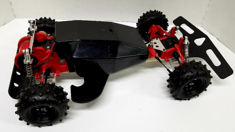

Cool resto. I had no idea what that was and had to Google it...you might want to update your title with Hirobo Rock'n City or something.

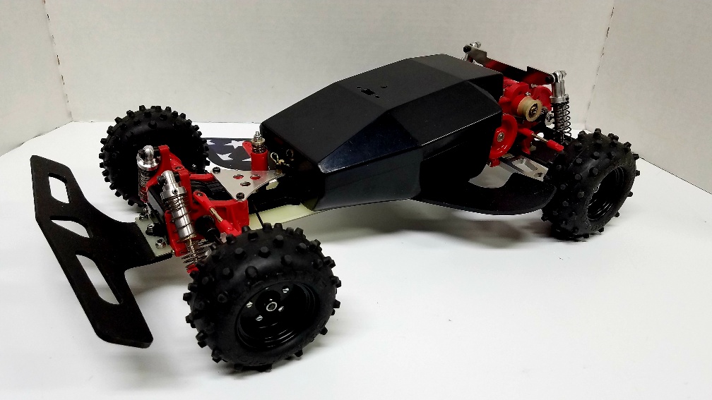

Very nice indeed , what body are you going to fit , the rockn city , rockn veyga or the truck body ? , my vote would be the city ! But the Veyga is pretty chunky looking( in a good way) as well . I've never seen those race prep arms before so they must be like hens teeth !
Is it going to be run or displayed ? I'm guessing she's going on a shelf but if you decide to run her I'd refit the stock arms , the arm mounts on the transmition case at the front often shear off in an impact and with stiffer arms its a greater risk .

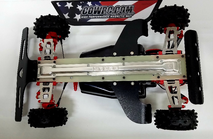

Hi, I just acquired a rockn city in a sorry state. The chassis plate and belt cover are bent in a 'nose up' position and I think they should be straight and flat. Is your base plate straight?

Hmm, 44b seems to have been the core chassis for several hirobo models; City, Vega and so on (according to wikipedia etc.) with a few variations in materials, ie a mild steel chassis plate on my 'City' but fibre glass alternatives for other models or later productions. the mild steel bends easily as does the aluminium belt cover. There's potential for some reinforcing bars to be fitted or even cut a new chassis plate from something stronger.
