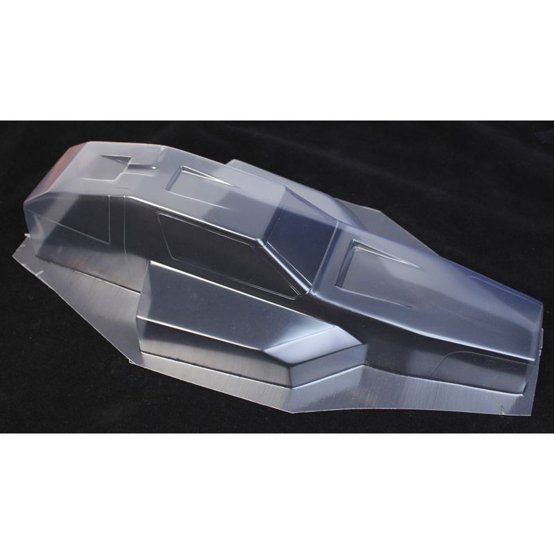

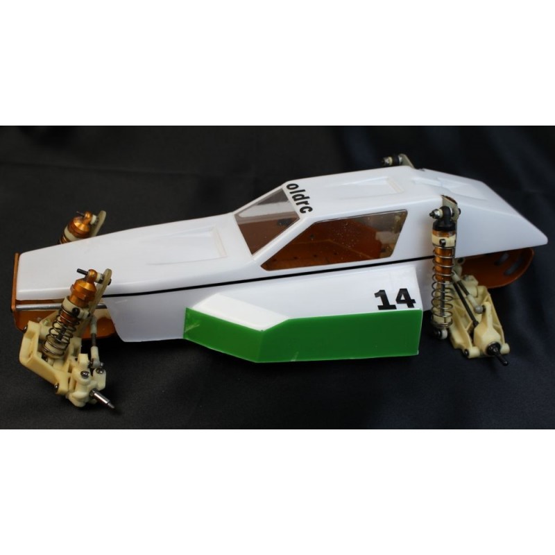

If fitting a new reproduction original style Protech body is what you're after, Andy's (painted) and Penguin on ebay are your only choices at the moment. If you're open to fitting something else, take a look at Team Blue Groove on ebay or OldRC.com (aka Sabula Tech). Both of these guys make great products but I've become a big fan of Sabula. His Turbo Mirage and Mirage SS bodies are out of stock at the moment but he does have the Jammin repro body in stock. https://sabulatech.com/storefront/index.php?id_product=5048&controller=product
