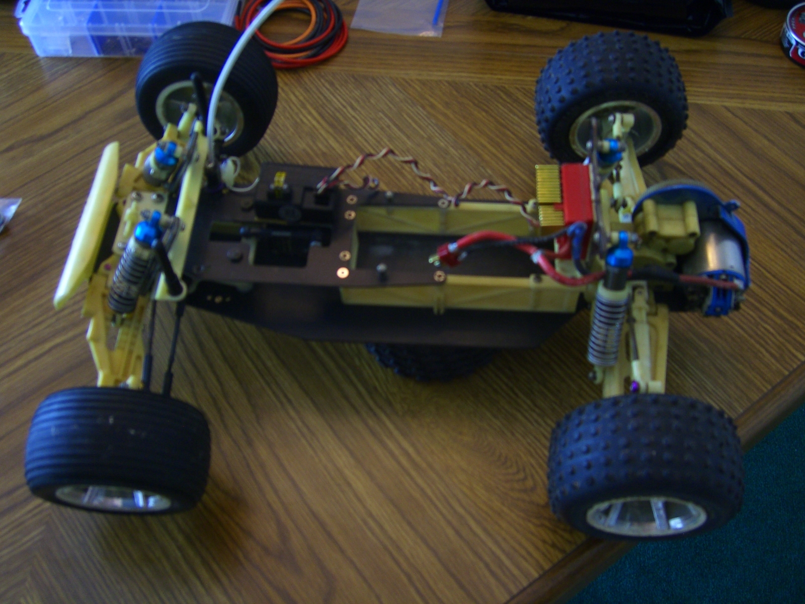

this old truck has been passed between me, my brother, and son since new all 3 of us have 'tried' to race it at one point or another but i'd like to freshen it and hit a local track beginner class with it just for fun .. so the questions -- will a rustler/stampede tranny bolt on without modifying the chassis, will the guts out of the ls2 tranny fit in the stampede tranny, and will stampede lower front arms work on the stock front bulkhead? any help is appreciated, theres some aluminum parts i want to put on it to race .. after i debut at the new track with it i'll likely restore it, but i want to run it for nostalgias sake ..

Pretty sure the Rustler trans innards are the same. Not sure on the other stuff. You could try some RPM Nitro Rustler front arms in the front. You would need to use some spacers on the inboard mounts. The LSII bulkhead is narrower. If the Stampede uses the same front bulkhead as the Rustler, then same issue there with the inboard width thing. Unfortunately, those 1931 front arms are hard to come by. I wouldn't take it to the track with those white front arms. Hook a pipe and it's running over parts time. You could head over to the Traxxas website and cross reference some legacy parts lists and exploded views and get an idea of parts compatibility. Sweet truck BTW.

ok heres what i found out by just pulling the trigger in the dark on a few things, for future reference anybody else wondering - traxxas slash rear arms are about direct replacement for ls2 arms, the new style trannies with the built in or detachable mounts for stampede slash etc, place the mounting holes in the mounts directly in the same location on the old ls2 chassis, but the front of the trans doesnt hook in the shock tower like the old style, instead theres two threaded holes up front and a brace could be fabricated easily out of aluminum etc to attach it without any mods .. so the new trannies will bolt up 100% with no chassis mods ... the difference is the suspension mounts move the arms outward 1/4" or so ... this will require different links is the main issue, most drive axles should accomodate that difference imo ... the front arms as mentioned above, for the 'slash' place the positions of everything very close to original but are slightly wider overall, and will require spacers in the inner mount, maybe on the links and shock mount depending , and longer links probably ... so modernizing with a bullet proof rear end and arms is dooable without modifying the original chassis thats the main thing .. gotta thank traxxas for keeping things compatible, one of their few saving graces imo lol, never thought too highly of traxxas ...

.. this is what its come to :wink: .. what i decided to do is keep it all original and restore that one, all i need is white front axle carriers and i have everything to be 100% correct ... and i bought a large sheet of 3mil carbon fiber to 'copy' the chassis, stretch it maybe an inch, i like the ls2 double deck chassis design more than the new style slash/rustler designs .. and create a one off take no prisoners franken-truck with a re-engineered front geometry and steering, more antisquat in the back, and a pro modified brushless setup ... thats the plan man 8) ...
