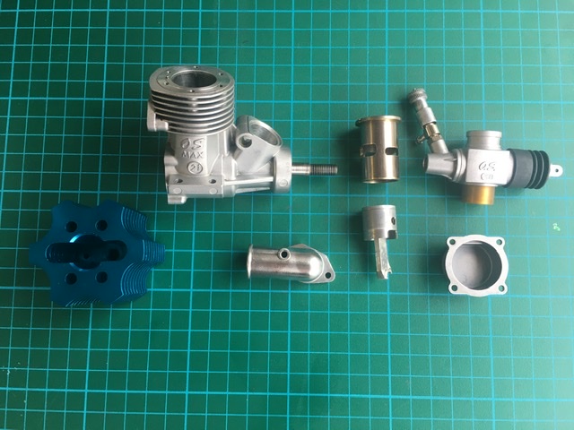

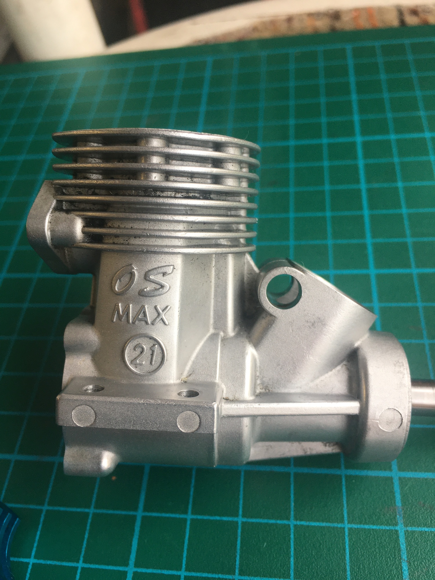

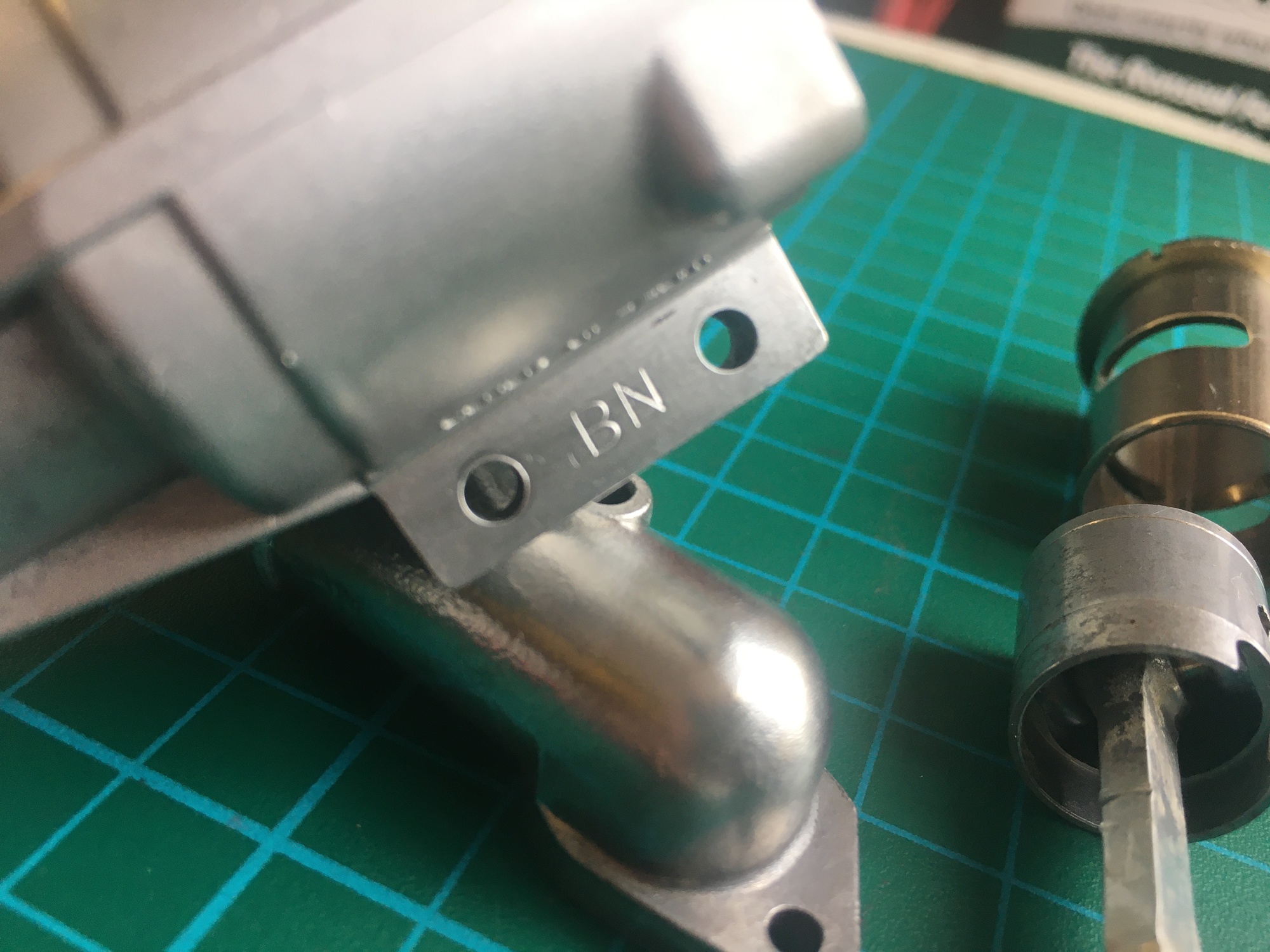

Ok, here’s a few pictures of the engine.
I’ve cleaned the bits up with fine wire wool.
The liner was very tight in the engine body. I had to use some wet and dry paper to clean up the aluminium bore housing for the liner to then fit in. Goes in nicely now. There doesn’t seem to be any other damage other than the broken connecting rod. Bad news is the piston and liner seem pretty worn, you can push the piston up to the top of the liner easily. I would like to fit a connecting rod, just so the engine is complete. It’s just sitting on a shelf, so the poor compression won’t matter.
I’m in the UK so I’ll keep an eye out for sale over here.

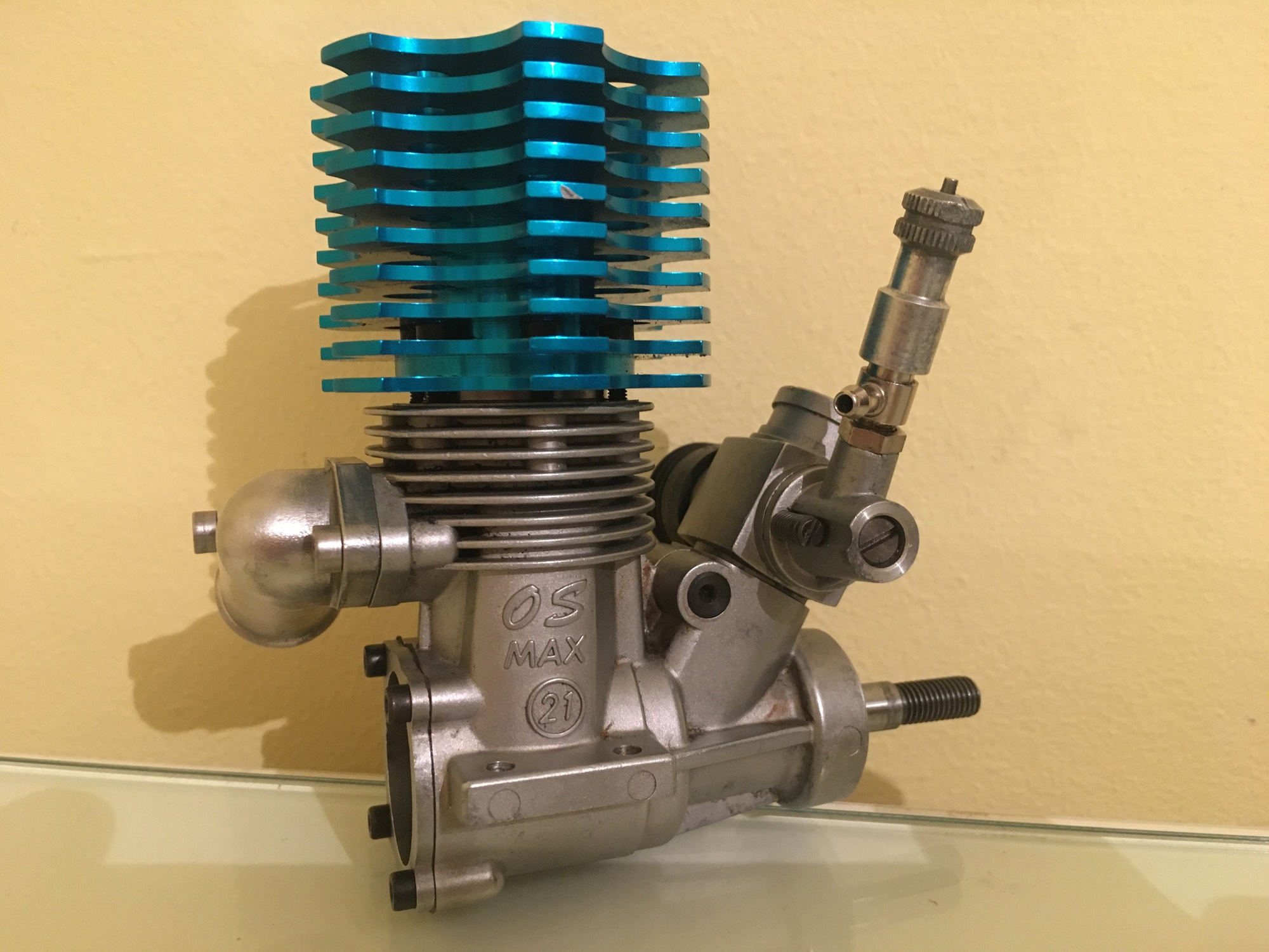

Well I thought I would share with everyone the final demise of this beloved engine.
After carefully restoring it to it’s former glory, new bearings front and rear, new connecting rod, piston sleeve re-sized and assembled.
Please see the picture below.
Listed and sold within a couple of days on eBay to a chap in the States, everyone is happy, until an hour ago.
I received an email telling me the item couldn’t be shipped through ebays global shipping program for certain restrictions in place or because the item was prohibited.
I keep the money for selling it, and the buyer will receive a full refund.
So, the question is, what now happens to the engine, I shouldn’t really care, but I do, it’s just a waste.
Anyone got any thoughts?
