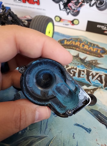

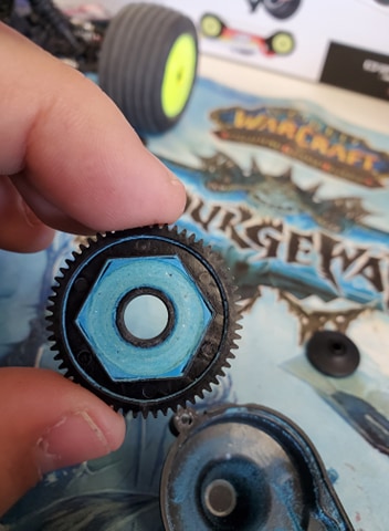

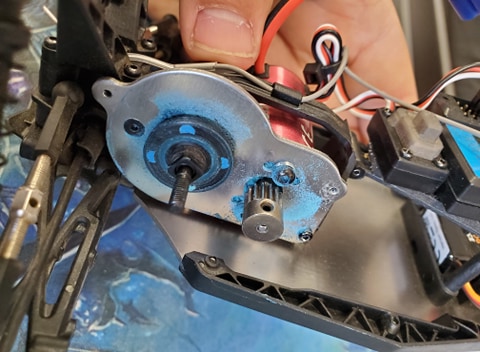

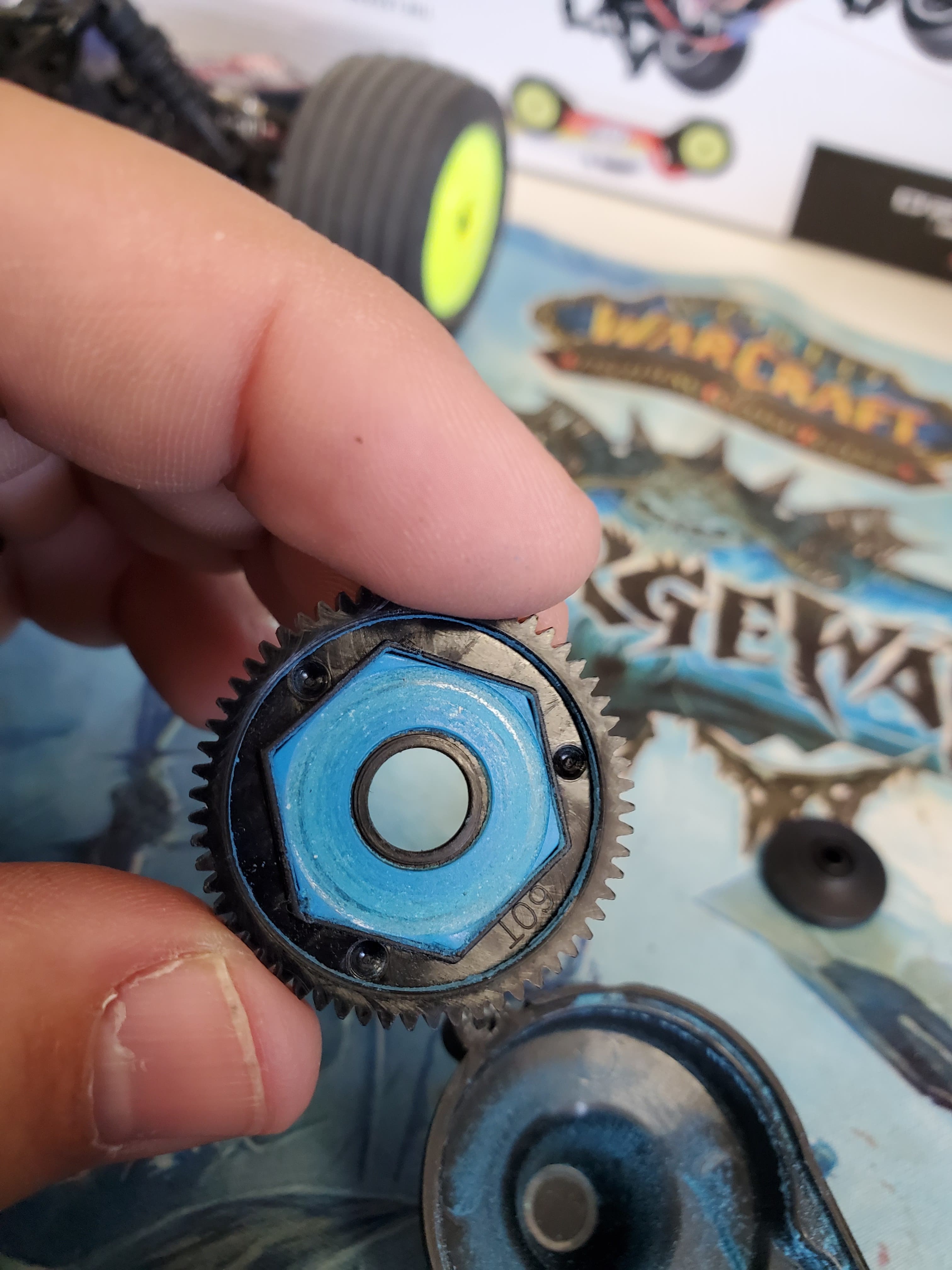

Hello! First time poster here. I co own a hobby shop and we've just started selling and fixing r.c. stuff. I had a customer buy a brand new mini t brushless, and after the first run his back left tire stopped turning and the back right tire turned at about half speed. Upon opening it up, I found blue powder all over the inside where the spur gear and pinion are housed. My questions are these: how does this happen, how do I avoid it next time, has anyone experienced this as a defect, and is it as simple as replacing the slipper pads to fix it?

That said, if one wheel is froze up and the other barely turning, the slipper disc was the result but not the cause. Need to determine what locked up the one side first. A bearing went bad, something caught in it etc. That locking up is what would have lead to the pad getting wore down.

I have attached the photos. Since posting it seems that the housing is enclosed versus what the replacement packaging says. This is the replacement part http://www.losi.com/Products/Features.aspx?ProdID=LOS211016 part number LOS211016. The stock housing doesn't have the hole on the end so it doesn't need the plug. I wonder though if the slipper pads would have survived the first run if that piece was included? I bought a replacement, no plug. *shrug*. I have no replaced the slipper pad and spur gear (they come as a package so why not) and we'll see.

I think I've widdled down the issues to one thing: the differential inside has too much play. The gears get kinda loose making 1 tire spin at full speed and the other only partially. I've been recommended to regrease? I don't see that will help but at this point, I think about how I can't fix this everyday and it's starting to make me sad inside my heart =p
