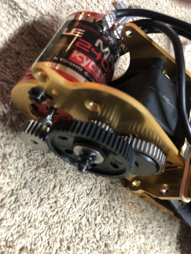

When I roll it back & forth by hand, the belt moves & the gears seem to go in the right direction..but it sounds like the spur gear is getting knocked loose under any power...seems like the gear cover/body clip is all that's holding it in place, which doesn't feel like the same way it was done way back when...though I only had an Ultima Pro and a Turbo Mid SE, which both had ball diffs, so this is a bit different. Before I tear the whole transmission apart, wanted to see if anyone had any theories...I'll retain some dignity in the fact that I haven't built one of these in 30 years and got this far without help...

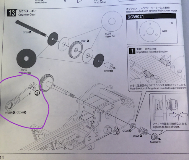

OK, I'm losing my patience here! I pulled off the counter gear shaft & everything moves very smoothly without the Spur & pinion attached. Nothing appears out of place. I can get it to drive forward a few feet before the gears lose contact. Reverse never works. I don't think I need to tear apart the belt drive or any of the other gears & the problem is somewhere in this slipper clutch & spur.
Video Clips Here
One thing that I'm not clear on - what is that wrench for in this step? The box wrench tightens that outer nut no problem ..
Video Clips Here

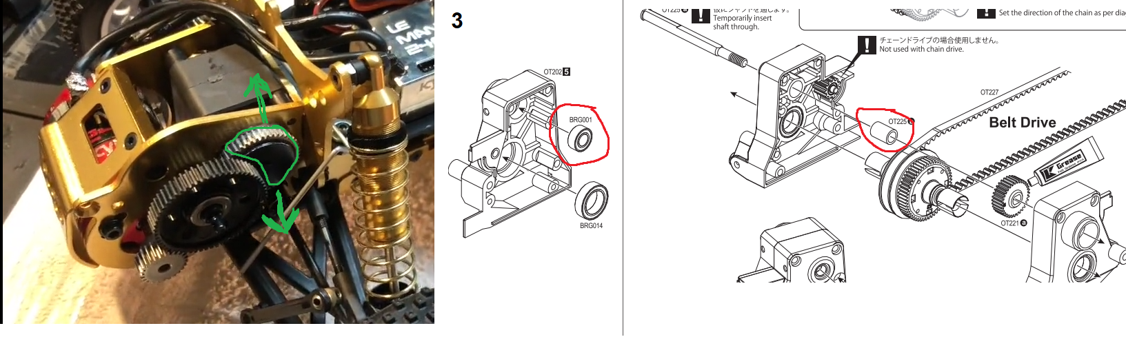

Re: Turbo Optima Re-Re Transmission
Watching that video, I can see the entire slipper gear and shaft lift up when it's grinding. I outlined it in green with arrows in this picture. Are you sure you installed the ball bearing on that side of the gearbox housing in step 3? And the spacer in step 4? Without the spacer, the ball bearing will slide out of the housing and allow the whole slipper shaft assembly to wobble up and down.
Unfortunately, I think this might be the problem. I'll find out for sure exactly what's missing or incorrect, but ... I don't remember having to pretty much tear apart the entire car to troubleshoot the tranny! Now I am having trouble even getting the thing apart and am really discouraged. I don't know how I'm ever going to get these 2 screws out ... or really how does anyone secure 2 spots while turning the driver. There were a few spots during this build where it felt like I'd never be able to proceed without a 3rd hand or really tiny fingers...Champ85 wrote: ↑Thu Nov 19, 2020 11:15 pm Watching that video, I can see the entire slipper gear and shaft lift up when it's grinding. I outlined it in green with arrows in this picture. Are you sure you installed the ball bearing on that side of the gearbox housing in step 3? And the spacer in step 4? Without the spacer, the ball bearing will slide out of the housing and allow the whole slipper shaft assembly to wobble up and down.

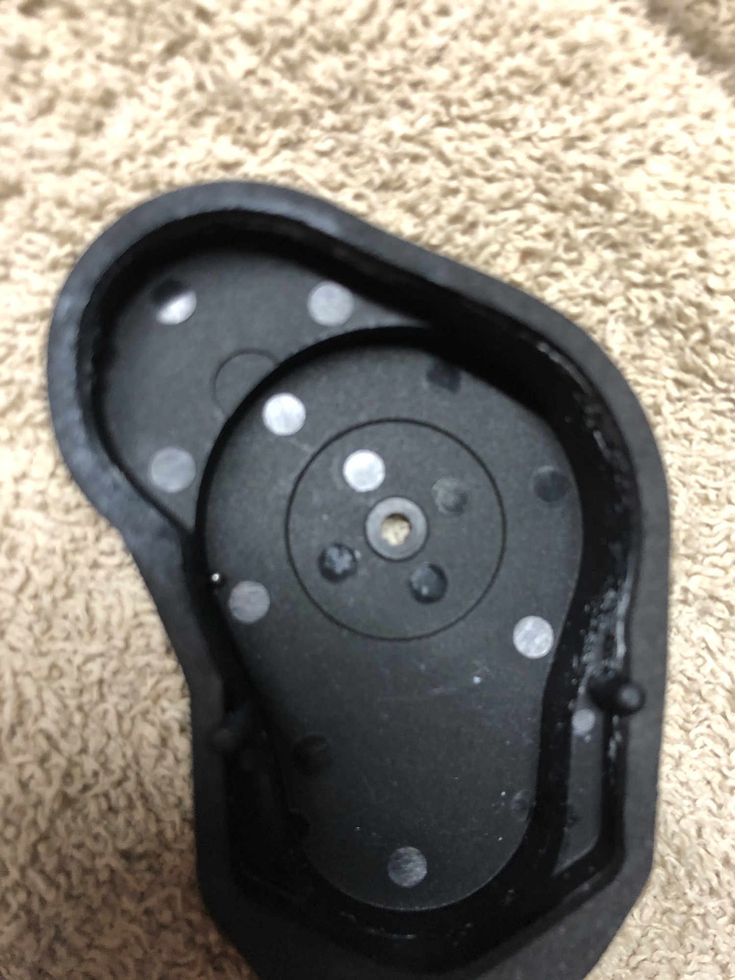

SOS... I don't know where to go from here. The counter gear shaft seems to have too much play, until I tighten the nut on the spring on the other side...Then it's nice & tight, but the then counter gear doesn't mesh well enough with the spur to make the go-go.
I also found a teeny aluminum ball in my gear cover...should this worry me? No idea where that could have come from.-

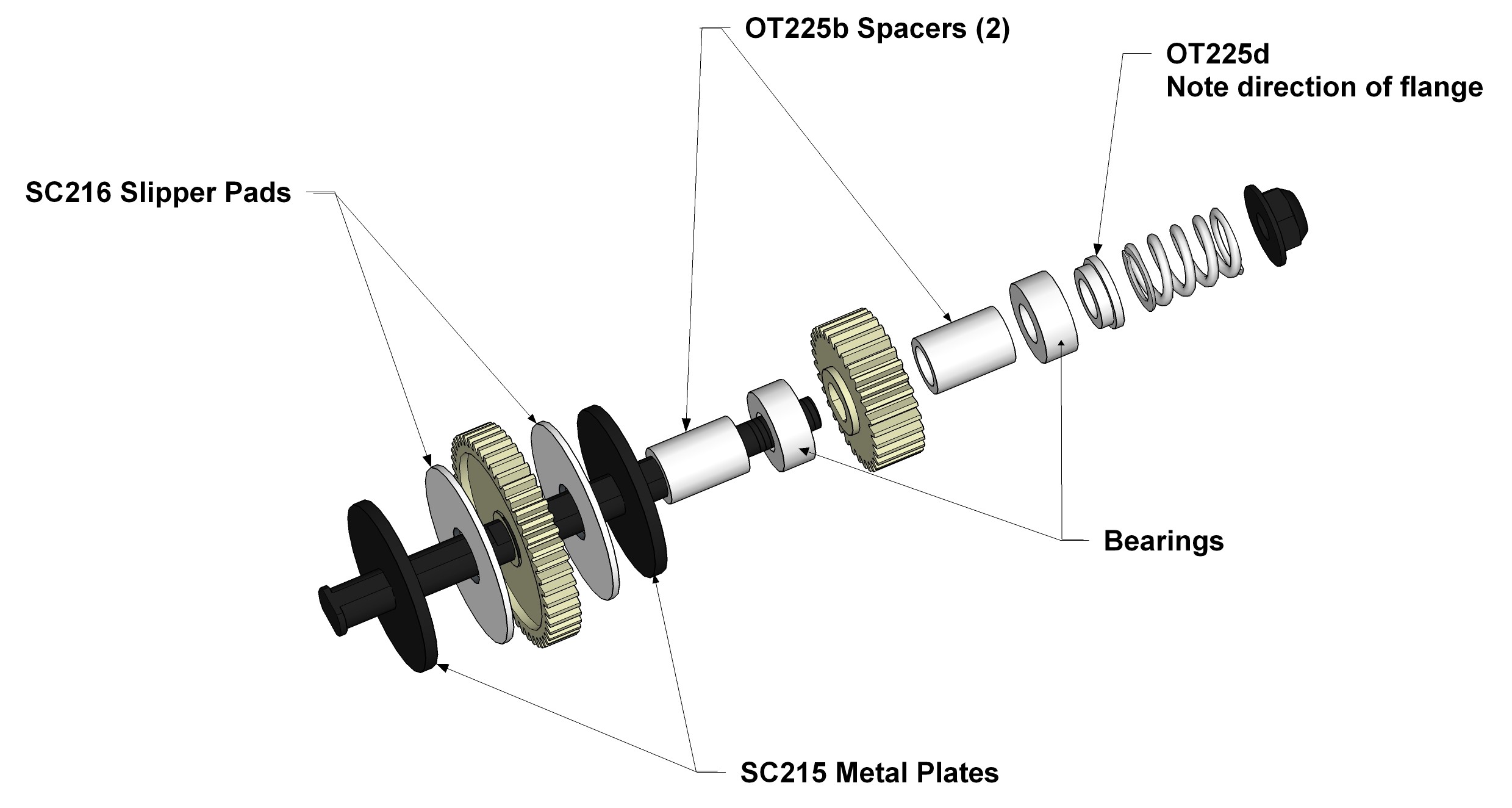

This is a complex slipper assembly so maybe it will help to look at an exploded view.
