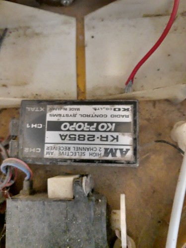

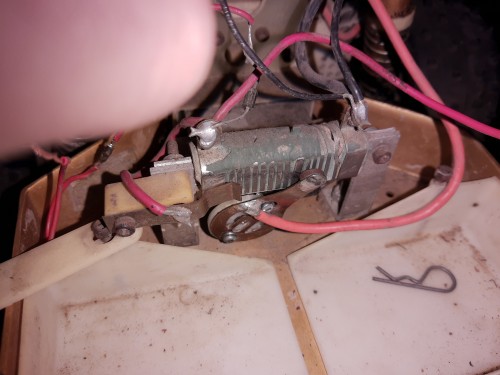

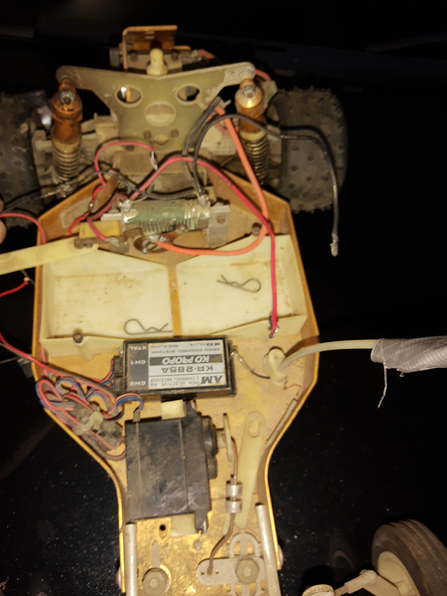

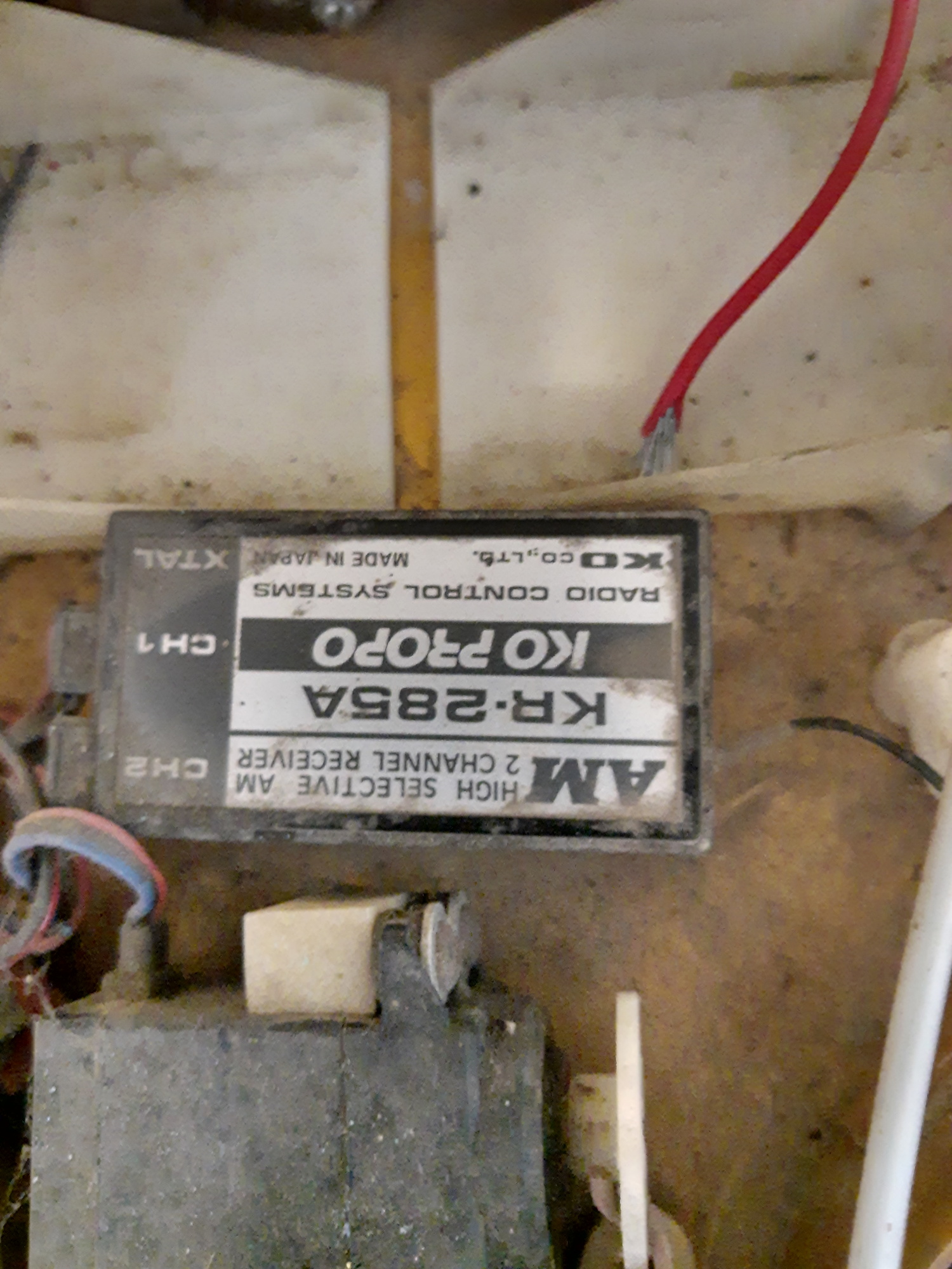

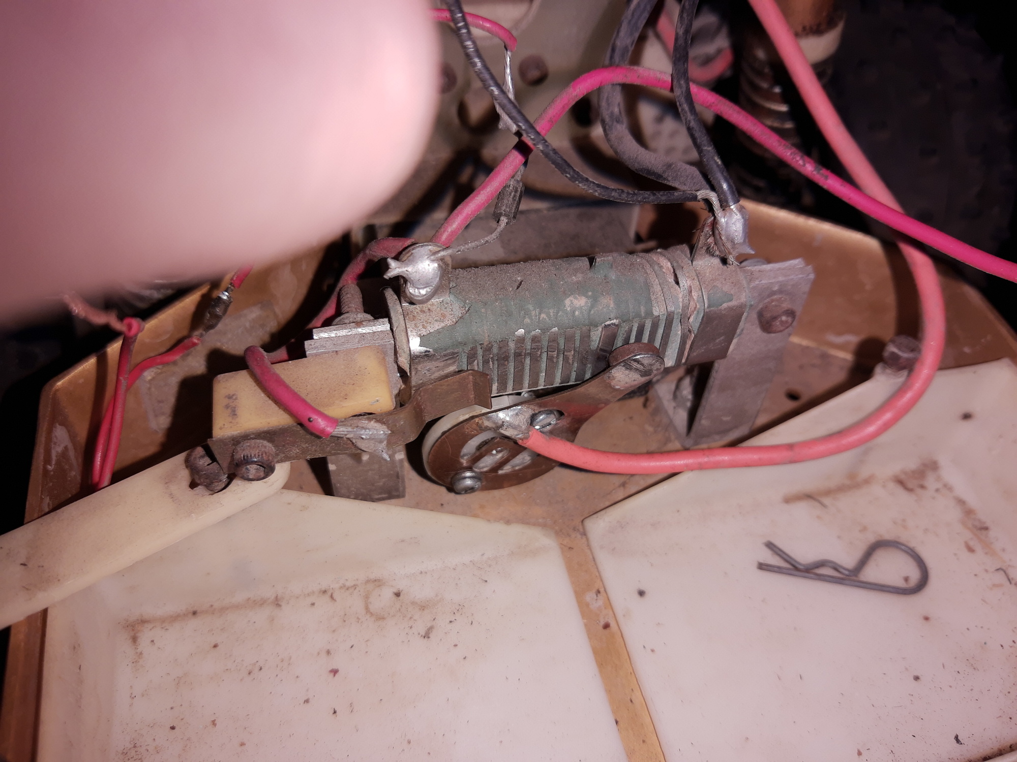

Hey everyone thanks for the add. Kinda new to the rc world. My 7 yo son found a old rc at his grandpa's. Mostly intact. Battery will for sure need replaced. Just wanted a little help figuring out exactly what he has. He is very interested in fixing it up some. Just wondering what would be the best direction to go and what to look for on what needs replaced. I was able to connect an old battery to it and it will go and will steer.

IMO I’d throw a budget 2.4 radio in there, a cheap ESC and get a couple budget NiMH batteries. Keep it moderately slow and controllable. Add a body and let him go have fun. It’s an old car and parts will break. Not as cheap and easy to fix as a modern car so there’s that to be aware of.

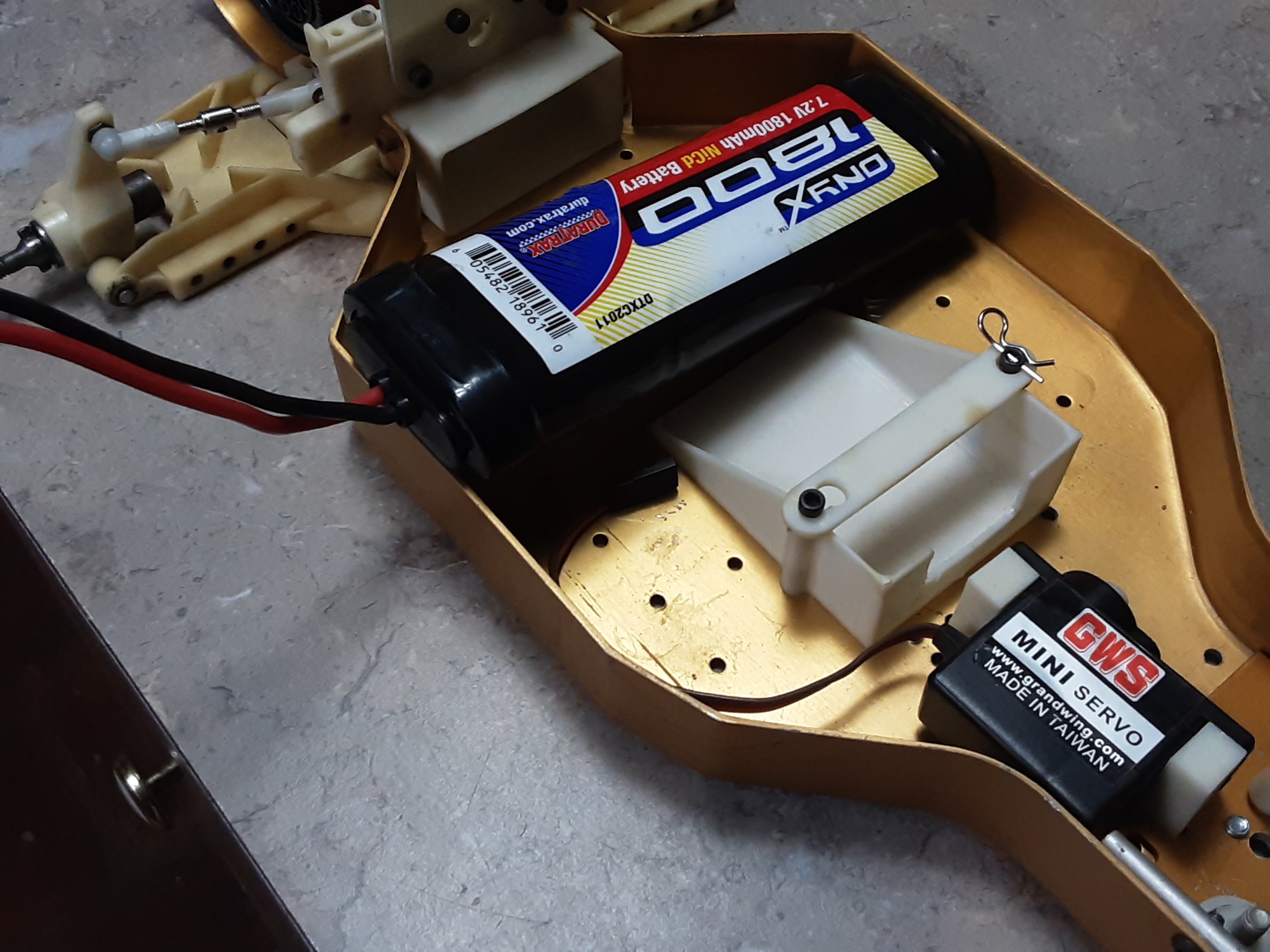

Modern NIMH batteries won't fit the transverse mounts. A short lipo can be used but you will need a aftermarket buzzer to serve in place of the cutoff.
"A" stamp chassis don't have the correct holes for using in-line mounted packs. You can find 3D printed mounts that allows in-line mounting without drilling new holes.
The first thing that I would do is disassemble and clean everything, and determine what needs to be rebuilt or replaced.

Even if the electronics work, the servo gears are likely brittle by now. IIRC, old KO radio equipment used non-standard pin layouts. While you can work around it, you will have to be mindful of it. Wire it wrong, and the servo is toast.

Modern stick packs will not fit transverse in a RC10 chassis. In this picture, it doesn't even fit without the mounting cups.
You might be able to remove the caps and reconfigure the wire attachments, but that's probably going a little out of the way.
If you want to use modern stick packs, convert to in-line mounting. It will require an esc.
