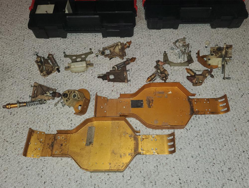

I picked up and refreshed a T4 this week, and while doing so, my gold pan kept eyeing me from across the room wondering why I have never given it any love. It truly got to me, so now it is time to show it some! It has only been sitting around for twenty years. :roll: I don't have a good before pic; got too excited and just started taking things apart!
Good news is I actually have 2 90%+ rough condition cars to start with. I will take the best from each and make one decent car. Not looking to show car this thing, but not a basher, more of a driver. I want to be 14 again, and run an RC10 in the dirt as fast and I can and not care too much about breaking it!
Basic plan going into this is clean everything, whiten what can be whitened, lube what needs lube, rebuild shocks, get new tires and body, and follow any tips and tricks anyone wants to hand out. I didn't really want to do a full teardown, but with the whitening, I may have to do that.
First question, tires. Is there a source for new 1.5" (1.6"?) tires? I can find NOS stuff, but figure that rubber is just as old as I have. I like the 3-piece wheels so really don't want to get away from them.

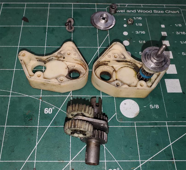

Second, transmission. Have the cleaner transmission apart, and don't see any signs of damage. Clean, lube and reassemble? Or anything I should do while in there?
Would a kit like this include bearings to replace the bushings in the trans? https://www.ebay.com/itm/FastEddy-Team-Associated-RC10-Classic-Bearing-Kit-TFE773/122580398428?epid=1041274226&hash=item1c8a5c715c:g:15cAAOSwY7he~qMv
Thanks

If one of the transmissions has black idle gears, I'd definitely use them. If not, I'd make an effort to find some,
Read around, there are some threads about upgrading the bearings on the outdrives. The larger bearings stabilize the outdrives and keep them more positively located.

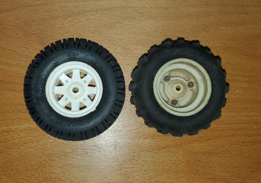

Bumming me out about the tires. I really want to use the originals. I did find a set of 3-piece wheels in my stash that I had for some scale build 100 years ago. I think I may just make these work for the rear. The diameter is actually perfect on the Sand Blaster tires, but the bead is way narrow. Will need to work on the front.

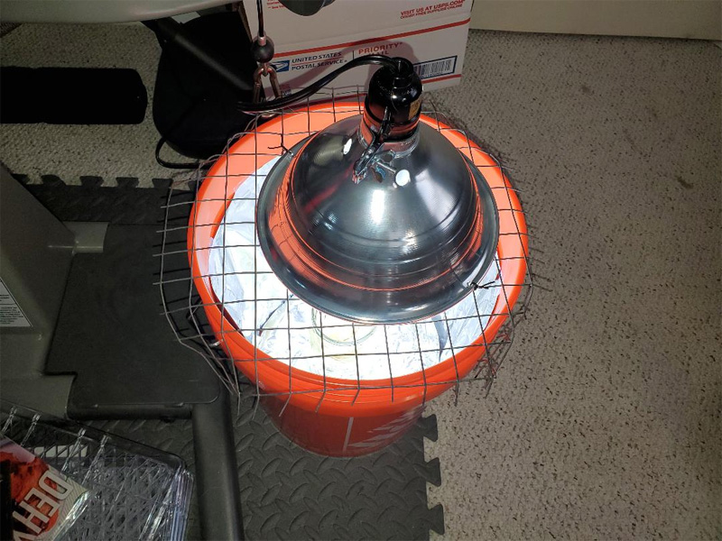

For the peroxide whitening to work, you need UV light. A UV lamp will work but most use sunlight.
morrisey0
Posts: 1732
Location: Richmond, VA
Has thanked: 77 times
Been thanked: 1762 times
Re: Refreshing a RC10 GP - Will Have Many Questions Along The Way
Post by morrisey0 »
juicedcoupe wrote: Sun Apr 04, 2021 11:32 am For the peroxide whitening to work, you need UV light. A UV lamp will work but most use sunlight.
I don't have enough patience to depend on the sun. :wink:
I have this contraption with a UVA / UVB bulb:
Posts: 3445
Has thanked: 265 times
Been thanked: 2032 times
It took them 35 years to get that way. I'm sure they'll turn back in less.
Don't forget to rehydrate the parts after whitening. Its also slow going but is better than the alternative (broken vintage parts!).

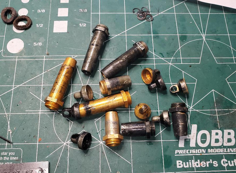

8 shocks in an ultrasonic cleaner with a mild citrus cleaner for 10 minutes apparently equals total disaster! :roll:
Posts: 3445
Lots of cleaners aren't safe for aluminum. I use Simple Green Pro HD (purple), from Home Depot.

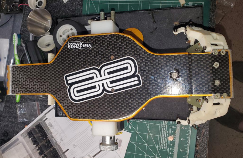

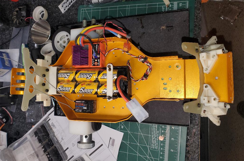

Well, USPS has decided to grace me with actually doing their job, so now I can work on things. I have been stuck at this "well, no point until I do this first" kinda phase, and all the early phases have been waiting on parts. Now it is off to the races.
How it is sitting tonight. Hope to get the trans together now that I just got bearings and can wrap up the rear. I put a bunch on hold waiting the get the chassis skin on first, but I don't like it for three reasons; 1) the maker's logo is annoying, 2) it covers everything except all the places that are actually worn on the tub, and 3) it is thick enough to grab screws as they are tightened and it "twists" around the screw. Maybe I will lube up the screw heads a little in the future. I wasn't planning on printing many parts for this build as I wanted to keep it original as possible, but I have ended up printing 1) battery hold down as the stock one was too short for my new batt, and 2) rear wing mount buttons as the only ones I had were trash. I do think I will print a light bar for across the front shock towers for some RC4WD KC hi liters in the near future.
Oh, and this thing is going brushed, NIMH, and Novak!!

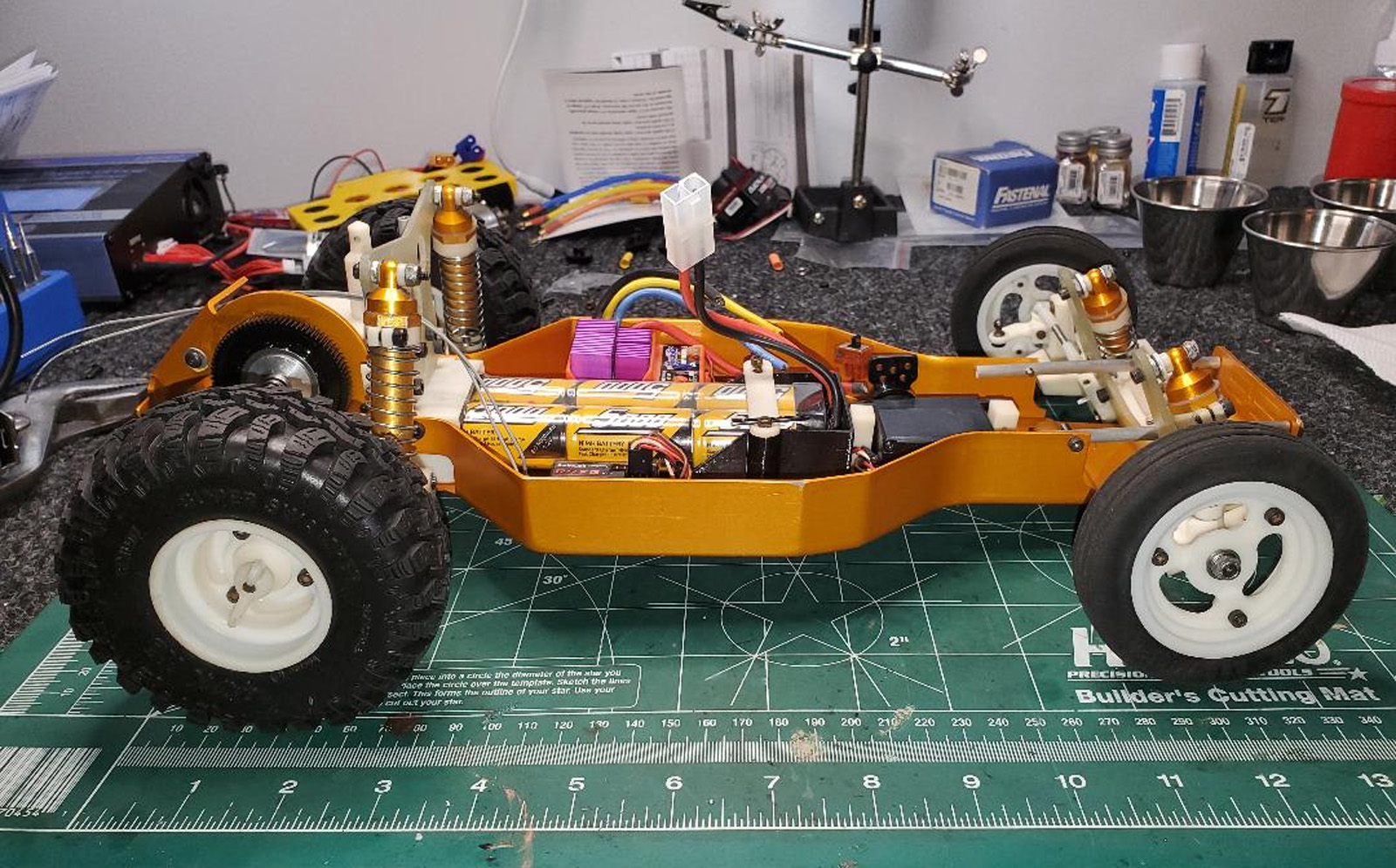

So if you owned a sail rail in real life, and your neighbor had a mild mud truck on 38" swampers, you know you would have to eventually see if they would fit. :D
